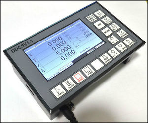

    After being looking at various controllers at the end i decided to test some of the offline ones. Started with one of the cheap ones. As you can imagine it would be great to forget about Windows if possible. So i decided to overview it "officially" here, hopefully sb could find that helpful.
    DDSCV1.1, 3 and 4 axis. / note that in the 3 axis version you can not change any axis to rotational , but the 4rth axis variant, has a rotational axis option for A/
    Mistakenly bought the 3 axis version / if sb wants that one , PM me/ . I have read the MANUAl from page one to end very carefully and apart from some small questions all looks well.
    And yes, i will connect my 2 long axis to one of the controller axis or just one of them and control the other from the servo itself . Will see about that.
    Here was the most extensive info in English i found till now
    OK. So it arrived.
    -Price paid 165$ for the 3 axis version
    -nicely packed
    -looks nice
    According to me if one knows what he is doing it could be a perfectly self sufficient control for great price. It has spindle control, probing, software limits, separate axis homing, separate axis zeroing, etc.
    Instead of writing novels, i made a video overview of it:
    Part one, ~20 min introduction, basic functions and settings
    Part 2, running program test
    Prt 3 / still to film, when i have more time will set it on my big machine, connect all and see how it moves, homes and so on in real life, otherwise all above is pointless/

    Hi, could you open the case and get a photo of the PCB, I am very interested in seeing the difference between the 4 Axis, if any. There is no problem driving two stepper drivers from one axis. The X on my router has two motors and I use two separate drivers from the X axis signals.
    here is the photo of the board:

    Thanks, thats just the picture I needed.
