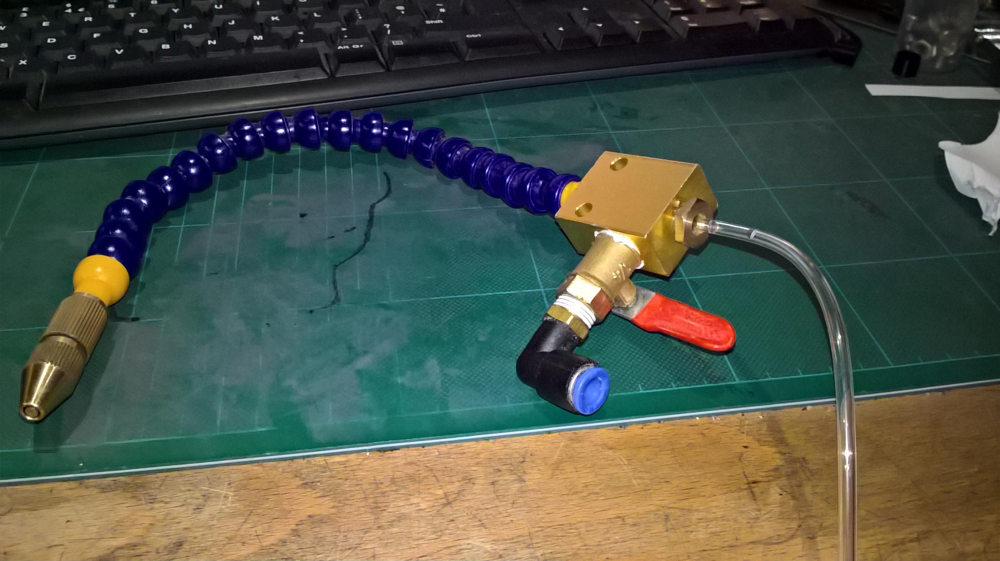

    I took an interest in the thread about mist cooling and I thought that a stepper driven pump, controlled by an Arduino, together with a solenoid operated air valve could give a system that would dispense air, liquid or a mist (with control of the liquid content) using a mister spray as in pic 4

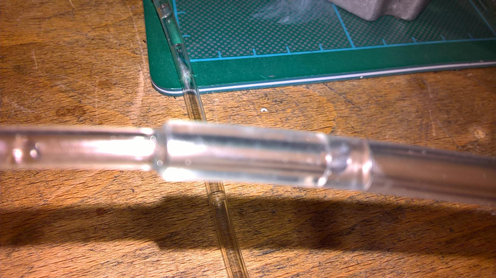

    The last picture is two tubes joined with '5secondFIX', it works well ! It cost $4.50 from China (or you can buy the JML equivalent for £9.99).

    I only intend to pump liquid with PeriPump. I can get quite a good flow at a controllable rate (which is good when you get older !), The air will be provided from the compressor and solenoid controlled, so only full pressure and pulsed, although it might need a flow restrictor.
    It is all at the playing about stage.
