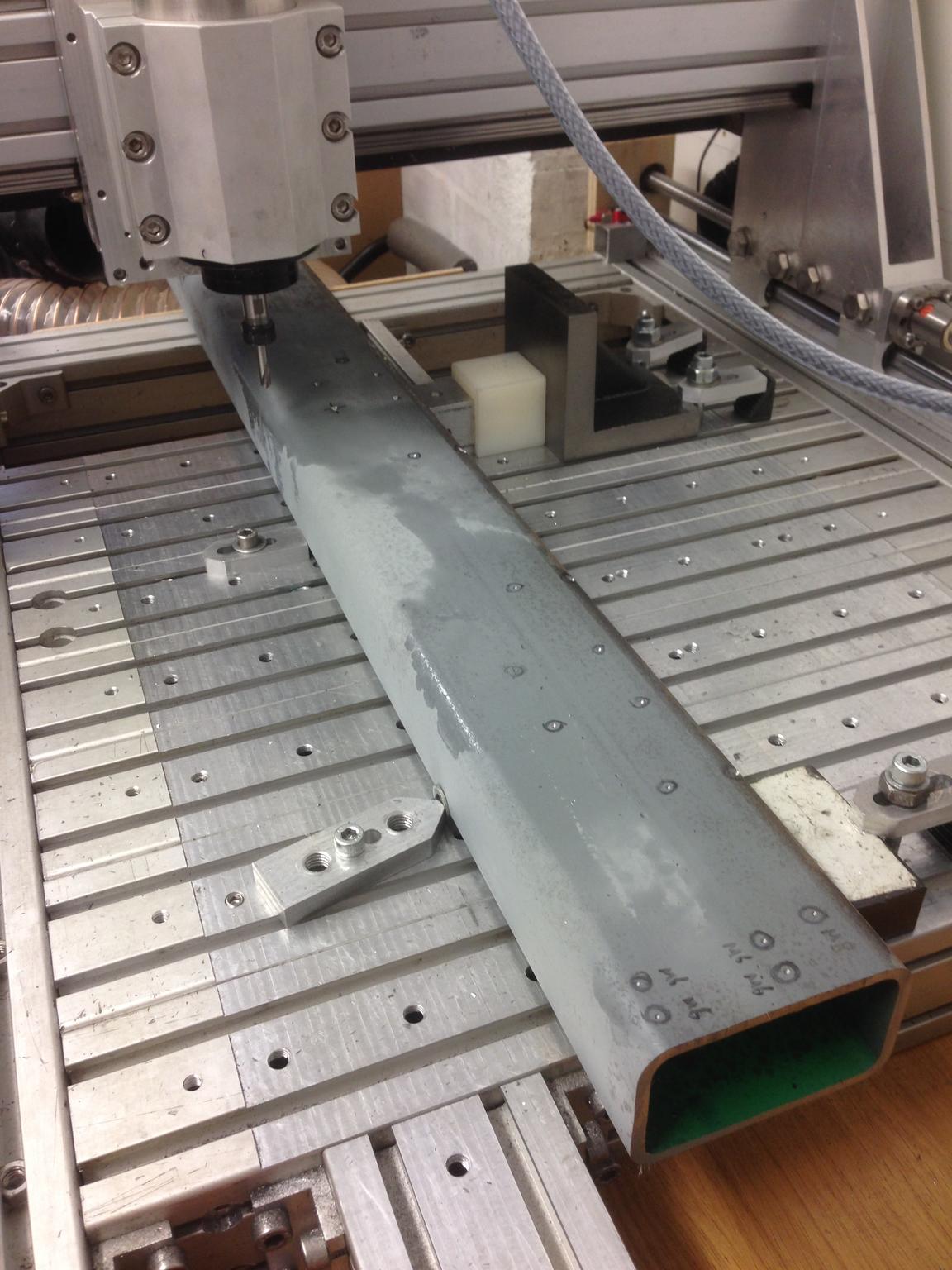

    I used my cnc machine to spot drill mark the holes:

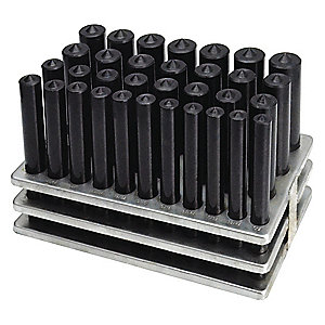

    But as yours is not ready yet you can use transfer punches to mark through the rail and into the frame (with the rail clamped in the right place and aligned parallel to the other one). Select the right diameter transfer punch which just about fits in the hole in the rail, and tap with a hammer. The pointed tip will create a centre mark on the frame below:

    I also use transfer punches as above.

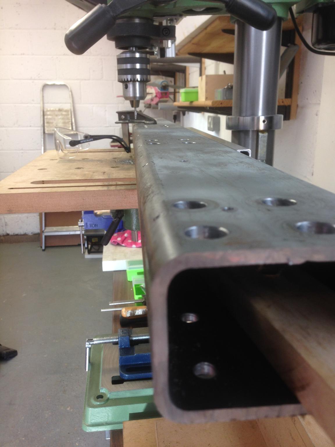

    Well I've stopped buggering about and started drilling and tapping the first (reference rail) rail. I put the two reference sides of the rails together , as suggested, and I couldn't get a 1 thou feeler gauge to even start to go between them.
    I've drilled and tapped about 7 holes so far with my set up as below and all the holes are nicely central with approx 1/2mm each side of the hole so plenty of room for any adjustment if needed.

    I've got a FERM pillar drill and I clamped it to the bed of my machine to drill the holes. I also used a DIY jig to ensure that the holes were in the middle of the rail hole.....then hand tapped the holes using another jig....
