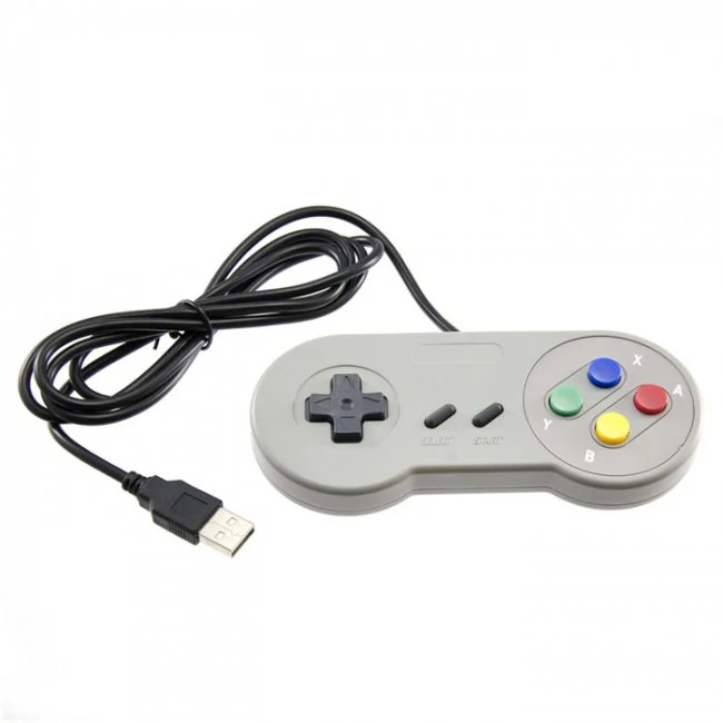

    John,
    Not sure if this would fit your requirements, but if your software has keyboard short-cut keys for all commands (as LinuxCNC does) you could use a keyboard, or a set of more robust pushbuttons driving a keyboard emulator, plus a non-touch screen to do something similar. As an example of how this trick can work I've been using one of these as a pendant for LinuxCNC for a few years now. Each button is configured to emulate a specific keyboard key to provide jogging etc.

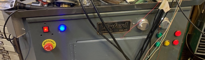

    I do have wired pendants for the mill, but am trying to get away from things that I trip over etc (I am rather clumsy). For my lathe (more relevant to your use case) I do naughty things (most Myford owners are rather over-zealously protective against dicking about with history) with the cabinet. Another flavour of integration with Linux CNC...
    It helps that the gubbins is housed in the cabinet as well.
    Apologies for the mess... the lathe is undergoing some satanic ritual at the moment.
