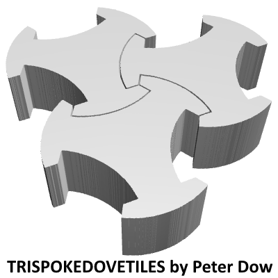

  1. For Computer-Aided Manufacturing of trispokedovetiles, I've published a Javascript web-page -
    Trispokedovetiles: CNC code to cut tiles web-page G-code generator [LINK]
    - which generates Computer Numerical Control (CNC) code which I've tested with CNC Simulator Pro [LINK] but not on a real CNC cutter as yet.
    In case you are wondering what a "trispokedovetile" is, it is the name I have given to a class of 3-spoke dovetailing tiles which fit together like this.
