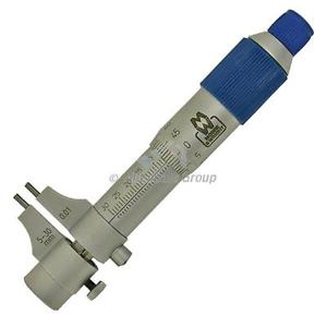

    Now that I have my lathe I am looking into tools for accurately measuring internal diameters e.g. to press fit bearings into pockets.
    I'm looking for something better than the digital calipers I have (which are not that accurate in general).
    I've seen this type used (an analogue internal micrometer) ~£60:

    This quotes a resolution of 0.01 mm but no accuracy value. Could be good enough?

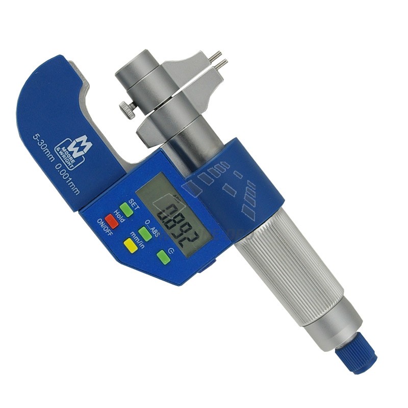

    The digital versions are pricey ~£190:
    http://www.machine-dro.co.uk/5-30mm-...80-series.html

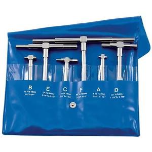

    There are telescopic bore gauges, but have never used them and there seems to be a knack to using them. How do people find these? I have an external micrometer so could mic off the gauge assuming the gauges give repeatable results:

    Telescopic gauges like the ones in the last photo are prone to inaccuracy. I personally avoid them in all but very special circumstances.

    3 point bore micrometer is the best but most expensive

    I use the internal micrometers the most, but for most work a good set of digital verniers is good enough.
    Note the word good, as some are horrendous. I had one cheap set where the internal jaws were over a mm different from the external jaws! Having a couple gauge rings soon lets you know just how accurate things are.

    Oh, and telescopic bore gauges are a skill in their self, however when you need them, they are invaluable. Short of spending a huge amount of money on lots of three point micrometers, there's no other cost effective way of measuring various diameters of deep bores.
    I've got a set, however I think I've only ever used them once in the past year, and that was to measure deep enough down a worn bore to get a starting measurement for a repair.

    The budget/entry telescopic ones are not that nice to use unless they are high end such as Mitutoyo which are much smoother

    Two point internal mics were reasonable (as per 1st photo)
    But critically, and as you mention Boyan, even with reasonable tools it comes down to the operator and the feel of the gauge when taking the measurement. This is something only experience can give - i.e. when the interference fit part just falls off under gravity you know your method needs a bit of work. I'm sure I can dial myself in as per all the other tools I've got.
    In all I'm homing in on the 2 point internal mic. Reasonable price, just one measurement to take, seen them used a bit (Youtube etc.) to make good parts. Maybe one for the Christmas list . . .

    Use the telescopic ones to get them close, an external mic to measure the scope and get them even closer...
    Then! they use there own skill to find a piston fit "pop" :)
    It's normally in the flavour of Starrett though on the scopes, so yeah they do operate nicely, I can't see that a cheaper set would give you that much of an off reading that you couldn't recover from it using your learned skill on the last op.
