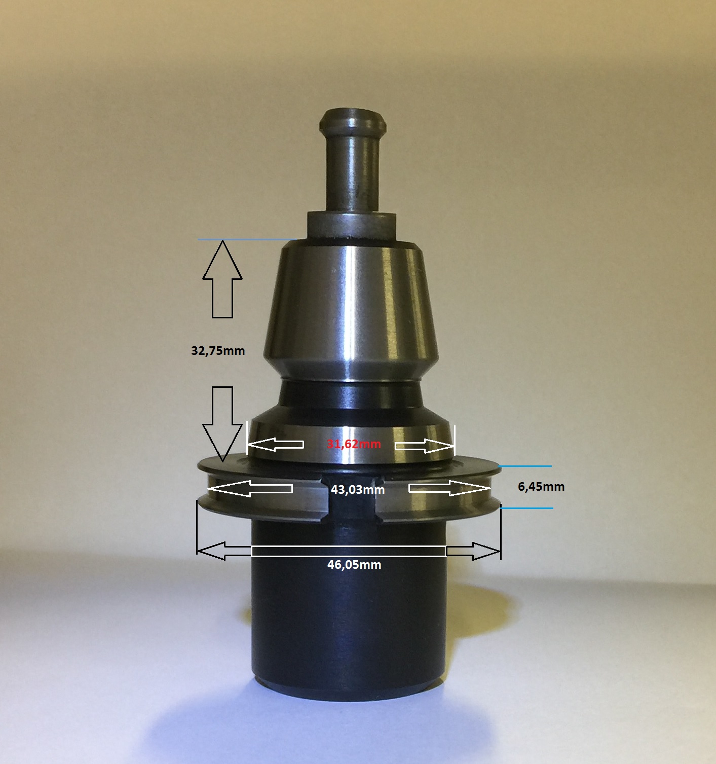

    Have you got any pictures of an existing tool holder?
    I'm not aware that Coventry ever made anything suitable for an ATC, and I'd guess the ATC uses a more standard taper. A good list of standards with dimensions can be found at http://www.tools-n-gizmos.com/specs/Tapers.html
    Don`t know if Coventry Toolholders is the correct one, but i do beleive to remember that name from another post somewhere here in the forum.
    Took a Picture of it, and measured som of the Critical parts.
    By the way i took a lokk at the link you gave me, but could not find anything even Close to it.
    Maybe my Pictures could explain better, or hopefully somebody recognizes the holder...

    Looks like a compact version of a BT30 holder, with a pretty standard pull stud on top.
    If my maths is correct, given the height on your photo, the diameter of the top would be about 22mm?
    Unfortunately that means it's most likely a custom holder, so getting more will not be straightforward.
    Yes m_c it does, but the closest i can find is the Easychange toolholder from Coventry.
    The diameter on top is 22mm, and yes i think it`s a standard pull stud.

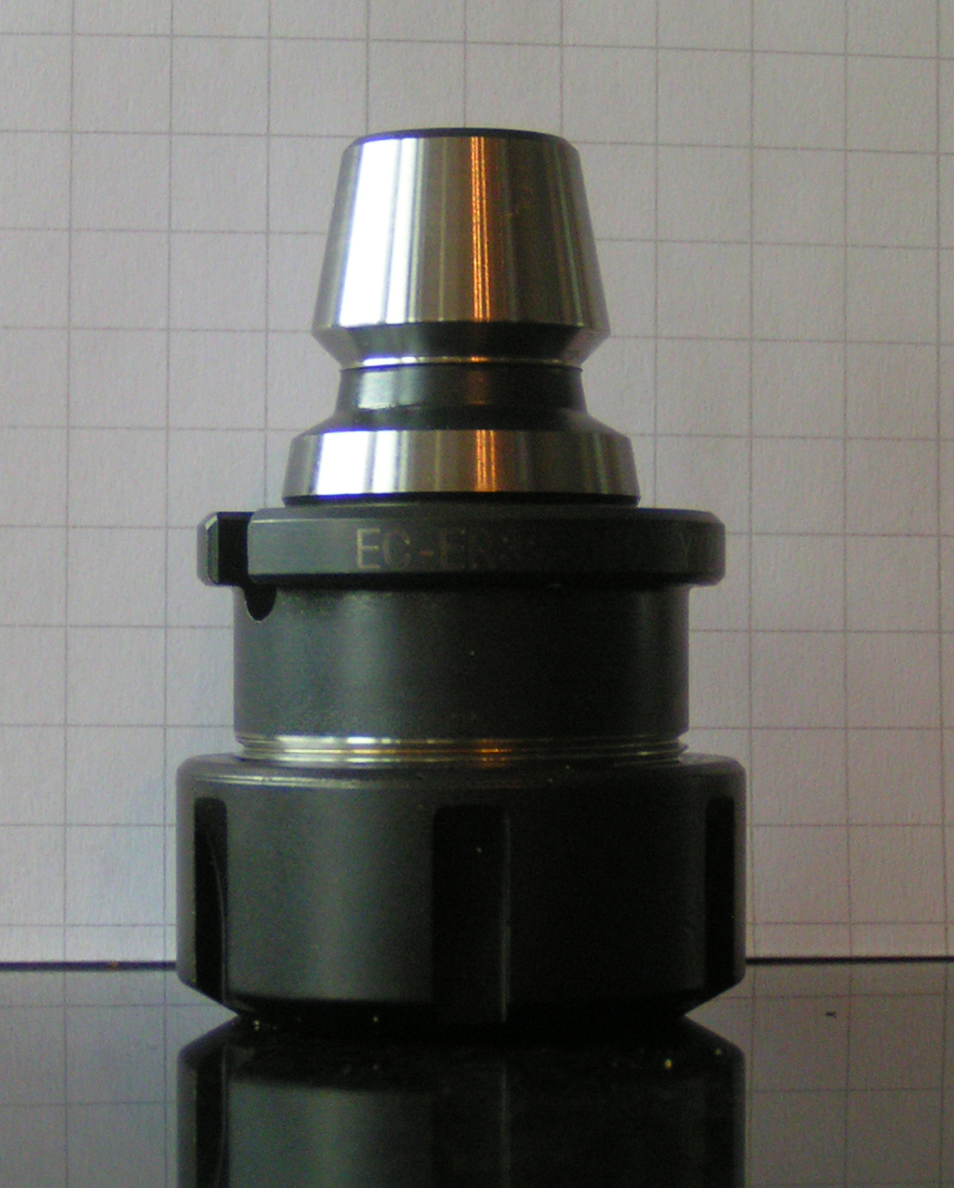

    The background grid is 1cm
    The tool holder is a Coventry Quick Change

    There will be a little parallax but it should give you a pretty good idea of the dimensions and angles,
    Regards,
    Nick

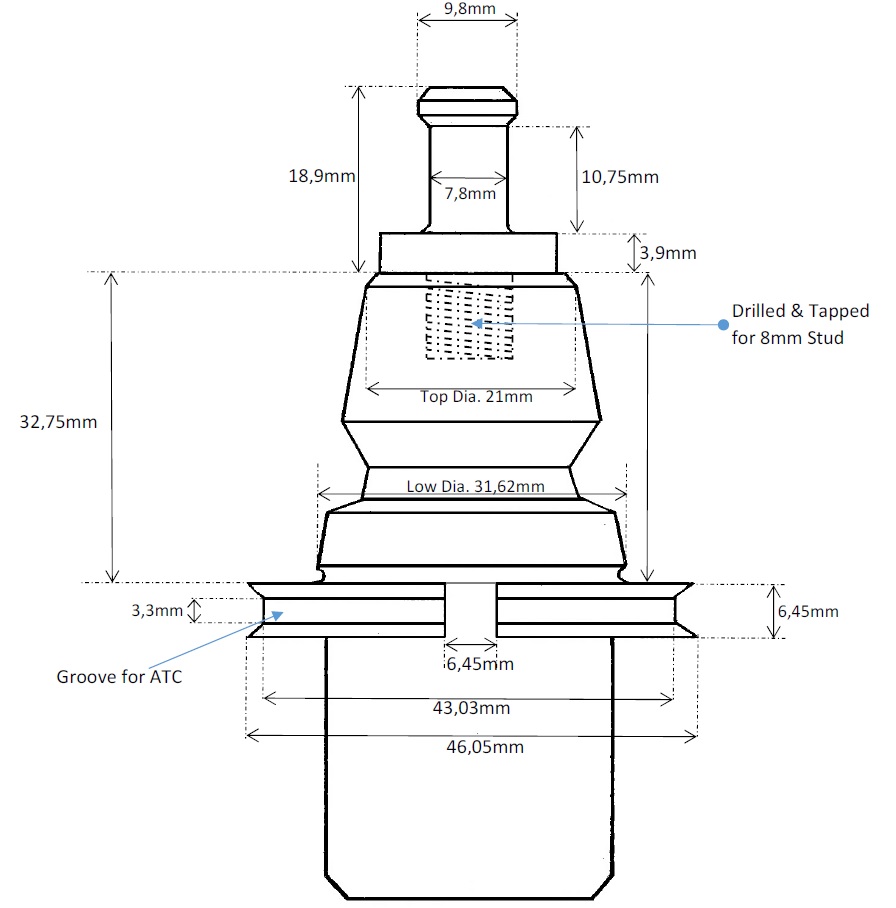

    I suspect you mean Coventry Easy Change magicniner?
    I`m adding a sketch i made today With all Critical measurements.

    Will also send it to Coventry Toolholders and have them confirm all measurements and explanation as to why the groove is missing in the top flange in their catalog.
    Believe the flange is a special Boxford solution on their first ATC`s.. or something...

    I've just been and compared one to a BT30, and the Easy Change holders have a steeper taper, which would be correct as the Easy Change holder doesn't use a self locking taper, whereas the BT taper usually is self locking and needs force to remove it.
    Unfortunately the battery is flat in my angle calipers and I don't have a spare, so can't give an exact angle.
    I've just been and compared one to a BT30, and the Easy Change holders have a steeper taper.
    Agreed, but I can't find the taper of the mystery holder, if you can enlighten the group with the exact taper of the mystery holder we could measure the angle of the Coventry Easy Change and compare?
    - Nick
    I compared it to the BT30 as well and the angle is different.
    Besides the taper length on BT30 is 50,4mm(including the 2mm notch), whereas my mystery taper lengt is 32,75mm.
    If it`s not Coventry i`m stuck, but i guess i will receive an answer from them by next week.
