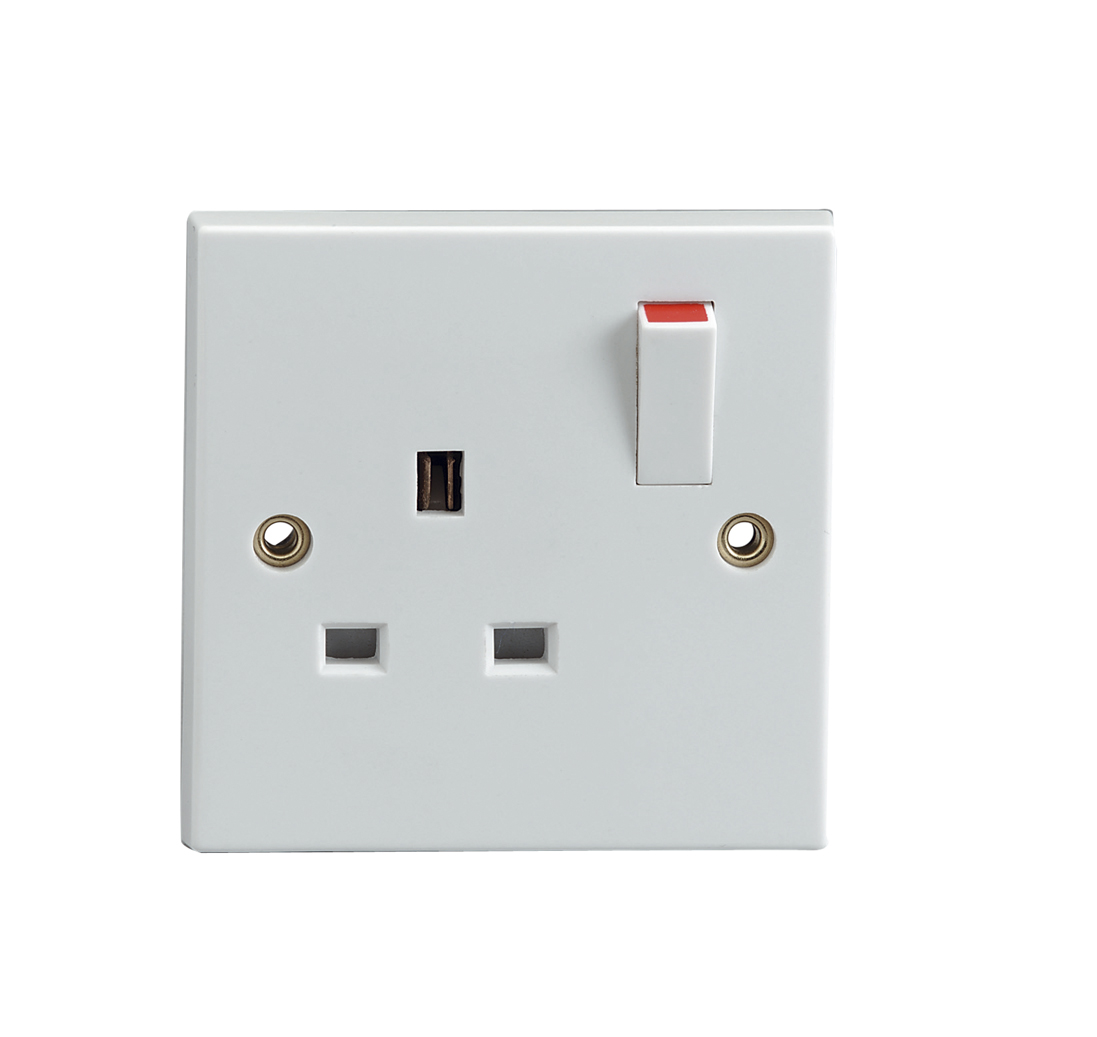

    Personally, one of these:

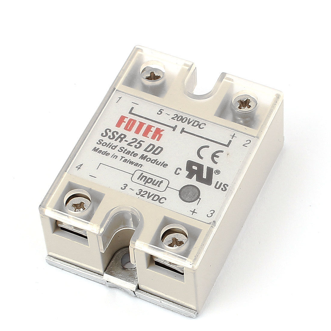

    Or, if you can spare £1 on eBay, a 25A SSR:

    I didn't have much joy using an SSR to switch my toroid supply on. Can't quite remember what it did now but something didn't work. I then read they aren't good with these types of loads. They also fail ON. Swapped it out for branded contactor (controlled by 24V logic on an estop circuit) and it works fine. Thanks to a kind forum member for sending me that part FOC !

    The mains switch made me chuckle. Should also be fine but then it's not part of a safety circuit if you want to have that feature in your system
    This could be because some SSRs switch only at the nearest zero crossing point, which is the point that gives the highest inrush current for a transformer, so not such a great idea. Other than that I can't think why they wouldn't work well.
    They also fail ON. [...]The mains switch made me chuckle. Should also be fine but then it's not part of a safety circuit if you want to have that feature in your system
    I agree neither is going to fair well with any modern safety inspection.
