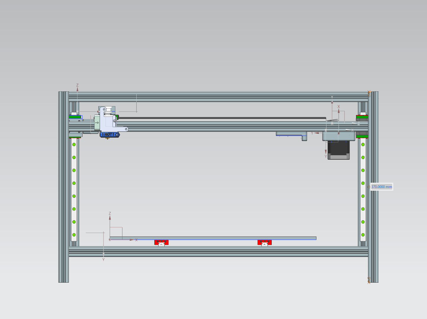

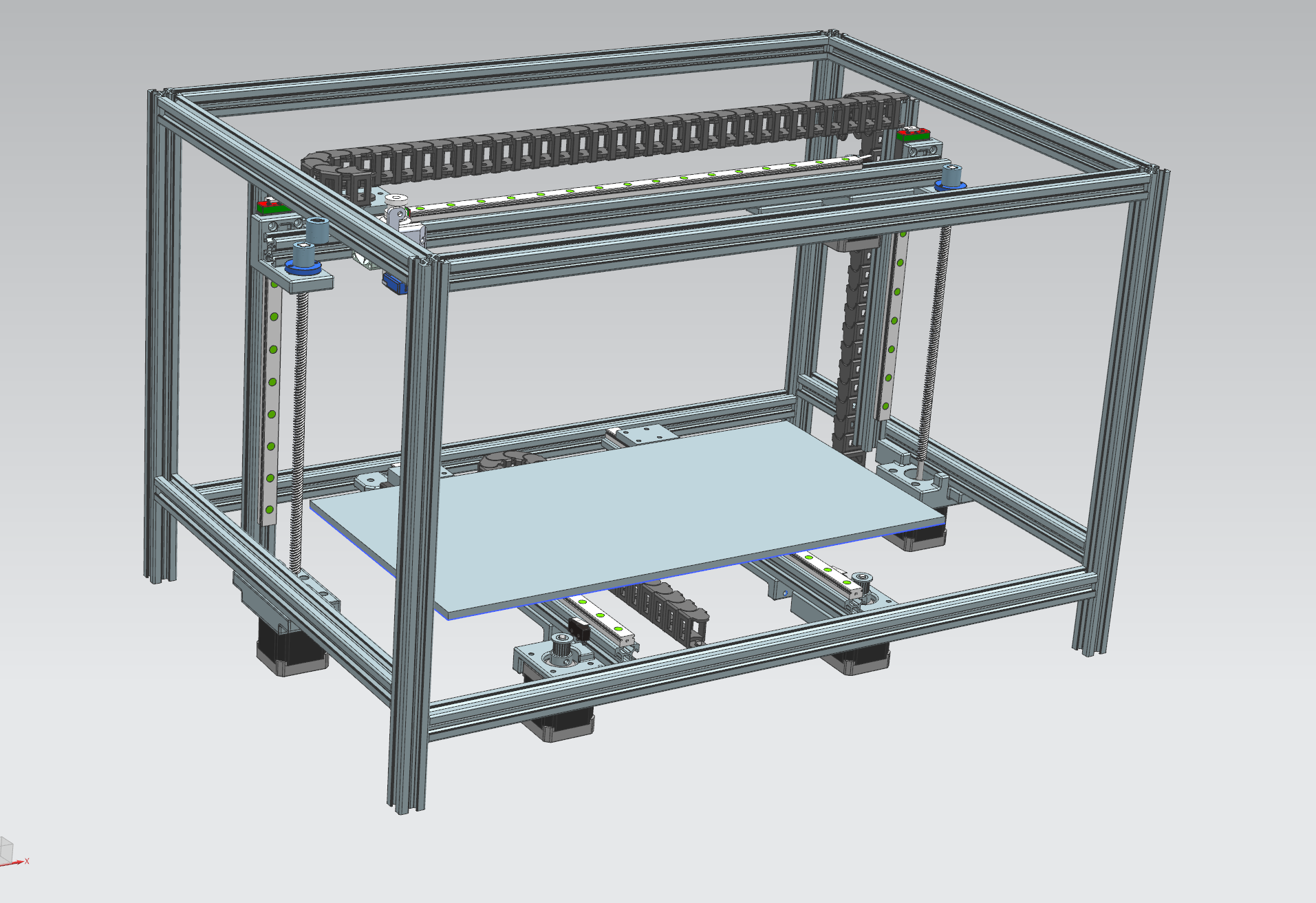

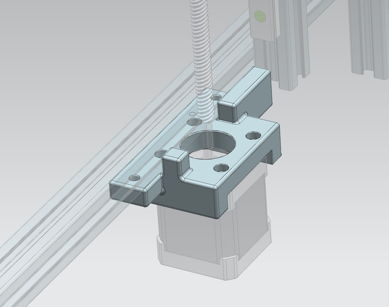

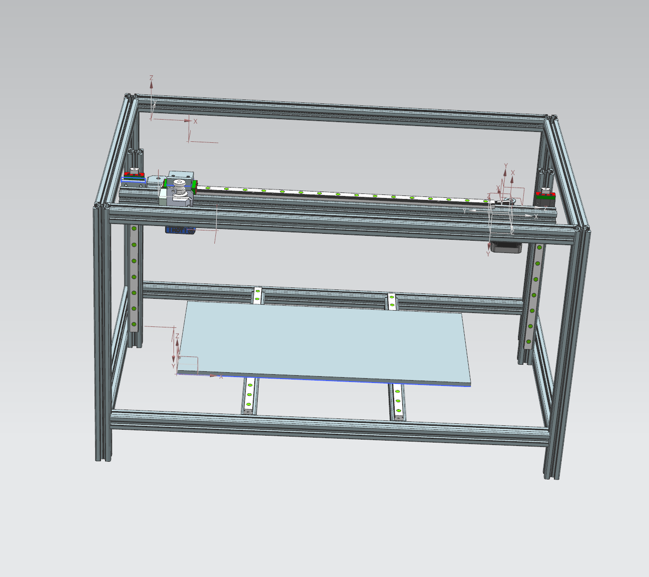

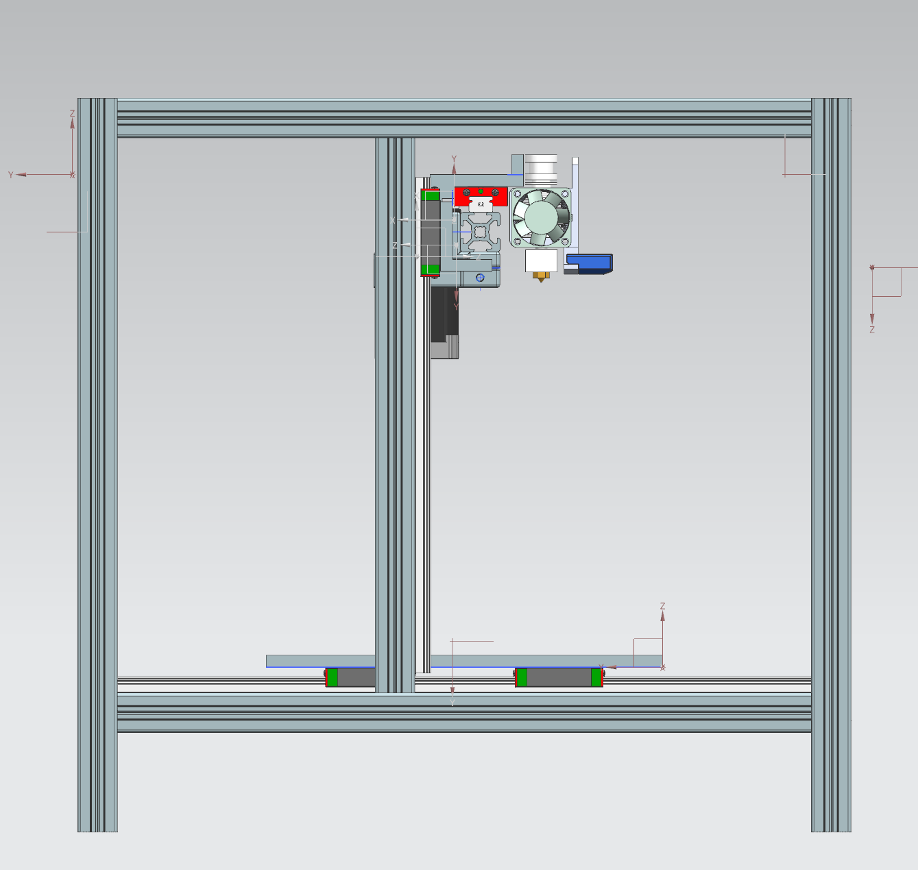

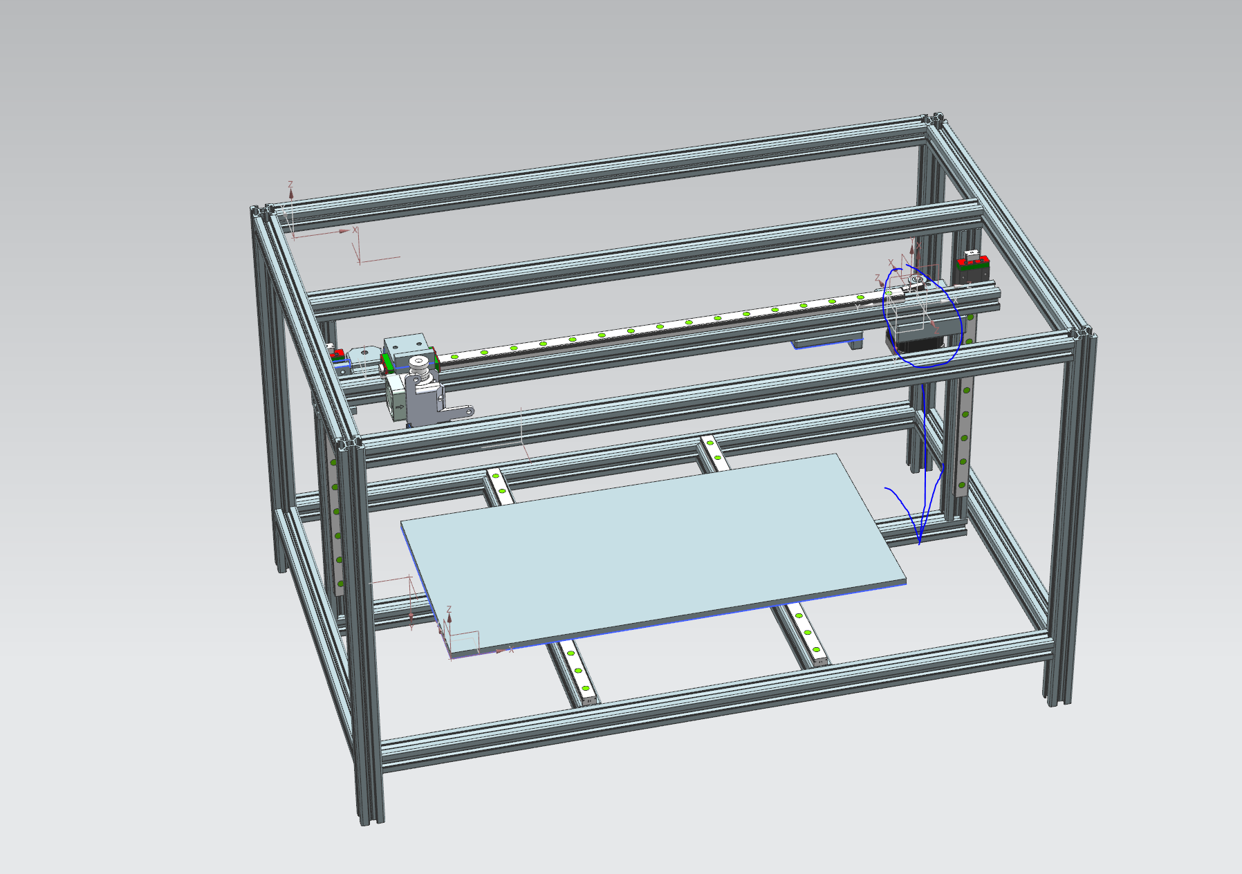

    Anyway, i moved further with the design. Managed to make the gantry very tight vertically, same with the hotend. Plus at the end i decided how what to do with the X motor, which will go in the clearance between the gantry sides and the table, which means keeping the structure height etremely low. That combined with the shallow depth will make it a real table top machine. Not some ugly cube. At the moment stands wide 620mm and high 370mm. I am still playing with the idea if i need or not the top and bottom cross bars, look last picture where removed. Looks more simple and better to the eye, I will decide that later . Their main idea was so if i sell the machine to sb all linear elements to be premounted here by me, Guess i have to receive the 20x20 profile and see how it will go. Their other function is if you fit servo drives and do crazy speeds so the machine to wobble. Though it wouldn't if side and top panels are fitted
    Another thing that bugs me is the cable chain. Yesterday printed some cable chains and they are not properly designed for printing even if they tell so. I will check what price are Chines, design proper one or use what they use on the Original Prusa. Some kind of cable tie organizer???
    have also started printing the parts and well, i am quite happy with the result. Till now had to redesign only one of the, All else is indestructible by hand. Which is how i like it to be strong. The hotend plastics are downloaded from internet. Just printing them now, cause i think i will have to redesign them to be stronger and ventilator adjustable somehow up and down in case i switch to the Volcano heater

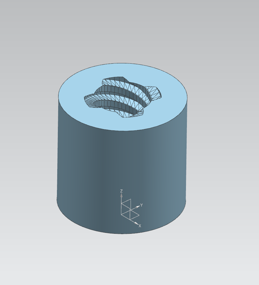

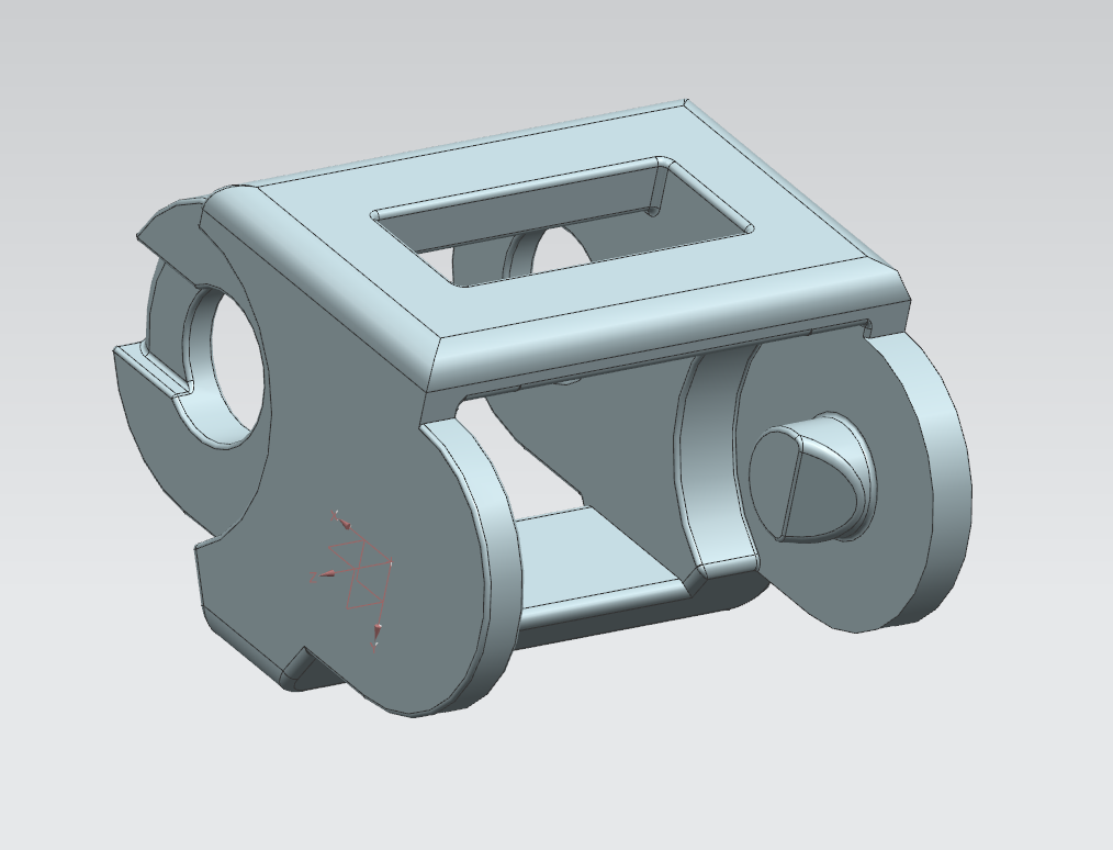

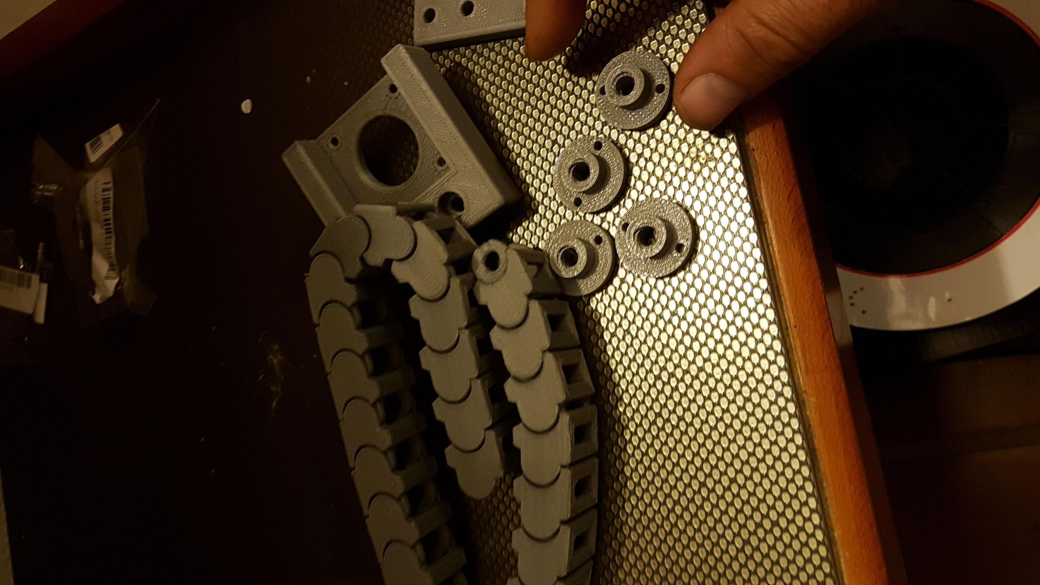

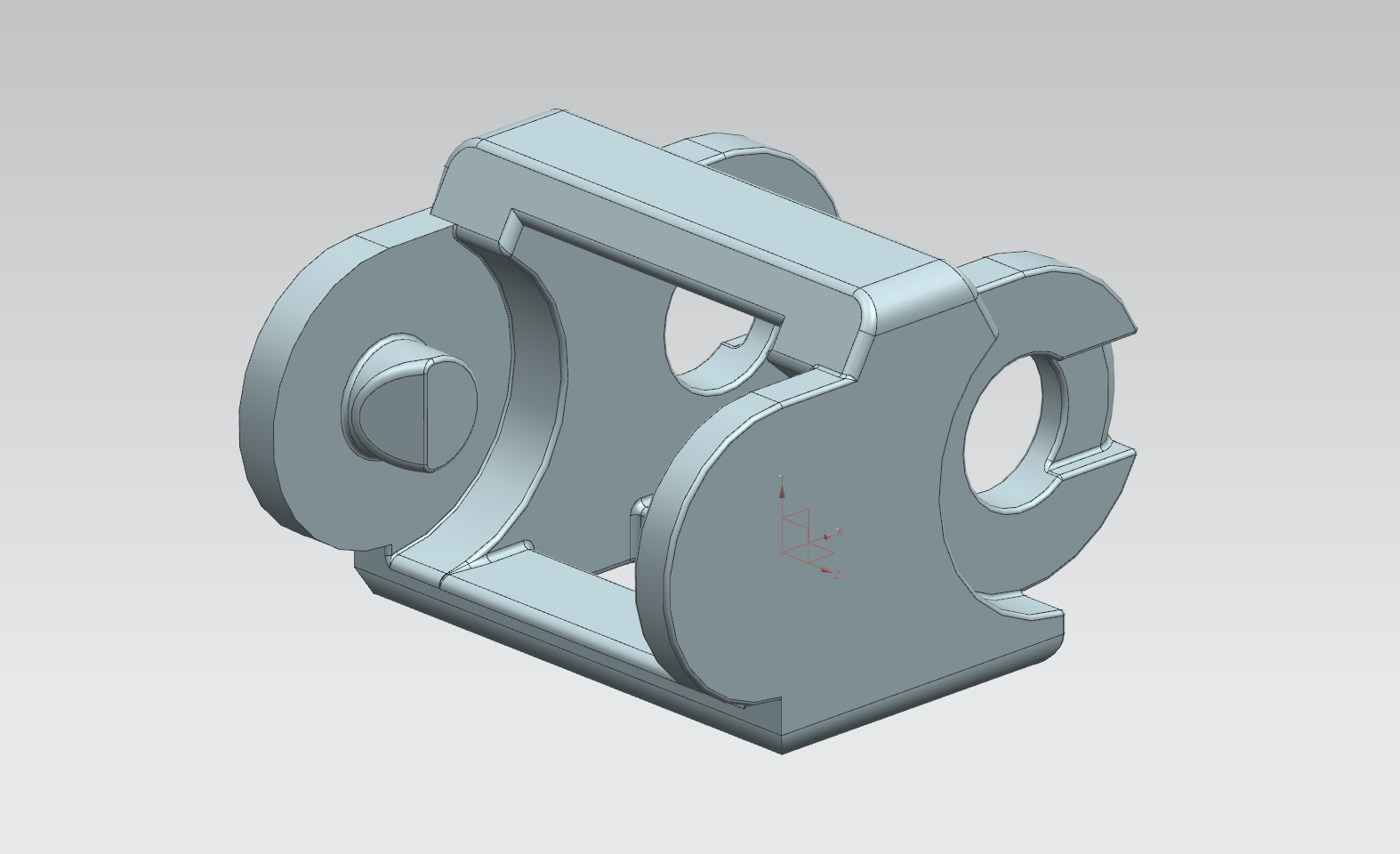

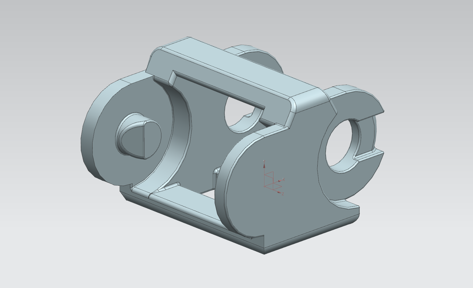

    Today was a busy day, but while resting managed to finish printing a couple of popular cable guide chains and found that not one is working properly. Mehh, i was not into designing a cable guide but it seemed that i had to. Luckily having the printer at hand i did some prototypes and at the end i have sth that i am very proud of. Its strong, impossible to break and to break apart using normal force by hand and most of all moves freely cause i left the necessary clearances. if i further compromise a mm or two and make it bigger here and there , i can make it even to be printed assembled, though dint see reason to do that for now as its good as it is.
    I wanted a cable chain not that i could not use just the proper flex cable, but because i would lke to be easily scalable, that means all has to be perfect from the beginning. So later just scale and do.
    About the bed. Any idea what heating wire i could use to achieve the proper 0.4w per cm2? 12VDC , 24VDC or even better 230VAC ????? I would like to route the aluminum with channels and insert the wire from below. Certanly sb will know a silicone wire or similar that could do the job, instead of the ugly silicone pads?

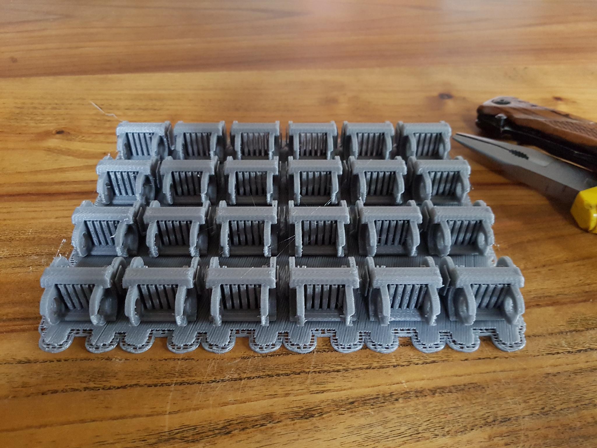

    in case anybody is wondering that is the proper way to print a cable chain links, i tried all possible today and thats how they are printed strongest:
    Ok to be more exact like that:
    By the way i would like to remind you that this will be open source so if sb needs some CAD, meanwhile i am finishing the drawing just drop me a line. I draw in Nx and can send you solids.
