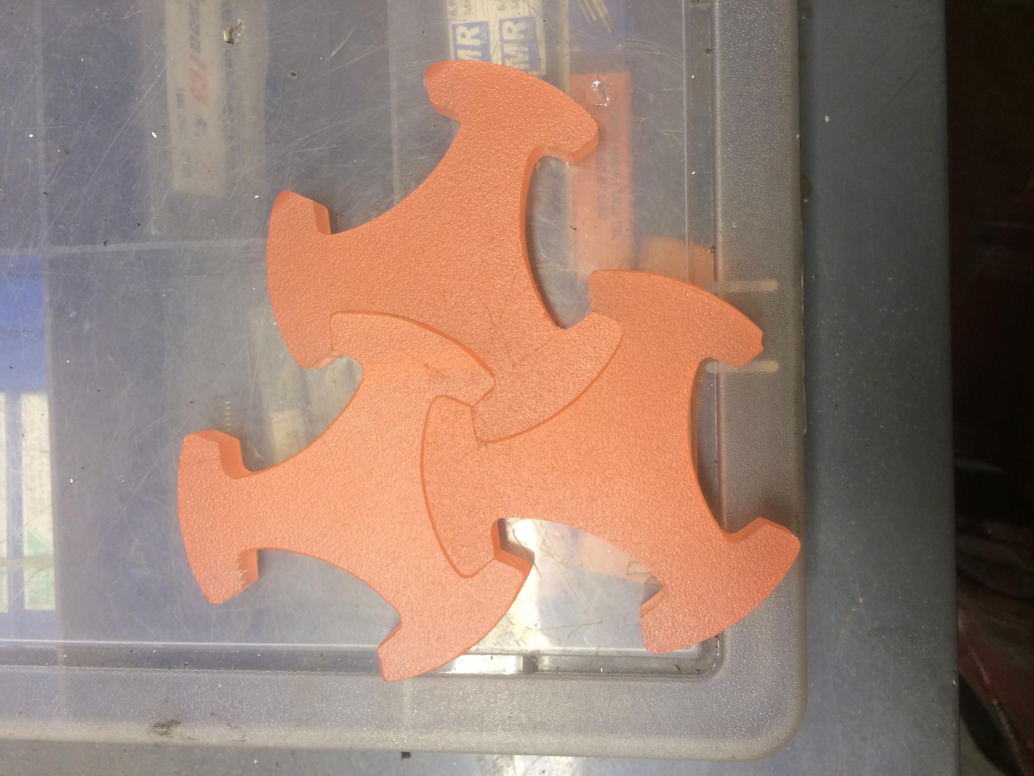

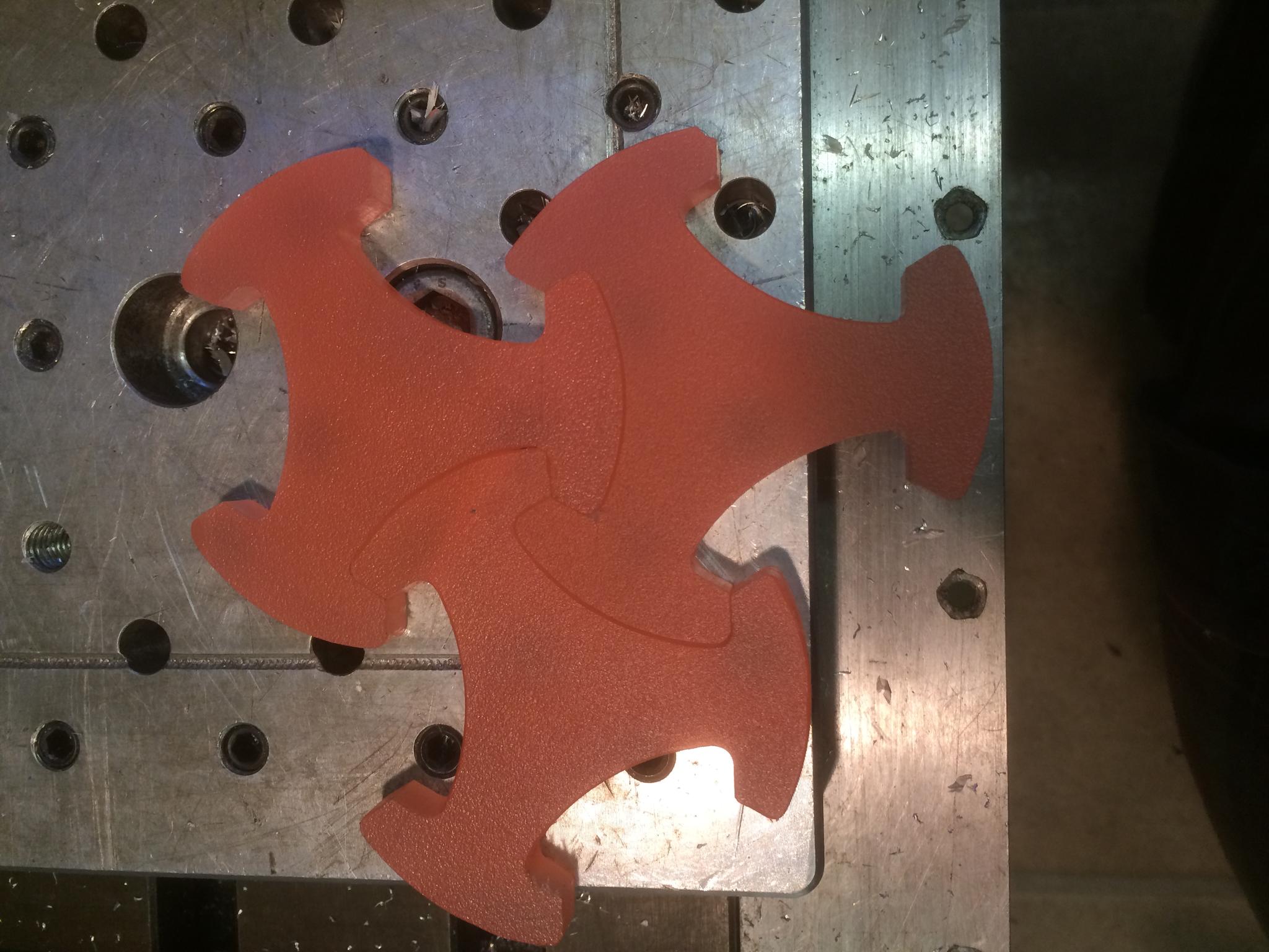

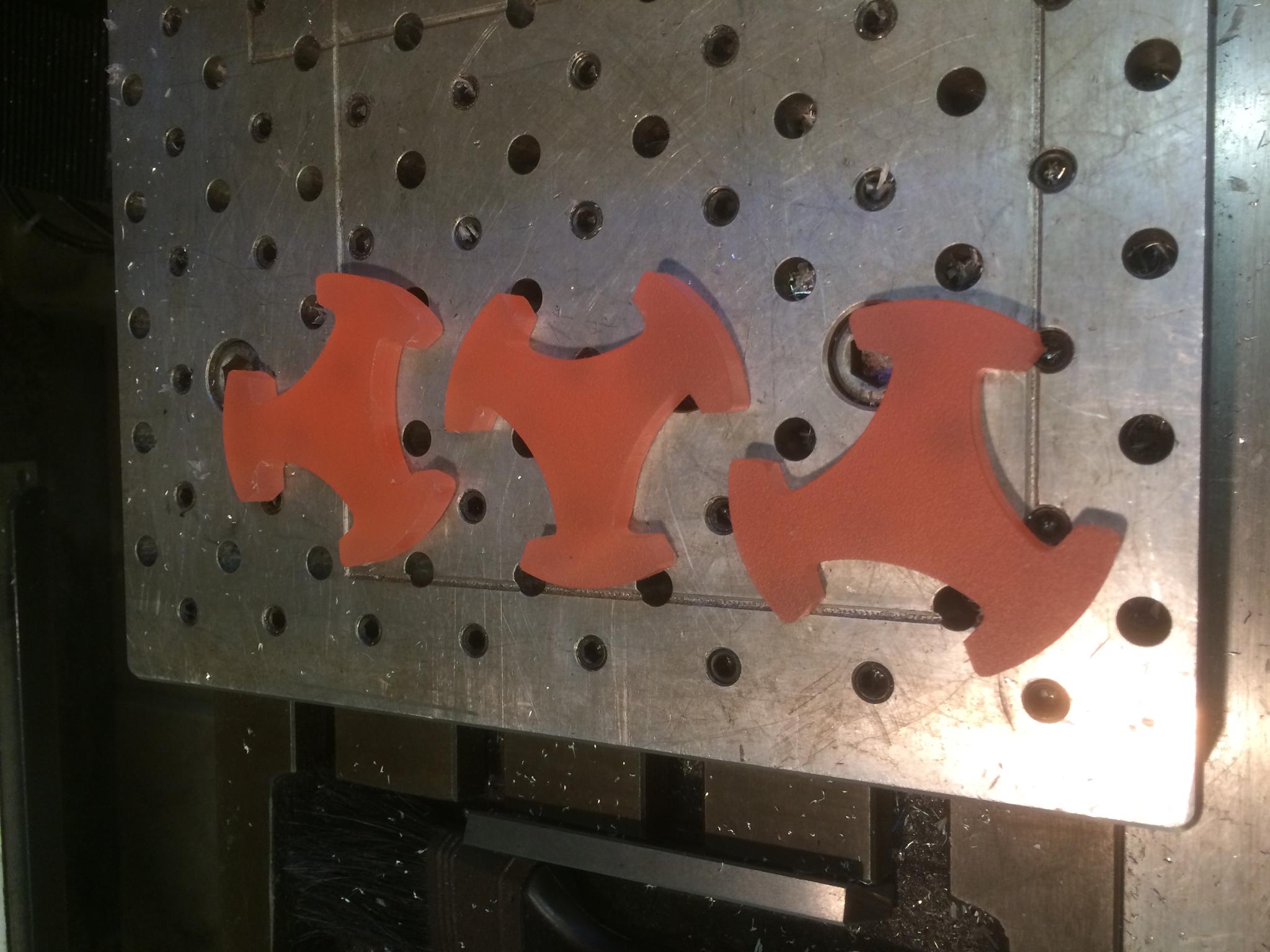

    After following this thread for a while and being completely baffled by the circle/hexagon thing, I then had a look at Neale`s fusion drawing, and decided to try cutting a few of these dovetails out. Although I have fusion 360, I still find it easier to work in solidworks so, I downloaded Neale`s fusion 3D drawing and exported it as a iges file. Then in solidworks I opened it up, seperated a single tile from the three, and saved it. After opening it back up as a single file I then shrunk it down to a maximum outer diameter of 48mm, (the width of the piece of scrap chopping board I had lying around was 50mm) and saved it as a dxf. I am now about to go out to the mill and try cutting a few out
    If this works, I will take a couple of pics to let you see the results. Just to add, I cannot take any credit at all as I am using both Neale`s drawings, and Peters original input for this experiment. So, big thanks to you both as I think it is a very nice looking and unusual joint !

    Well that was quick & painless, seems to have worked a treat

    Thanks to Neale & Peter.

    Excellent. Good to see that it all works. I think that the corner radius was a good plan as it makes the design accessible to those with routers but not laser/plasma/water jet cutters (which probably means most of us) but thanks to Peter for the initial idea and doing the bulk of the leg work.

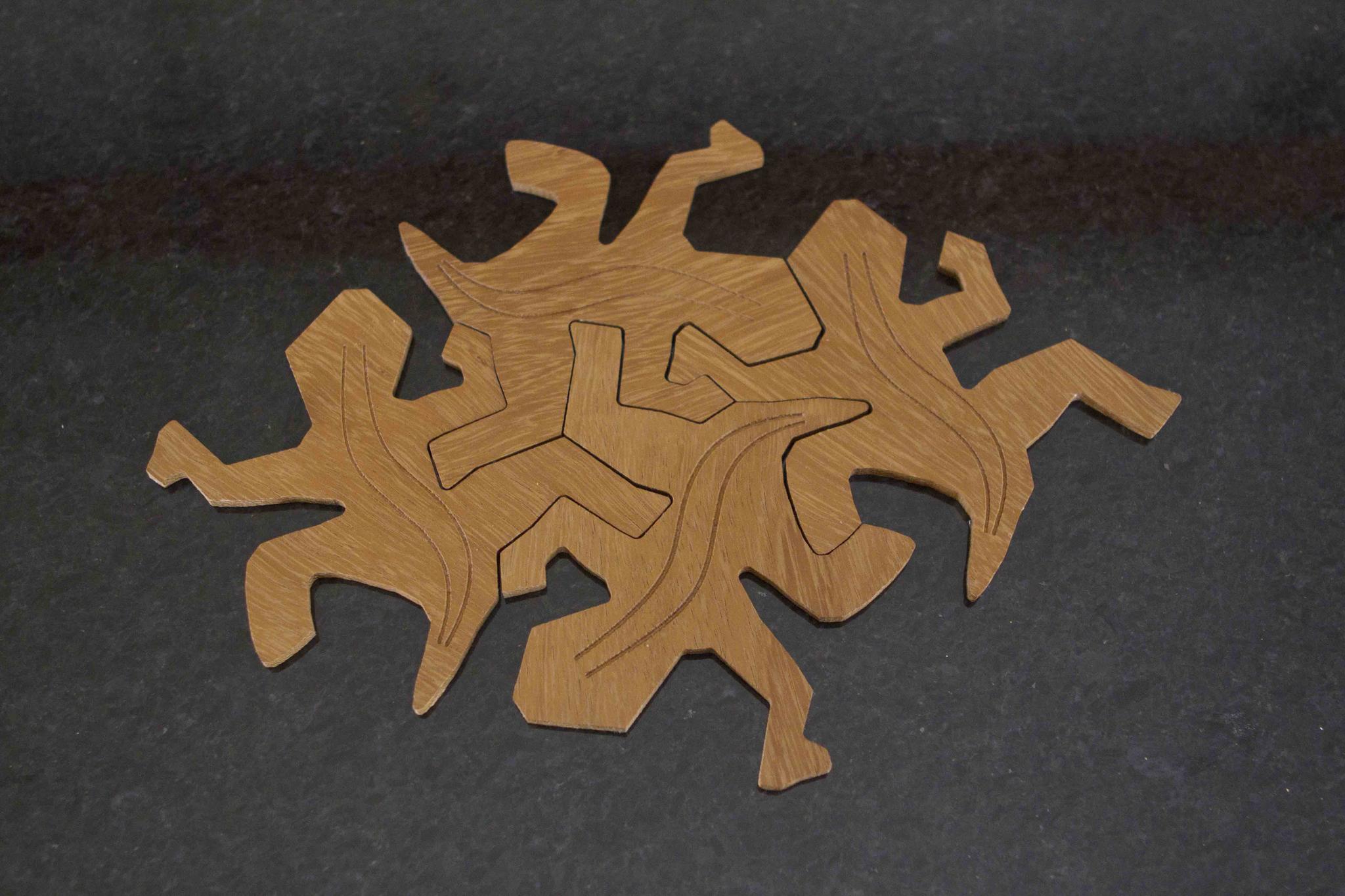

    Needleworks - you need to make another 3 or 4 more. People see them sitting on a flat surface and can't help picking up a tile, turning it round, and dropping it back in somewhere else. At least, they do with my Escher reptile-based design, and I can't see why these shouldn't work as well.

    Very nice! The first ever trispokedovetiles to make it off the drawing board into real life!

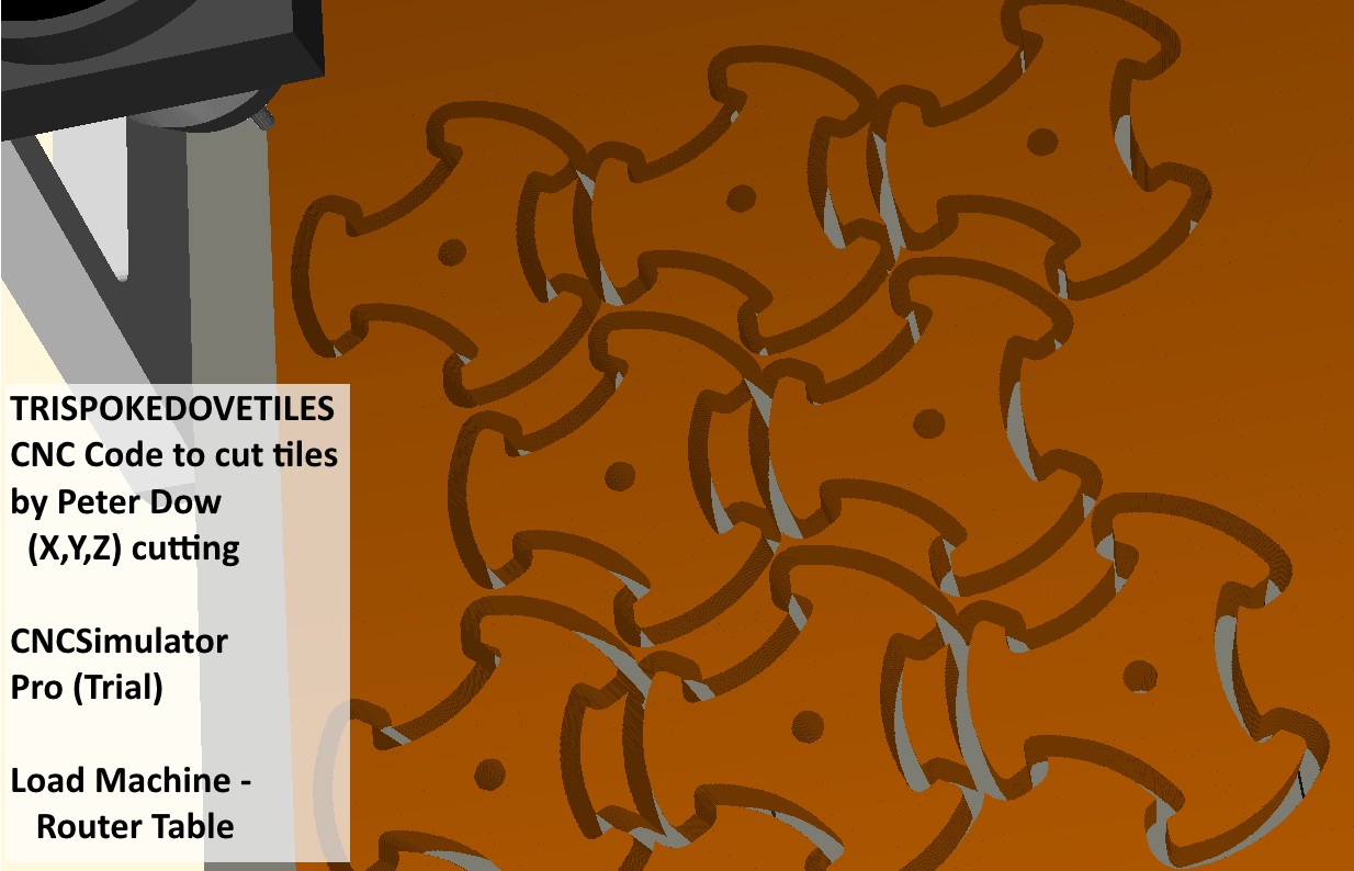

  7. TRISPOKEDOVETILES ROUTER CUTTING
    My trispokedovetile CAD-CAM webpage now offers an (X,Y,Z) option for router cutting using rotary tool paths between spaced out tiles -
    I've simulated the CNC router code -
