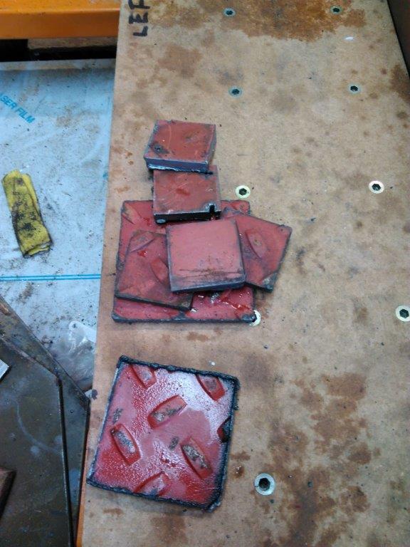

    Well slowly getting there.....with help off warwick and Andrew....i have the machine cutting from mach3.
    Andrew sent me a few files which i used and alter to suit my machine which is identical to his i.e purelogic and hypertherm and switching on spindle as warwick mentioned i got a few squares cut.

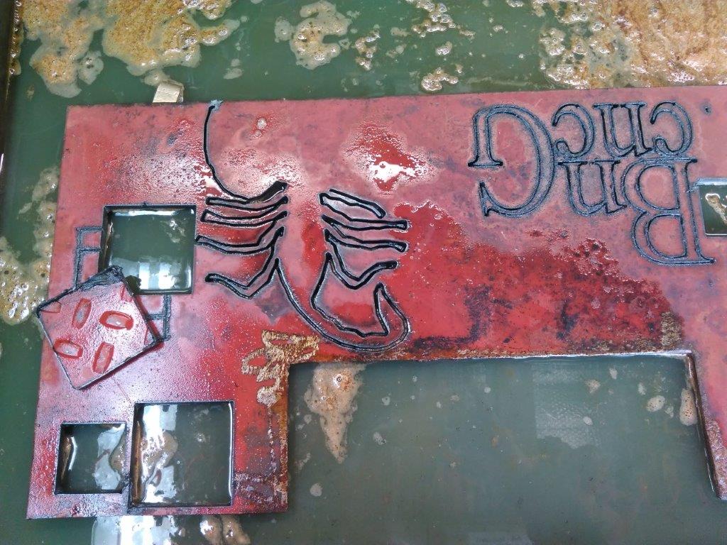

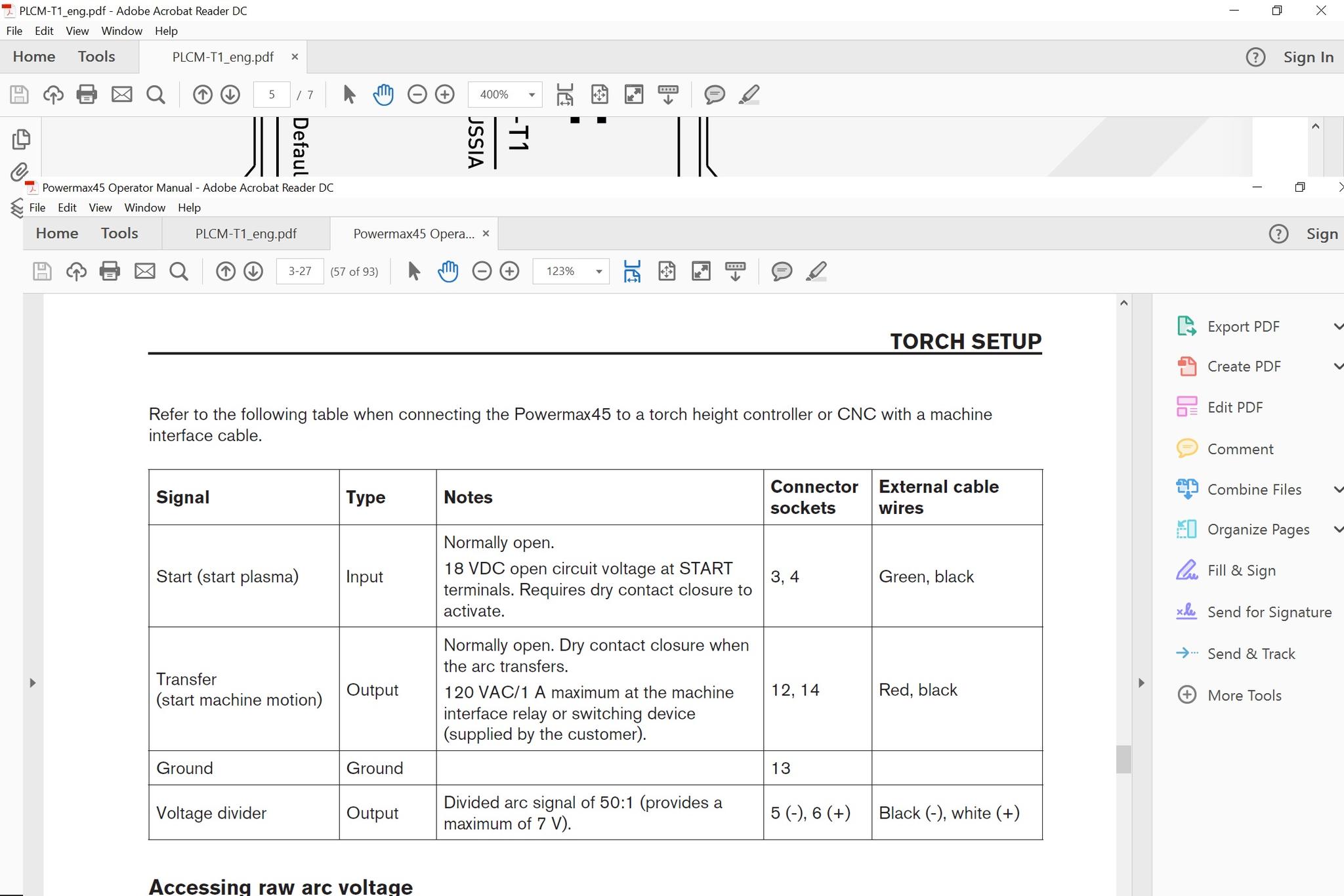

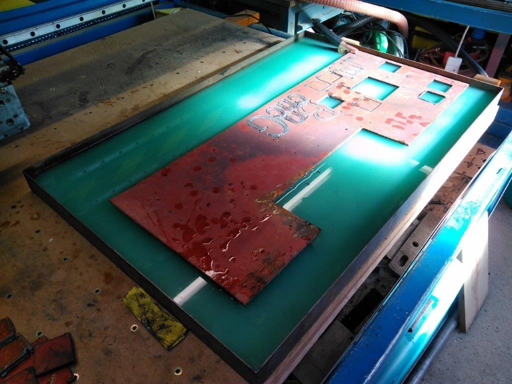

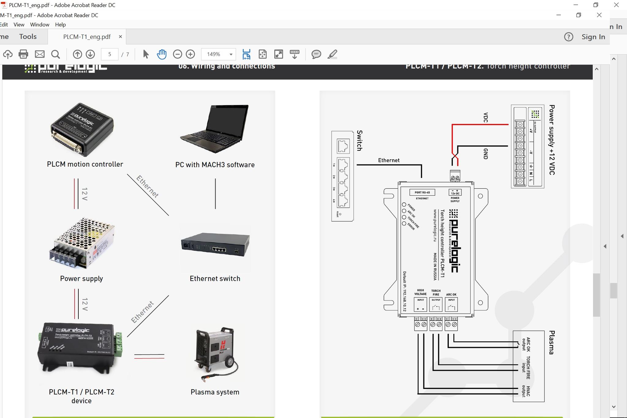

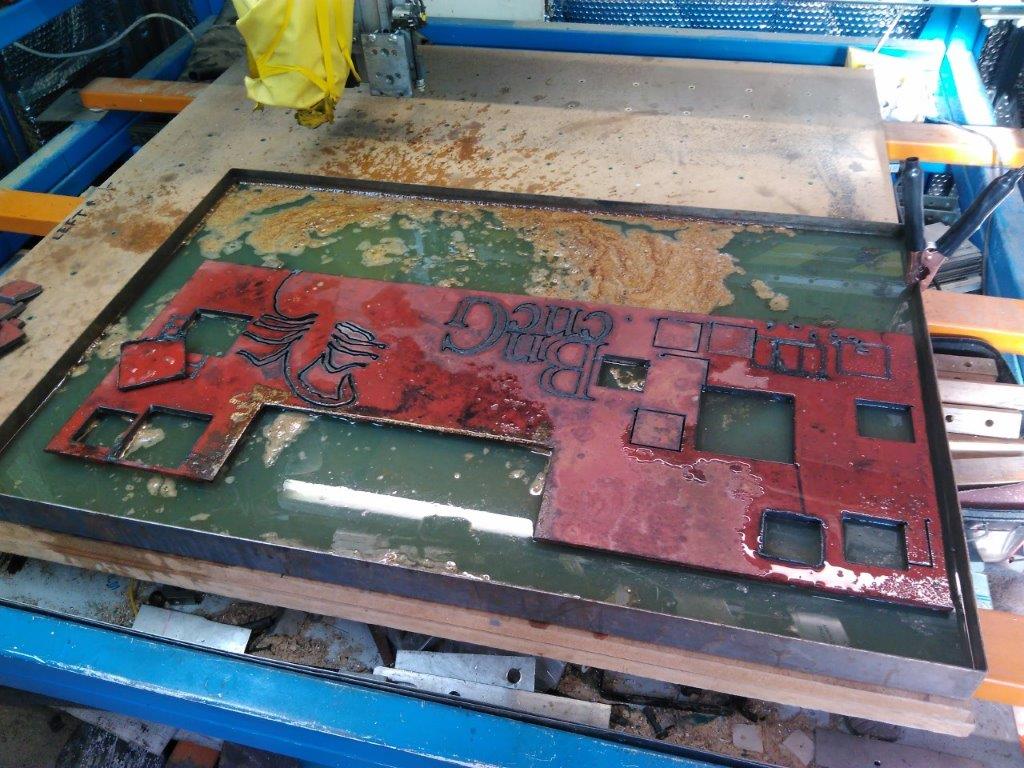

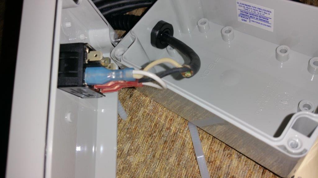

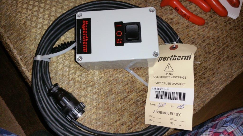

    Hello All

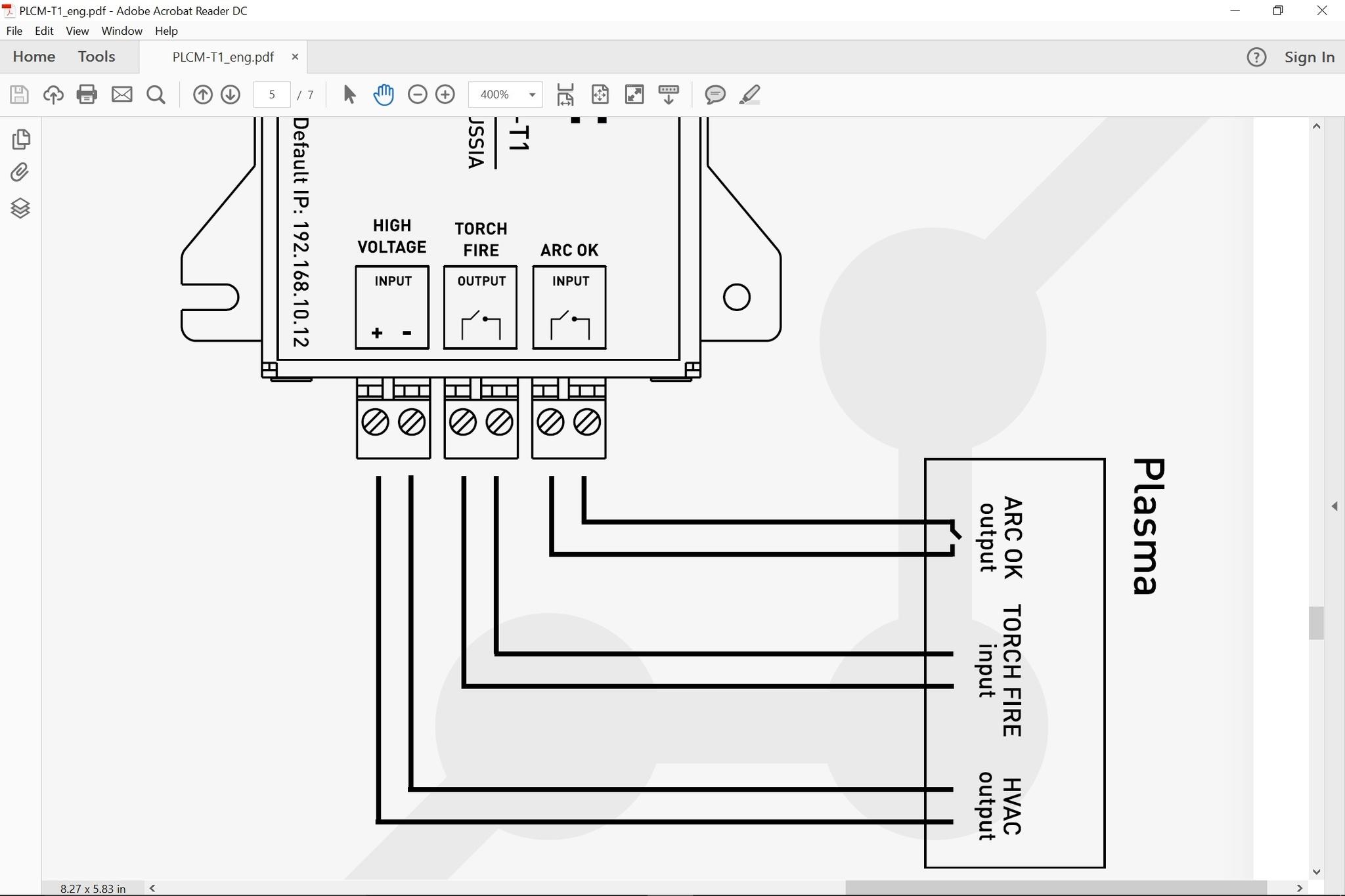

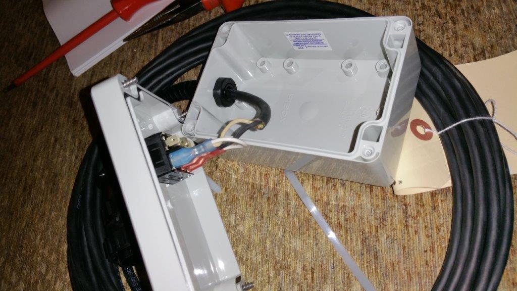

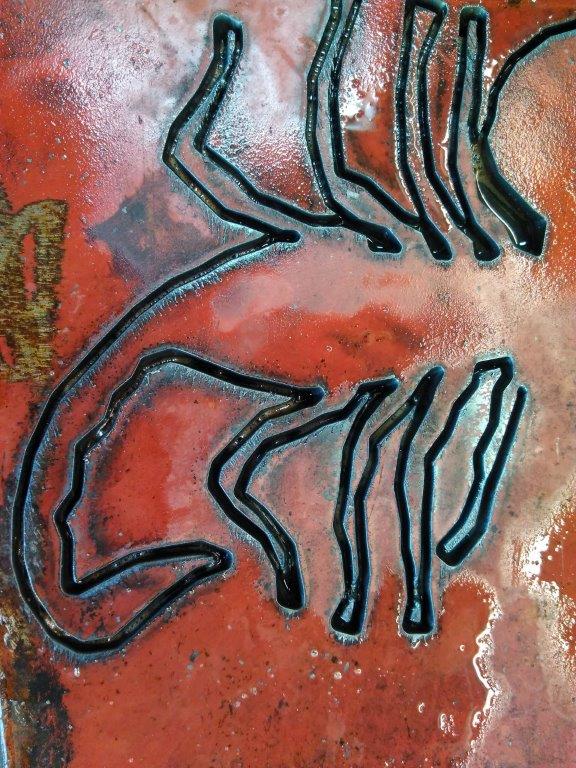

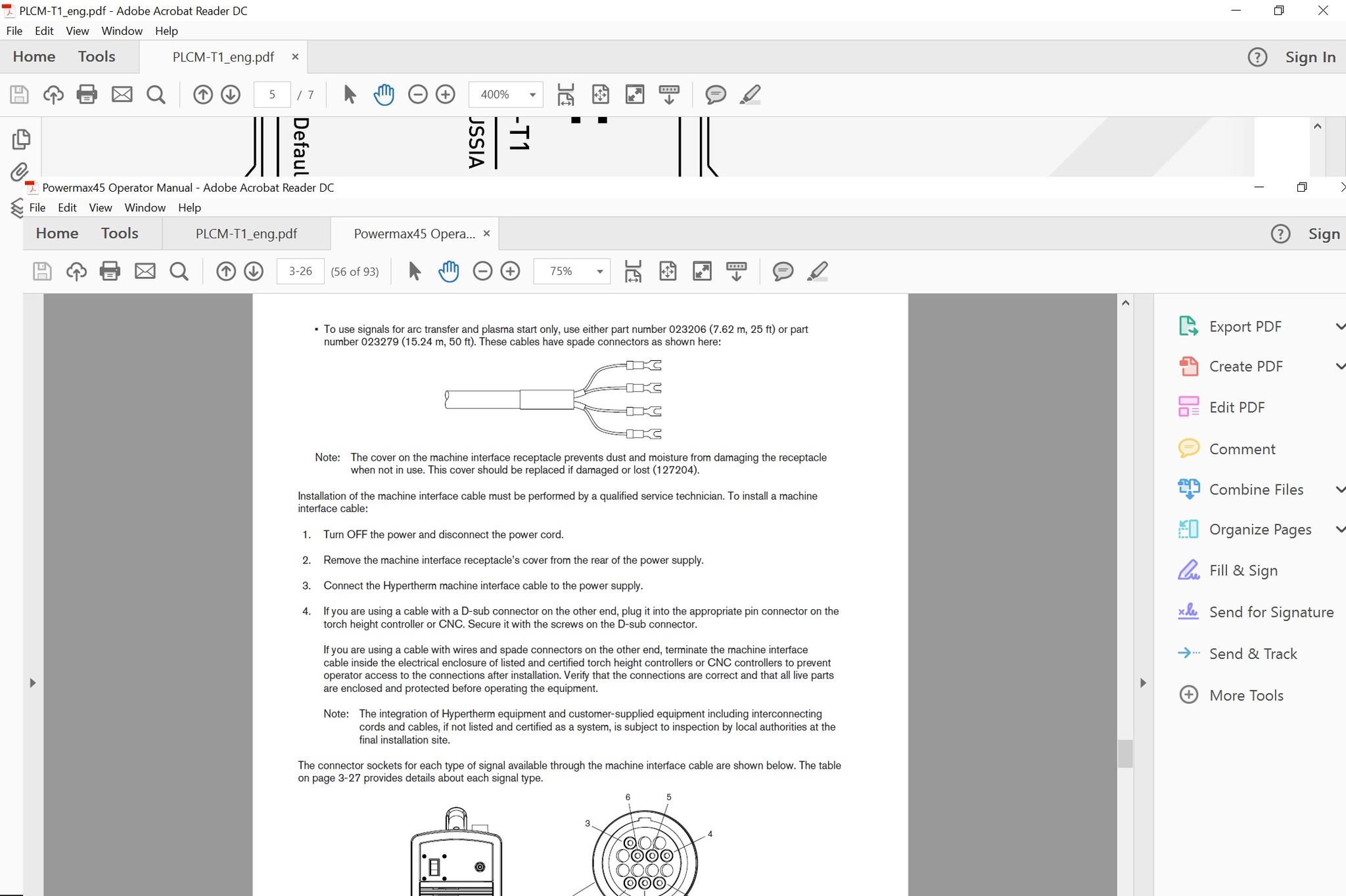

    Rewired the Hypertherm 45 up today and set it away....It now shows the voltage going up and down but still no movement on the z axis.
    Not sure if it is a pins problem or a software problem....I'm getting there but one brick at a time unfortunately.
    Got family coming tomorrow so can't play with it Sunday which is a bummer but there's always next week..
    Ill do some more reading and I have had a few replies from Purelogic which stated i had to use the raw voltage rather than the divided voltage i used previously..
    The metal I have used is 6mm thick and quite flat so not sure if it is not moving because it doesn't need to so I tilted it approx. 10mm one end and when the torch moved towards the high end, the voltage dropped but no movement from the z axis.
    The machine works as should except for this one little problem and I have attached a few photos of my progress up to now.
    Think I will try the software you use to see if that simplifies things.
    Will keep playing until it is sorted.
    TommyClick image for larger version.

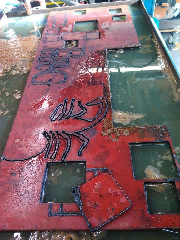

  9. #19
    Well got it sorted eventually as Purelogic.ru sent me the most up to date file and also help off Andrew and Woz (again many thanks).
    Must give Purelogic praise as even after buying the items 3+yrs ago, they answered all my queries instantly without delay even though thay are in another time zone and gave me a few pointers aswell. Excellent customer service.
    It now moves..........so very happy and now on to the free water table build.
    Many thanks to all who helped.

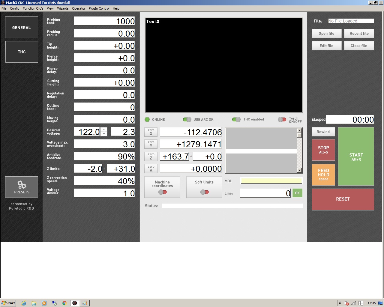

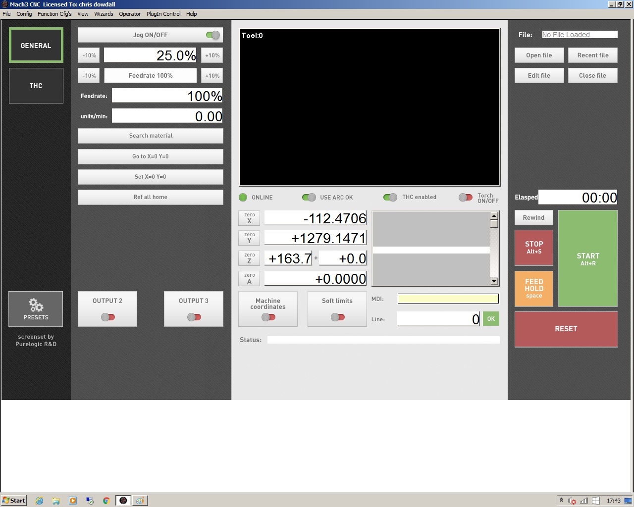

    Glad you are up and running Neil !
    Tell me, does this give you the screen sets that you originally had, or are you now in the simpler ones that my set up has ?
