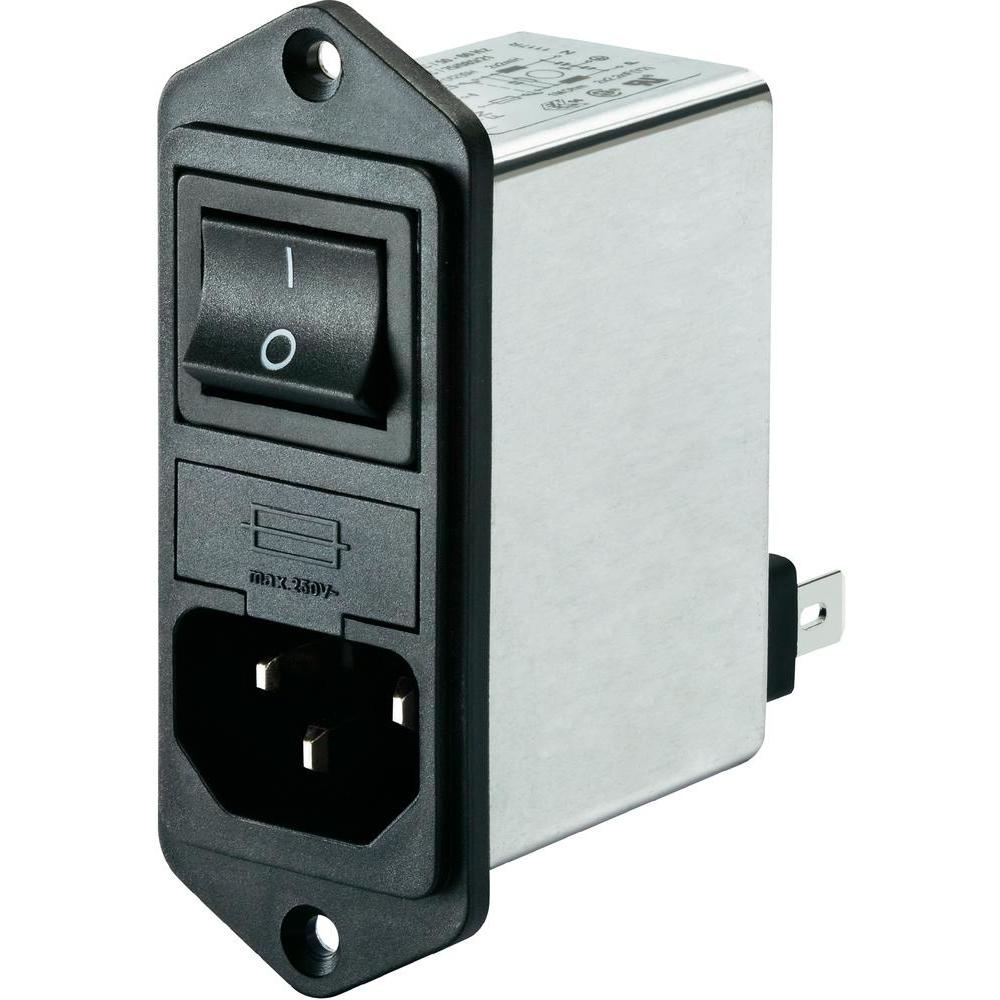

    I have a switch with fuse and filter like this one...

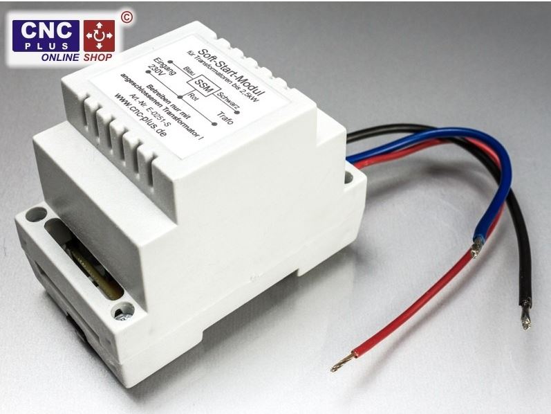

    ...and after that a slow starter like this:
    Name:  Slow starter.JPG
    Switching on slowly means no "bang" and current rush. Switching off is no issue at all. The currents are MUCH less than a vacuum cleaner.
