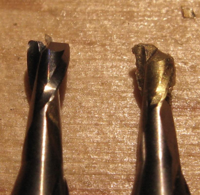

    Hi again. I've found myself a 2 mm, 2 flute end-mill with radiused corners (0.2 mm radius) and used the FSWizard web calculator, from which I get a 5 mm/second feed rate and 23,000 RPM for cutting in brass. I've just tried using 20,000 RPM and a 4 mm/second feed rate, running 0.3 mm passes to achieve a 3.8 mm pocket in brass. 10 hours in (it's quite a long pocket), towards the end of the last pass (13 passes), the bit started making screeching noises and eventually snapped. You can see from the picture below that it was fairly badly damaged.
    Two questions:
    1. Am I expecting too much for a bit to work that hard for that long?
    2. Should I try, say, a 3 mm/second feed rate and 26,000 RPM (the next step up on my motor)?
    3. ...or something else?

    For tools smaller than 3mm you really need to find what the manufacturer says about that.
    Depends on the bit though, i mean about how long lasting you expect it to be. Instead of using feed wizard, better download the full HSMAdvisor.
    Your questions are pointless without knowing the final depth of cut, the shank of the cutter, the LOC and the tool stick out from collet.
    Your machine is not on the rigid side, having in mind that it moves on unsupported rails, so maybe have that also in mind.
    Depends also what quality bit you use? I have 2mm bits that each one is priced 60 euro and have some that are 5 euro for 10 pieces? Obviously that could be a thing.
    Tramming your machine means the head /Z to be perfectly square in X and Y direction to the table. Other wise marks could be deeper. Though i dont see them to be so bad as i would expect from that machine.
    Brass must be the easiest material of them all, at least for me. I dont believe you need a rounded cutter for this job. The best bits for the $ i know in this size are the Kyocera micro grain carbide, from drillman1 ebay.
    Wanna see them in action? here is a video how i drill brass on my machine. 15 000 holes with a single bit is not a problem. I said bit, not a drill, as i did not have a suitable one at that time. Remember that sound. Thats the sound of a rigid machine, sharp micro carbide bit and perfect for machining brass.
    Bellow i did the calc in HSMadviser which i greatly encourage you to test and purchase later as its extremely useful.
    Changing the suggested pass depth very actively affects tool life / surprisingly for the better this time, normally for the worse/ so 0.3mm pass depth gives me 219.46 mm/min and double the tool life.
    I agree with Merlin, in fact for brass max spindle speed is the right choice for me. with a small tool i mean.
    And again, when you calculate, take care for the stick out of tool. Must be as min as possible. Cause if the tool was only 10mm protruding from collet, not 20 as the calc above, then 0.4mm depth of cut instead of 0.1mm and 438mm/min which is roughly 4 times the initial material removal rate
    Another thing is that its not right on metal/or even wood/ to dig straight to the end result. offset 0.1mm and make 0.1mm separate finish pass, if need be with brand new tool especially for the finish pass.
