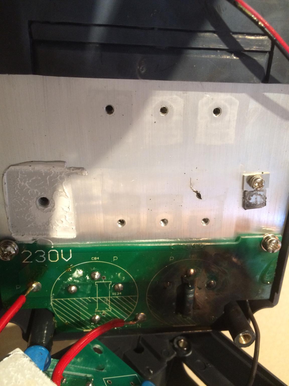

    Hi, I've recently bought Huanyang HY02D223B and I'm stuck with wiring.
    I've read 67 pages manual and could not find single sentence where I should conect L (live ) N ( neutral) and earth.
    On manual say it is single phase 230v wired or 3 phase 380v wired.
    If my house have 380 V supply I have no problem with wiring.
    But my house is single phase 230v.
    All I need is someone to tell me where to connect
    L as ( live)
    N as ( neutral)
    Earth.
    Many thanks. Stan

    L goes to R or S or T
    Earth goes to E(9)
    And N?
    I can't connect N to R or S or T
    R,S,T is phase not Neutral
    It tripped my Fuse straight, I've tried, twice.
    Thanks for replying. Stan

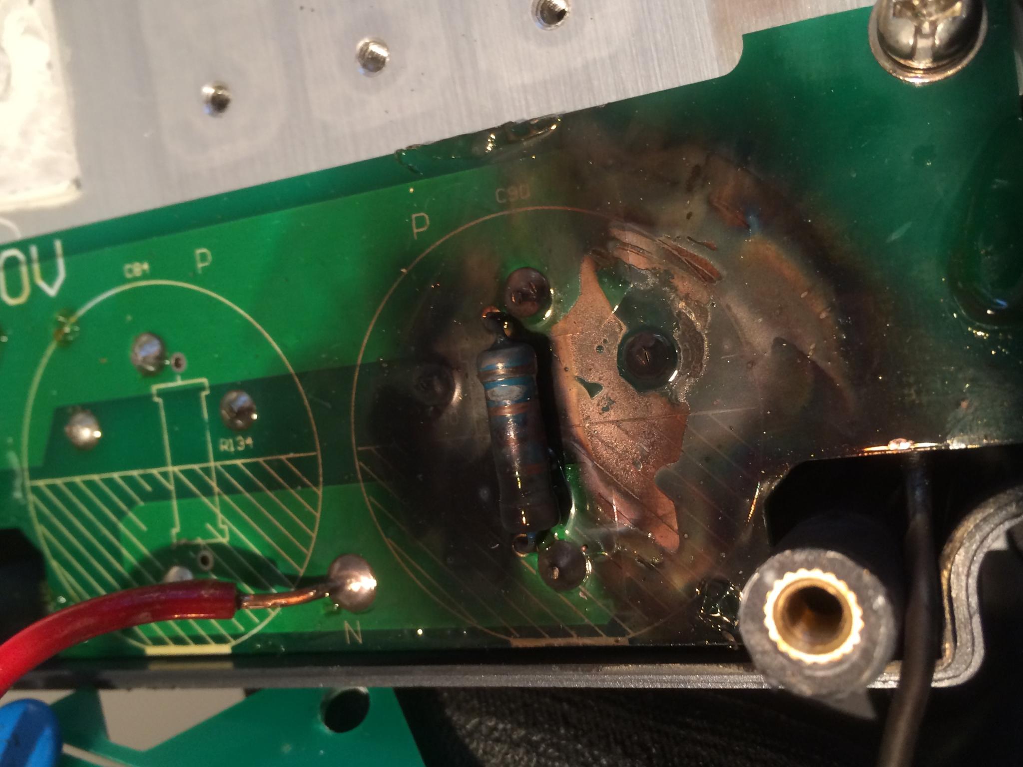

    Hi, thanks to all who replied.
    It's all over now.
    I've waisted £299.
    My VFD is burned out.
    Unfortunatelly I wan't so lucky as many of you with my VDF Huanyang.
    It's all about wiring.
    RST is life only, you can't conect N neutral to it, it will burn as mine.
    Thank you all for your support, I appreciate it.

    You can indeed connect L to R, S or T and N to one of the other two. That would NOT burn up the VFD, that is the normal way of connecting it. But it assumes that you have a VFD which is for Europe, not for the USA. Is that the case? I mean maybe the seller sent you a unit which is for the USA market.

    Hi.
    The seller send it the VDF for Europe wiring.
    I live in uk, we have 240 volt 50/60 Hz.
    Also I've contacted ebay seller, he send me the same youtube wideo as everybody saying here, including you (A_Camera) that I should conect L wire to R and N neutral to any S or T and earth to E.
    Which I did, and what has happend, no idea.
    All my wiring at home is correct.
    I have fuse board, one fuse 32 A type2 M6 is going to my garage, wire is 2,5mm, strong enought . Also on fuse board is 80A RCD.
    Maybe the RCD 's is problem?Click image for larger version.
  14. #10
    Stan's Avatar
    Lives in Bicester, United Kingdom. Last Activity: 24-07-2017 Has been a member for 4-5 years. Has a total post count of 13.
    Hi all.
    I've found the problem. I hope.
    You all above was wright.
    My VFD Huanyang has imput connection -R S T .
    That means L goes to R and N to one of those S or T.
    The problem I foung is that my RCD is not strong enought tho hold the leakage that VFD make when is powered on.
    Now the option is to upgrade my RCD to higher - ( which is very expensive) or disconect it , but only for my VFD.
    Any suggestion? What should I do?
    Shoul I try to connect it one more time but without the RCD?
    Many thx. Stan
