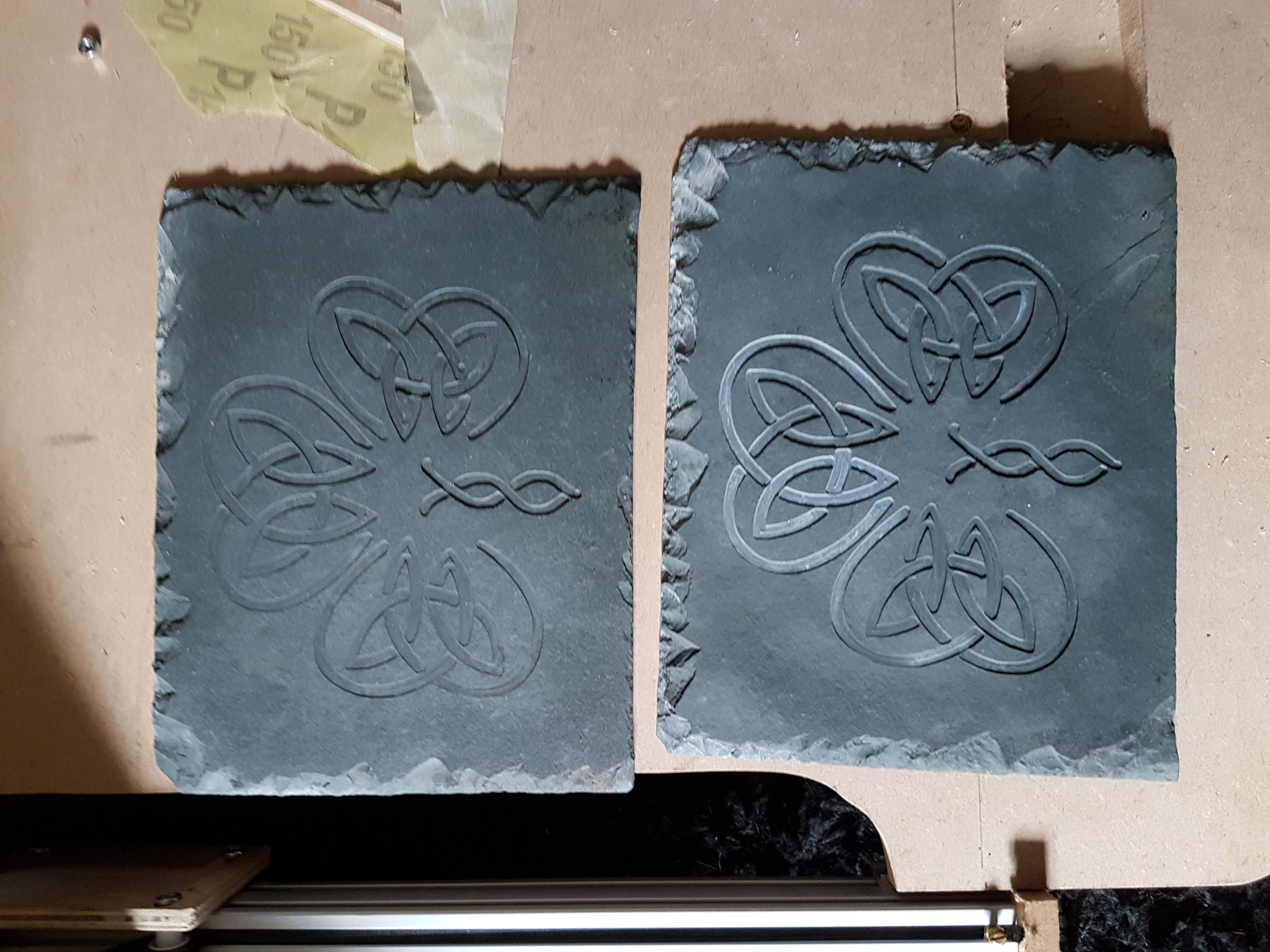

The aluminium frame in the photo is 1 of two of my baby CNC's
I still use my large wooden one and am making a aluminium one just because i can.
My wooden machine is Ply and Timber i used MDF to prototype parts (cheap stuff).
SO far cuts Hard and soft wood, perspex and slate.
Think That Qualifies as Decent?

My first big cutter (as i call it) She's made with no love, not much care and she's gonna die due to it.
Hence while shes working i'd thought i'll make another.
Shes pretty accurate as i'm always stopping and restarting my cuts (repeating ) due to something i forgot to add or take out.
Example would be this piece of old roofing tile, as they are not flat or even i had to repeat parts until they were closer to being the same depth.
ELU 860 R 16 and Easy CNC Software
