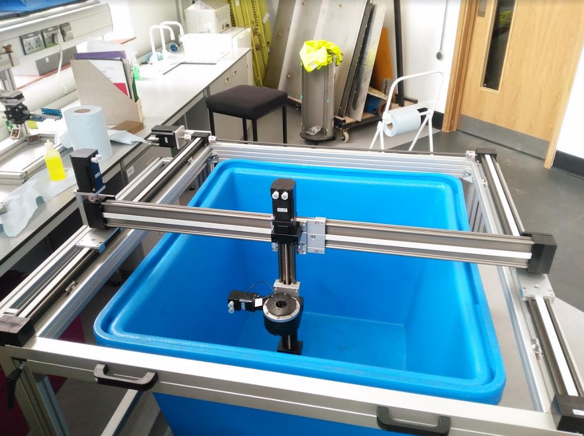

    I have put together a 4 axis gantry (picture attached) which I would like to control from my PC. I have 4 motors (NEMA 34, NEMA 23XL, NEMA 23 and a NEMA 17) which come with inbuilt encoders, but for now I will not be using the encoders. But may wish to in the future. The gantry is going to be used to drive a microphone around near a speaker.
    My current problem is that I am a little stuck on how to actually control the system. I have 2 power supplies (to run 2 motors each) and 4 microstep drivers (3 MSD752, and 1 MSD880 from Motion Control). I think I have powered each of the micro-controllers up, and the motors. But where I am getting rather lost is what data to send to the drivers.
    I have a parallel port which is connected to a RoutOut CNC break out board.
    From many of the videos and blogs I have seen people have been using MACH software to send data to the BoB (their BoB's look to be a lot fancier than mine however!) and then onto the drivers. My issue is that I can't install MACH3 software (which most people look to use, I can install MACH 4 however) and am not too sure how to send data to the drivers without it.
    I was wondering if anyone out there has any simple advice on how I could control the motors using the BoB I have.

    What version of windows are you trying to install Mach on?
    To use the parallel port driver, it must be a 32bit version up to Windows 7. Any 64bit version, or Windows 8 onwards, the parallel port driver will not work.
    Mach3/4 itself should install and run fine on any version of windows, it's just the parallel port driver that has the version restrictions.

    Hi Rob,
    First don't get too hung up on the Bob cheap or Expensive they all do the same Job which is providing an easy way to connect to the Pulse device. They don't actually do much more than pass signals thru and thou not recommended you don't actually need one at all.
    You could connect directly to the parallel port cable but it doesn't provide any isolation to the PC so not recommended as could damage the PC if anything goes wrong.
    The Pulse device in your case would be the PC parallel port which needs Motion control software like Mach3/4 which provide Parallel port Driver which interfaces with the PC.
    So put simply you need Motion control software like Mach3/4 or LinxCNC.
    In your Case I suggest using LinxCNC as it's free and can be run directly from Boot CD ( I think.? I'm not into linx others will correct me if wrong).
    To run Machine the process goes.
    Control software >>>Pulse Device(parallelport)>>>BOB (optional) >>>Motor Drive>>>Motor.
    Why can't you install Mach3.? is it because using 64Bit PC.?

    My other question was with the stepper driver device. I have powered it from the main power supply and then connected the motor. Remaining on the controller was Pul +, Pul -, Dir +, Dir -, and En +, En -. Do you happen to have a good source of info I could look at regarding how to wire this end of the system up?
    Can't give source where to look but I can explain it easy enough.
    The Motion control device provides OUTPUTS which it sends out signals and pulses required to tell the drives which direction and how far to move. These OUTPUTS basicly fall into two types MOTOR OUTPUTS for each Axis and General OUTPUTS which provide 5Vdc Signal.
    Each OUTPUT as Positive Negative connection.
    So DIR connection is MOTOR OUTPUT and controls the Direction to travel. This is done by sending 0V or 5v depending on direction.
    PUL Connection is the PULSE MOTOR OUTPUT which gives stream of pulses relating to how far to move.
    The En is Signal to the drive to ENABLE/DISABLE. Often this isn't used and left unconnected.
    If used this would be connected to General OUTPUT or could be controlled by external device like relay by sending 5Vdc.
    So in your case there will be Pins on the BOB which are MOTOR OUTPUTS and Some which are General OUTPUTS. If using the parallel port they tend to stick to standard arrangement. ie: Pin2 =XDir Pin3=Xpul etc.
    There will also be pins for INPUTS.
    Hope this helps.
