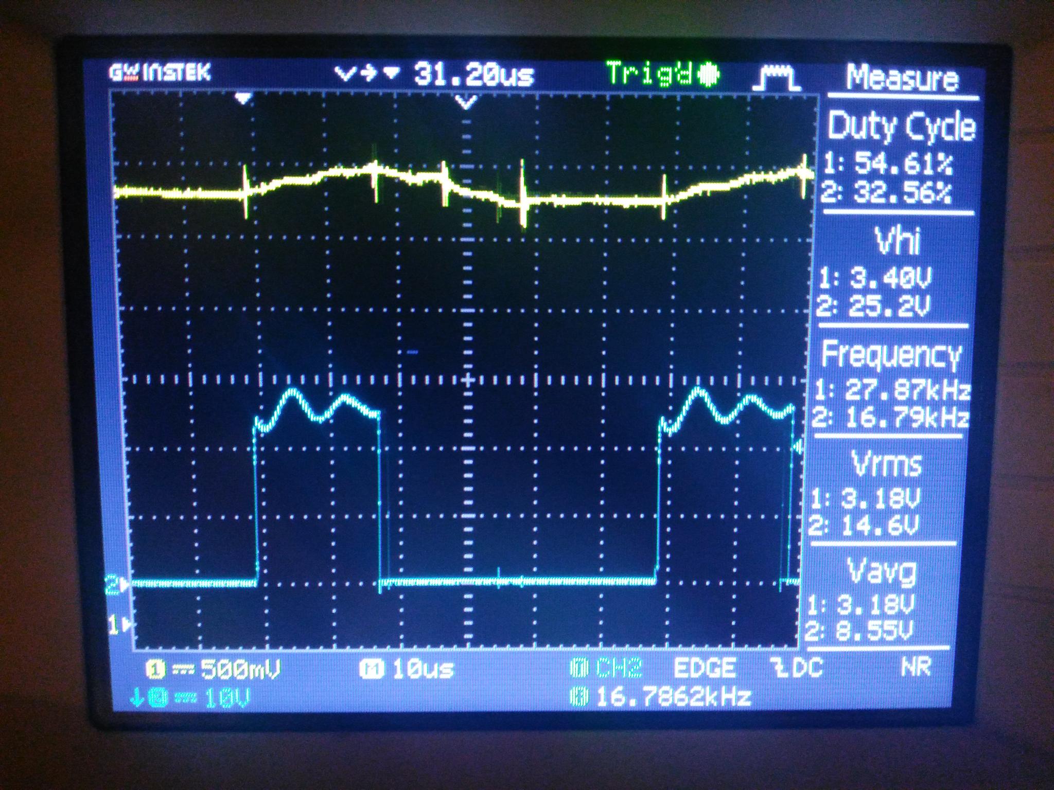

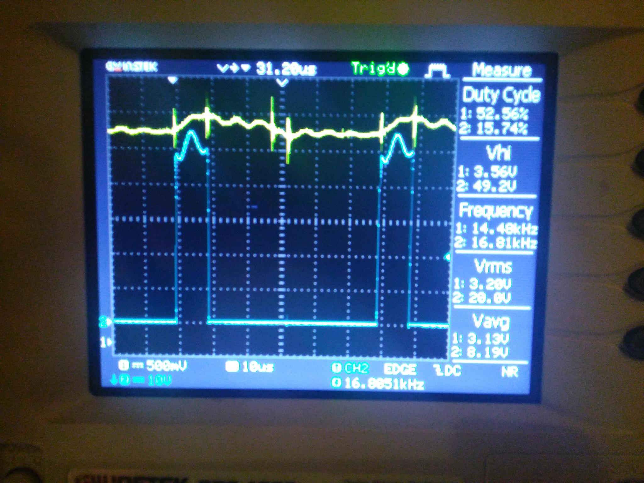

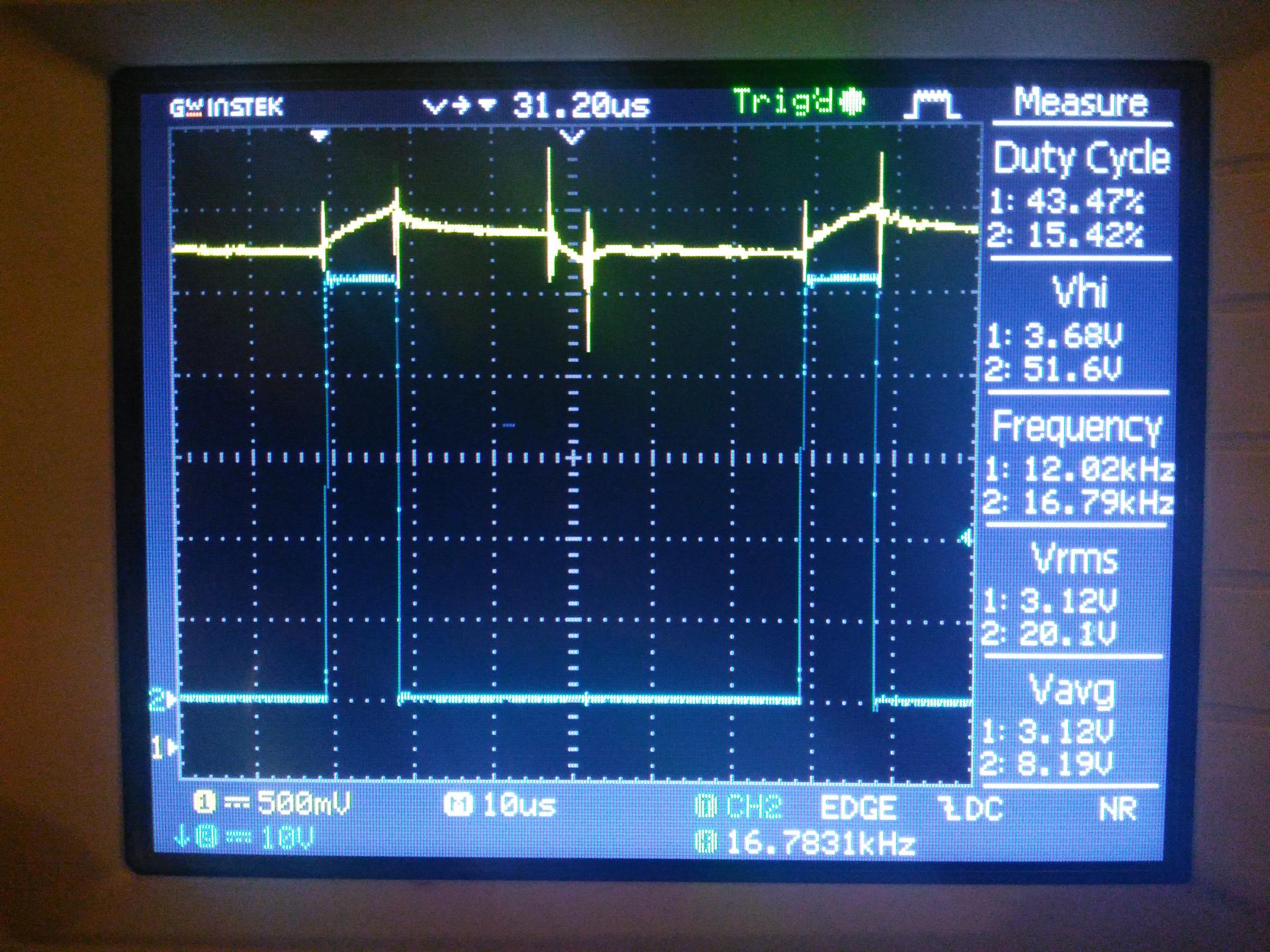

    Meanwhile, I just dug out these graphs I captured whilst repairing a stepper driver, showing the voltage across one mosfet Vds (blue) and the line current through the same (yellow).
    The first graph shows a normal situation - we see the current rising when the voltage is applied, and falling otherwise with the inductance of the motor smoothing this current. Observe how little overshoot there is on the voltage.
Name:	2016-09-26 00.04.49.jpg

    For this one I removed the dc-bus capacitor (can't remember if it was the small or large one) and supplied from a lab PSU. You can see the voltage and current now oscillating horribly.
Name:	2016-09-26 00.02.47.jpg

    Same again, but with a lower supply voltage - notice the current is the same (so the regulation is working) and the duty cycle has increased.
Name:	2016-09-26 00.03.06.jpg

    This doesn't tell us anything about sizing the supply capacitor, still it's mildly interesting...
