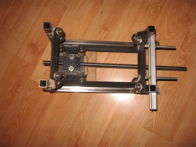

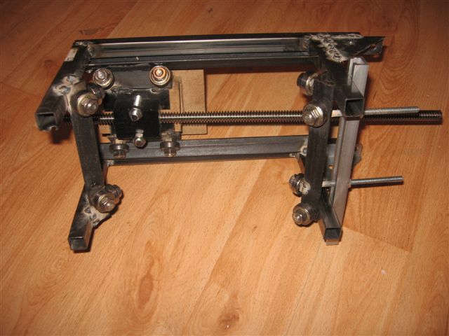

    been busy with work.. but found the time to to make a carridge for the gantry... made a mdf one to start...far to much flex so got out the mig pretty pleased with this one very ridgid

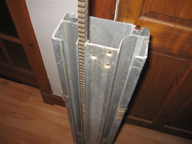

    went to local recycling yard today with some rubbish
    and found this alu Click image for larger version.
ID:	1200 its 180mm x 90mm
    this section is about 1200mm long , the other lenght is 5 meters
    long,
    (i see a big alu framed router) the bonus is the 6 meters of rack
    that was screwed to it, how do i determine the pitch of the rack

    hi tribbles
    been looking on the net and find rack classed as mod 1
    mod 2.5 etc etc all with different pitches , where do i measure from
    the crown to crown of the tooth, because pitch line was talked about
    that was a line about halfway up the tooth
  7. #27
    I would've thought that as long as you measure from the same point in the rack, then that's okay.
    When I was looking at racks, I looked at the mod sizes, and then looked for rack that was equivalent to that size.
    What's the size you have?
  8. #28
    jonm's Avatar
    Location unknown. Last Activity: 19-06-2011 Has been a member for 9-10 years. Has a total post count of 89.
    hi tribbles
    pitch from crown to crown 11mm , width at top of tooth 12mm, what is mod 1, mod 2.5 refering to
  9. #29
    I'm not exactly sure what the mod setting is, but I think it's the ratio of the number of teeth to the diameter of the wheel.
    I know that generally mod 1.0 means for a 60mm wheel, you get 60 teeth; for a 120mm wheel, it's 120 teeth.
    So, mod 1.0 would have 3.14mm pitch (circumference = pi*dia, dia = 60, so 188.49 circumference. Divide by 60 gives pi).
    If it's 11mm, then it's probably 10.995, or mod 3.5 (3.5*pi = 10.995).

    Hi jonm have a look at http://www.khkgears.co.jp/en/gear_te...pdf/module.pdf hopfully this will make it a but move clear.
