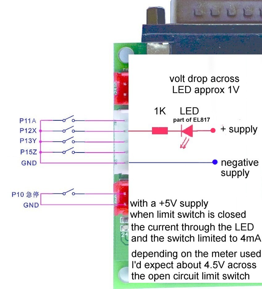

    It drops to about 2.8 - 3.0v
    Hi Kev
    the voltage drop on the printer port pin to 2.8 - 3V is too small
    you should have it dropping to near 0V when the switch closes
    assuming the opto-isolators LED is powered from +5V
    this is what I'd expect for the breakout boards limit switch input
    corrected diagram
Name:	tx14175 bob limit switch supply corrected diagram.jpg
    (arrow pointed to the wrong end of the 1K resistor on the original diagram)
    John
Name:	tx14175 bob limit switch supply.jpg
    Sorry my mistake, misunderstood what you said the voltage when the switch is presses is zero volts

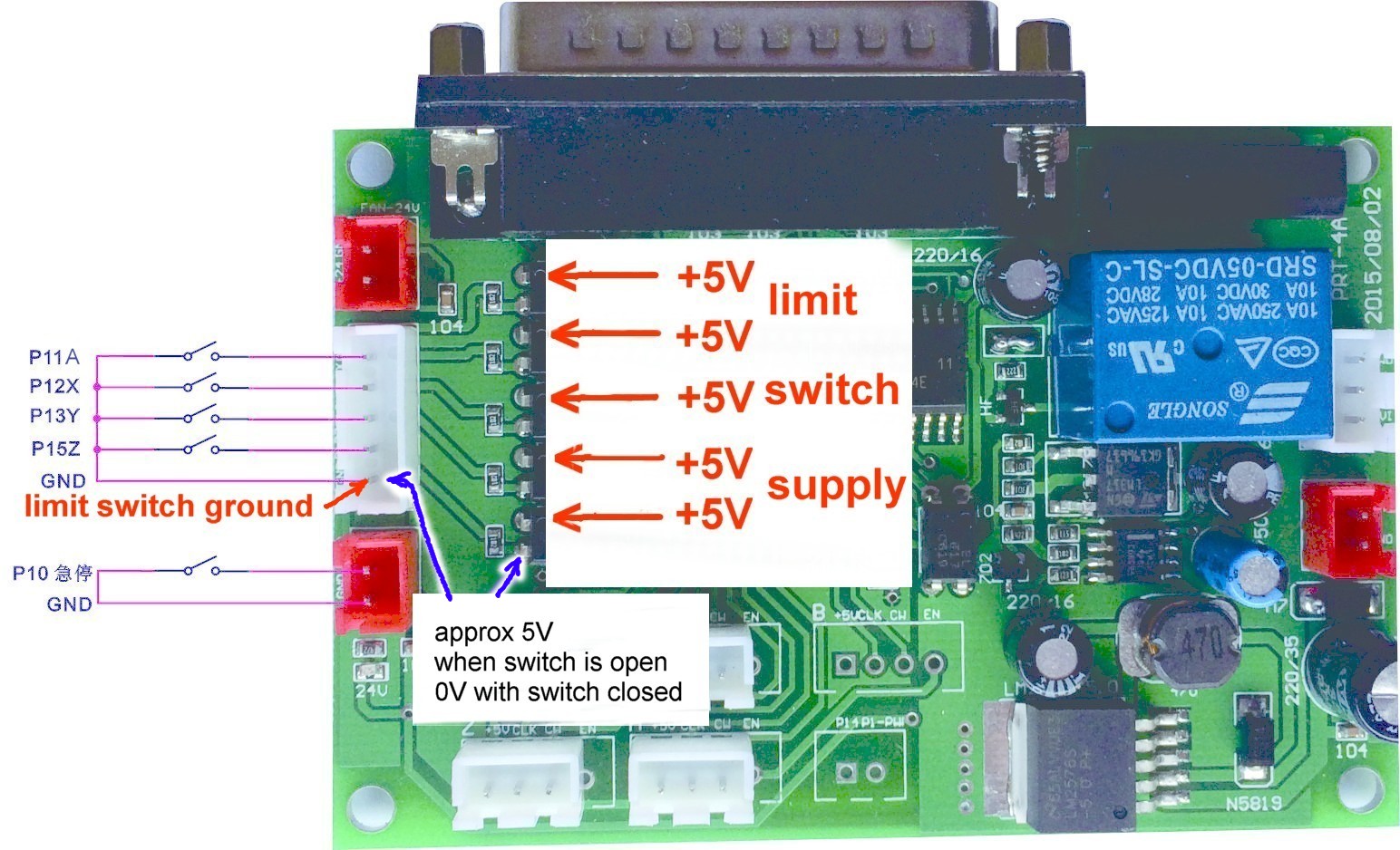

  4. #14
    Hi Kev
    do you use two seperate power supplies for the breakout board ?
    I have made a correction to the diagram in post 12
    this is how I expect the breakout boards input circuit to be
Name:	the breakout boards EL817 input circuit.jpg
    from the limited detail in the photo of the breakout board the two regulator IC's appear to be LM317 plus resistors = 5V regulator for the 74HC245D IC's
    LM2576S switching regulator = 10V regulator for the analogue VFD drive
    John
    Last edited by john swift; 22-03-2017 at 03:46 PM. Reason: add ref to LM317 & LM2576

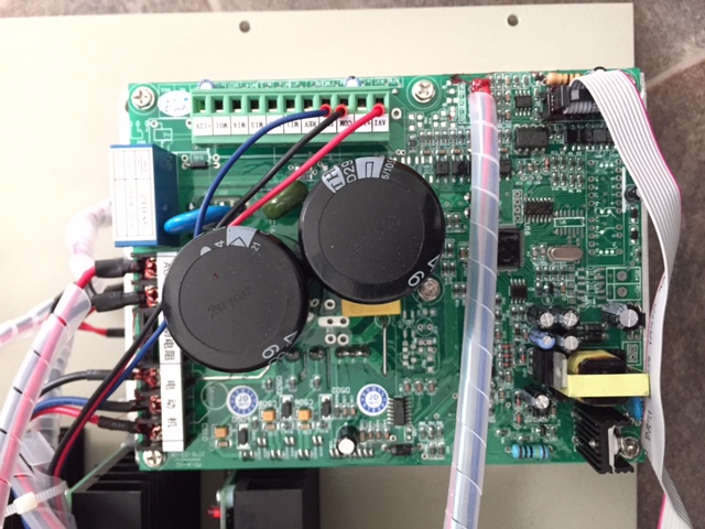

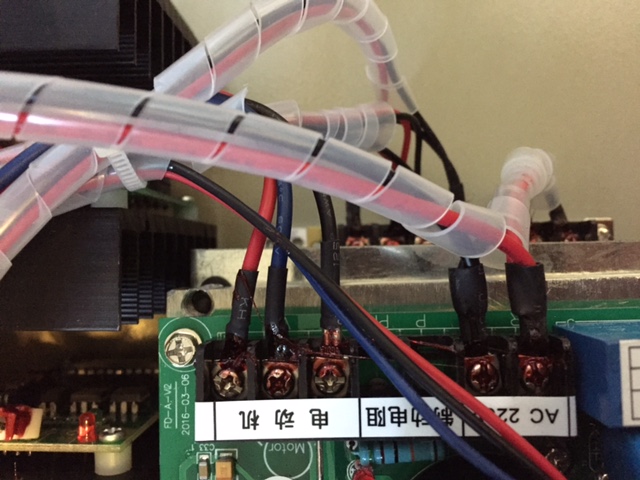

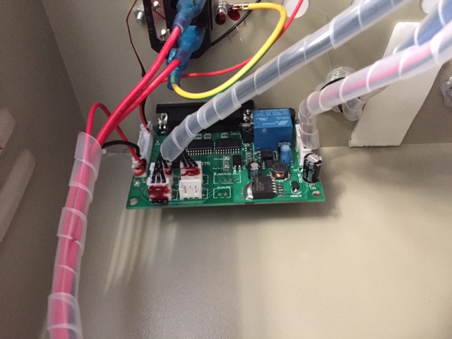

    I don't have a manual for the bob just for the machine itself. ive enclosed some photo's of the bob and the main board
ID:	21226   Click image for larger version.
ID:	21227   Click image for larger version.
