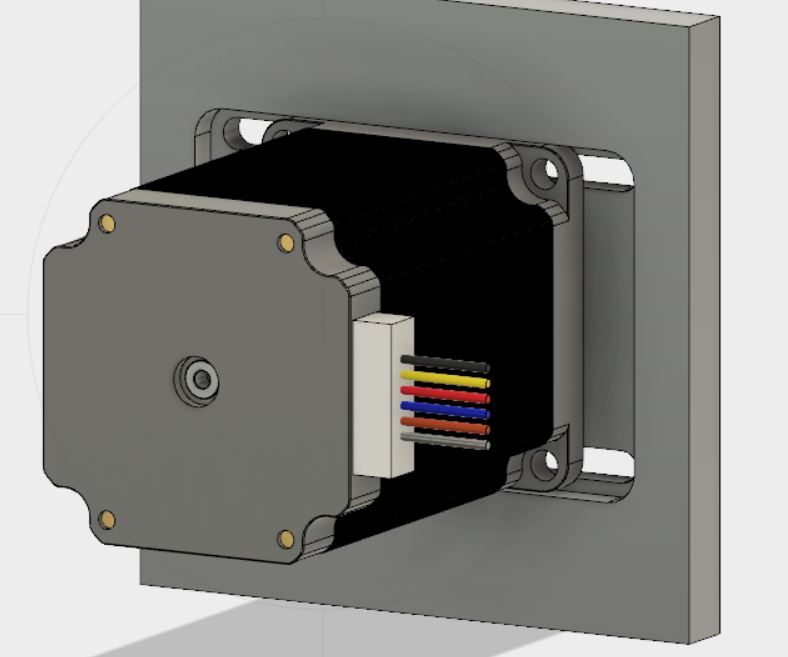

    yes I have that recess drawn in there it should be fine getting it in and then will just tap the holes on the motor
    I see the recess from the outside but it is usual to recess from the inside so that the motor sticks out more.
    Are you sure the the motor and shaft with the pulley on will stick out enough?

    thanks for spotting that i realised i hadn't modified the front for the motor to slide the rear is like this. I have left 5mm thickness. I like the idea of using grubs I was going to do something similar for the gantry but sounds like a good idea to do it all round and then like you say just bed everything with epoxy after that way you don't have to do all that sell leveling resin stuff. :)
    I keep hearing dean say adjustment adjustment adjustment which I think is exactly right for diy stuff
    all fixed will see if I can find some pullies to put on there but its the same as what I did on my other machine essentially so should be fine.
    Personally I would cut that down to 3 mm to get the motor shaft sticking out more.
  8. #58
    found some pulllys on line so had a play 5mm is just doable, going down to 4 would be plenty so will do that. even at 5 mm the pullly would go all the way on its just a bit harder to do the grub screw up.
