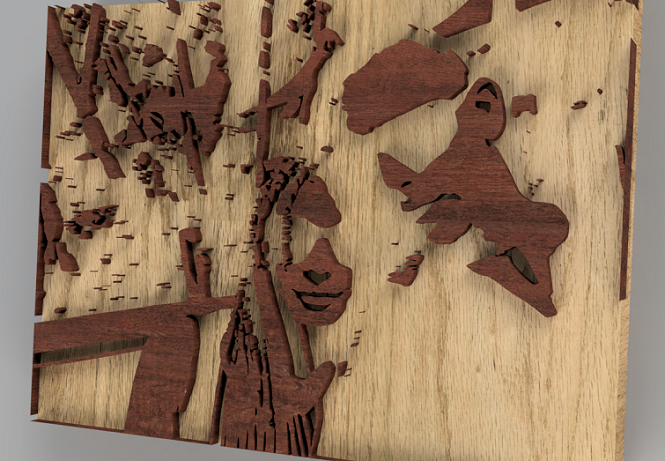

    The southpark figures are 3d illustrations?? The wood grain looks wrong to be real cuts?
    Renders from within Fusion 360. Shows how good they are, the need to check / question :-)
    Chaz is right there Fusion 360 models I then "coloured" using different woods in physical material.
    I was playing with different ways of making cad models from bitmaps
    The South Park figures were a simple spline trace over a canvas, Obey from They Live (Cracking film) I used Inkscape trace bitmap function to vectorize the image then used the SVG to extrude from.
    This is one I did from a photo of a friend this took a fair bit of processing in both gimp and Inkscape before I could get a usable extrusion will need cleaning up before I make it.
    Also going to check out image2gcode built into linuxcnc to see what engraving fun I can have ;)

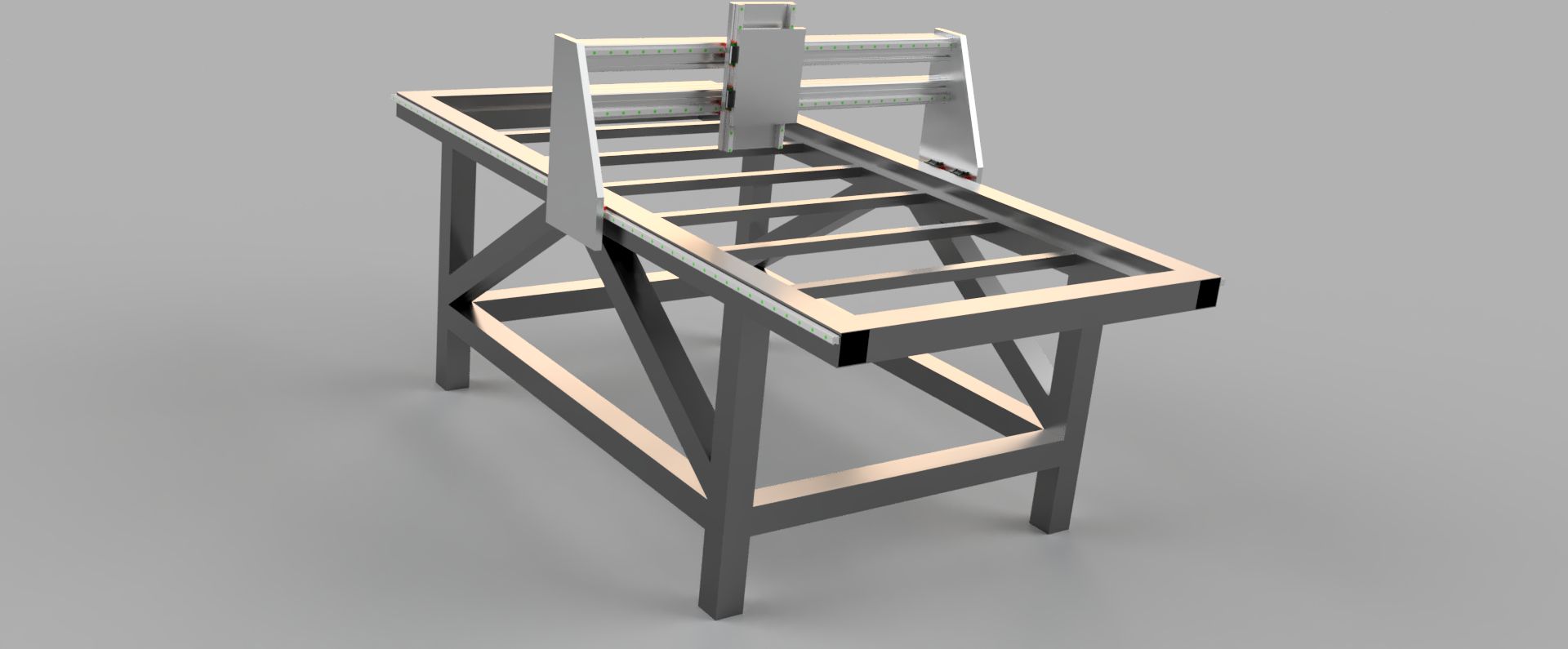

    Was playing in fusion only took 40 mins but not sure how I'd drive the long axis, I think needs to be R&P but have no idea how to set up a dual pinion anti backlash setup. The other choice 2* 2.7m 2510 ballscrew's with rotating ballnut's as at the length it's going to be a skipping rope if I try and rotate the screw.
    Does anyone know how I invert the axis in linuxcnc? Using the beta dual ballscrew on the Y so need to edit the hal or .ini to do it as the wizard doesn't support dual motors.

    Are you sure you need dual pinions if using r&p?
    I think the more common option is to spring load the pinion against the rack.. have you checked cncrouterparts design with a pivotplate or the mechmate as it uses similar design.
    Dave
    For twin screws you need Linuxcnc V 2.8 master if you want independent homing. I you want to reverse on of the motors then you can just swap the phases around on the motor.
    What version are you using?
