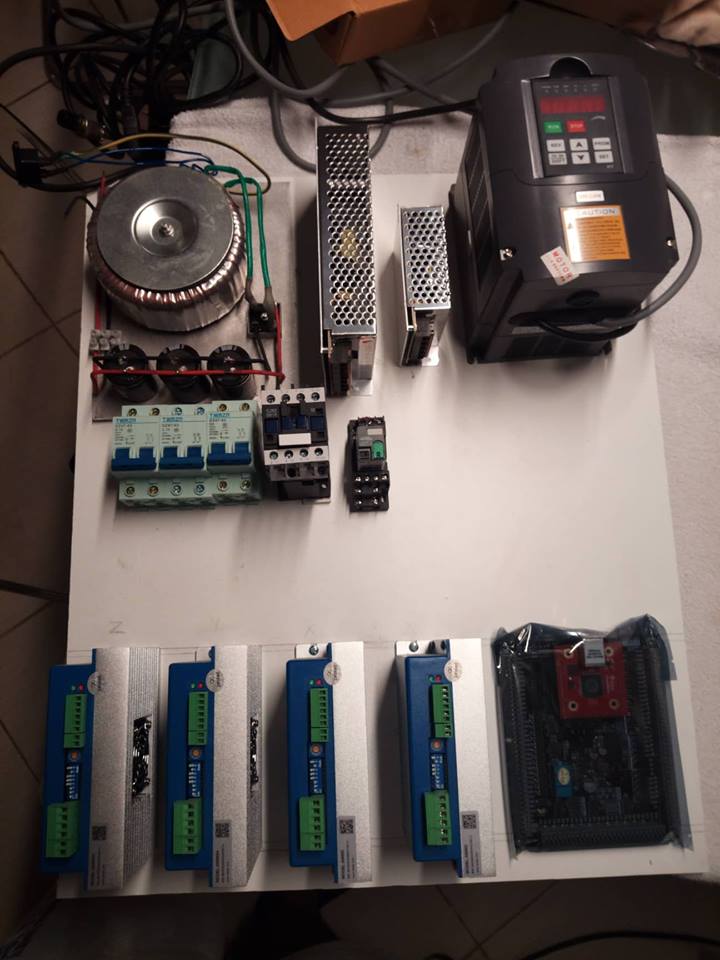

    I am thinking to place the parts that way in the control box,will it be any problem with the positioning of VFD?
    If I remember correctly people puts shielede cables to the signal wires ,wires that goes to controllers, motors etc. right?
