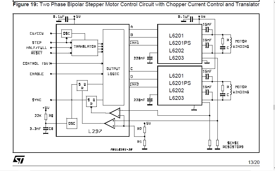

    Quote Originally Posted by john swift View Post
    Hi Dave
    going by what looks like two seperate H bridges on your stepper drivers
    I guess instead of the usual L297 + L298 chip set
    your stepper drivers use a L297 & two L6203 H bridges
    Attachment 21893
    John
    Hi John, my two H bridges are both L298N coupled with a PIC 16F87 I/P.
    If it's the H bridges that need replaced that's no big deal but if it's the PIC won't I be up the creek without a paddle? What is actually happening is that when I jog the motor in one direction then stop, then jog in the same direction again, the motor doesn't always go in the right direction.
    David
    Hi Dave
    I'm assuming the board has a L297 driving the two L298 ICs
    they must of connected the two H bridges inside the L298N in parallel to make a higher current bridge
    until CDE are back in business a faulty PIC is a problem
    unless your lucky and the PIC program is not protected so you can copy a working PIC - a bit of a long shot I know
    for now I would swap the faulty drive with a working drive to prove the driver is the problem and not the control board
    changing the switch settings that determines which axis commands the board responds to may be enough instead of physically moving the board – just avoid jogging into an end stop
    with a logic probe you monitor the L297 direction pin to see if its the PIC or L297
    John
    Hi John
    Thanks again for your help. I've swapped the faulty drive for the other which is known to be ok and it is working just fine. If I could just find a CDE X641SC stepper conversion card then I'd be laughing. I'd be able to fit other drivers. I'm really struggling with this but I don't want to harass the guy for the drives if he is in hospital!
