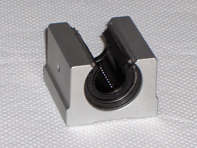

    just a question
    the supported round rails ( not hiwin etc)
Name:	Ondersteunde as lager.jpg
    those carts how many kg can they carry , because my gantry is becoming very heavy.
    My rails are the SBR 20

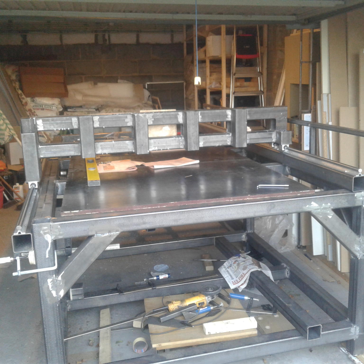

    i got a lot of work done this weekend
    the machine has finaly got the rails mounted and they run very smooth
    the gantry rails mounted
    everything is welded and made grinded for paint
    next weekend i will paint the machine
    then i need to move the machine on its right place level
    mount the r&p, the motor's, drivers etc so a lot of work but i am very happy with the result so far
    a couple of my friends where shocked to see this

    It starts to look very nice. There is something in that metal structures that i like...
