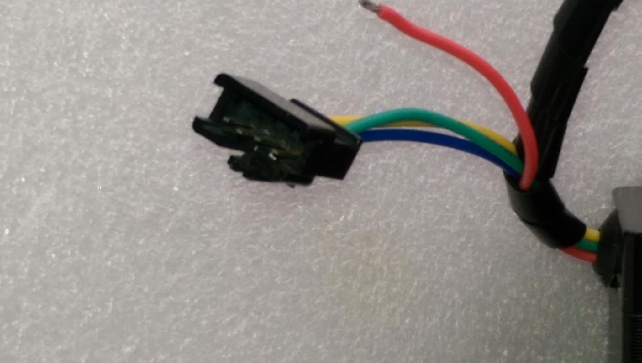

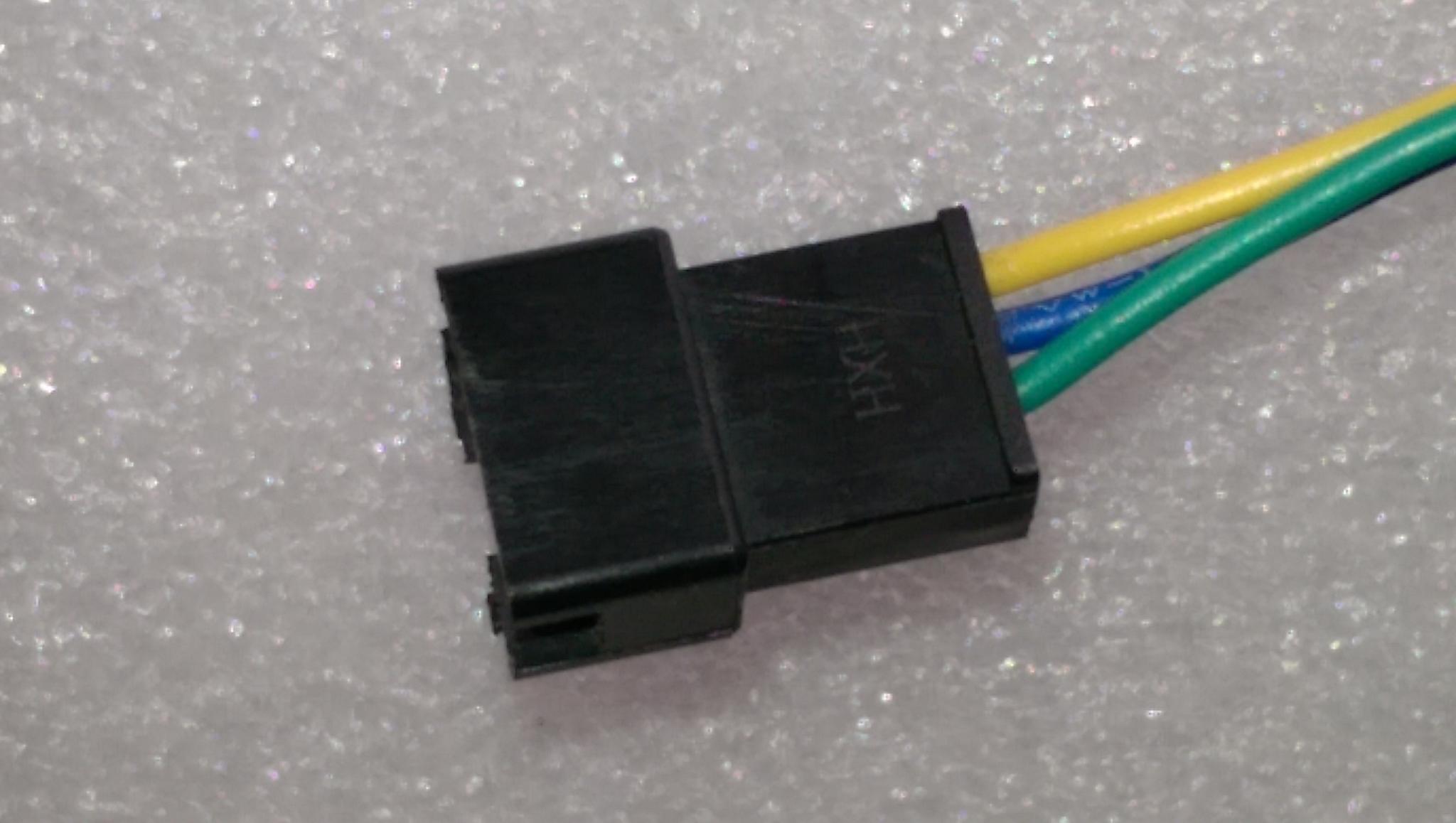

    Apart from the other issues I'm having the red wire on the Z axis stepper motor plug decided to fall out.It doesn't look as though it was crimped at all? Any suggestions as to how I can remove the pin to reconnect it? I've tried a ground down small instrument screwdriver in the square hole above the pin but so far no luck.

    Thank you for the suggestion. At the moment I am considering returning said machine and do not want to do a permanent repair. I know I have to bend a small tab to release the pin but unlike the female plug the tab on the male plug is hidden from view. Anyway I'll keep trying and see what happens.

    It will not of been crimped correctly. A couple wires on my 3020 fell out just trying to get the connectors apart, and a few more came out with just a slight pull.
    It will probably need a release tool with a curve/hook in it to press the release tab.
    Personally, I'd remove all the connectors, and join the wires directly. I used good quality butt crimps on mine.
    Well I eventually managed to release the pin and have reconnected the wire. At the moment I am in two minds whether to return the machine or keep it. If I keep it then I will rewire and upgrade the controller/drivers to something more reliable. Waiting for the vendor to provide a fix? for the noise/vibration from the X axis. Hoping for a satisfactory outcome.
