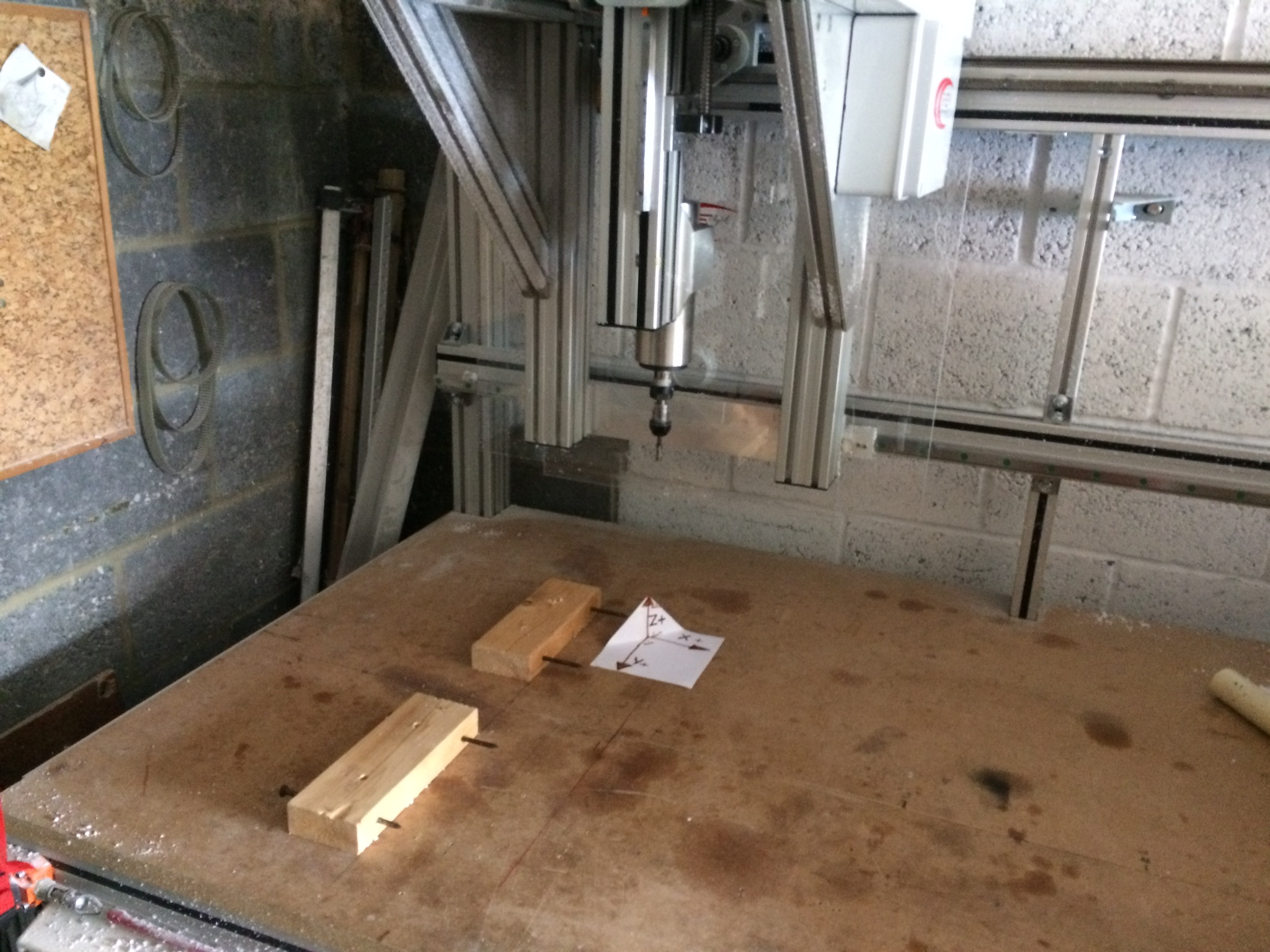

    So I built my first cnc about 2 or 3 years ago now and it has only just come to realise I think I have the y axis going the wrong way it's just never mattered as I have only been cutting symmetrical surfboards with it.
    I think I got it wrong because of the design of the machine being a cantilever style and it made sense to me to have it home in the corner as in the first pic and have the axis set up like the second pic but should the y axis in fact be the opposite way?

    Charlie as i know your build (as i made some of the parts for you) It looks like your orientation is correct in my book ( as you stand in front of the machine). In the case of your machine the longest travel is left and right, this would be your X. The head traveling away from you and towards you is your Y. The Z Axis as always never changes and is is the head up and down directions. This is the standard configuration for any milling machine. In the technical sense the X and X doesn't really matter as long as you know what each one is. As i described above is the standard configuration that's been used for the last zillion years.

    thanks for the reply and the parts :) im happy with the x y and z it more the + and - directions that I think I have wrong?
    Basically I have been learning to use fusion 360 and it came to me when trying to do the cam on my machine that I could not get the origin going in the right direction.
    I agree with you, Charlie - normally Y would go in the opposite direction. You could still home to the same position, but configure Mach3 (if that's what you are using) to set Y to its maximum value rather than zero.
    What you have would be called a left-handed coordinate system, but most software assumes a right-handed system. Very easy to change in Mach3, though, so well worth doing so it all agrees with Fusion 360 and saves a lot of confusion downstream!

    It's not about which is the longest axis, it's about orientation. The one parallel with your belly is the X, the one moving AWAY from your belly is Y and the one moving towards your head from your feet is the Z. Plus (increasing value) is moving from left to right, from nearest to farthest (away from you) and from lowest to highest, assuming the lowest is always zero. Just look in any maths book, it should be like that in every one of them. ...but you may have another book, the one with a printing error, because his orientation is indeed wrong regarding Y. But it really isn't a big deal, except that it is a bit confusing if he is learning the wrong way or talking to other people about axis orientation. I don't know where Y is increasing when moving towards you, and I really don't think it's been like that for any number of years, let alone zillion...
    thanks for all the help I think I have it all switched around now and working in the correct directions.

    For direction, you have to think about the cutter moving in relation to the workpiece.
    On a moving gantry machine (i.e. typical router), Y+ the gantry moves away from you, and X+ the spindle moves to the right.
    On a moving table machine (i.e. typical mill), Y+ the table moves towards you, and X+ the table moves to the left.
    Z is easier to remember, as it's simply whatever way moves the cutter vertically away from the work, but that may mean lifting the spindle, or dropping the table.
