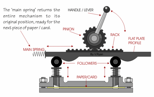

    I was thinking split the plate, fix the top, pivot the bottom, use a bigger belt (probably) and design in a spring loaded cam follower feature that would auto adjust the timing belt tension as the pinion mechanism/plate adjusts in real time.
