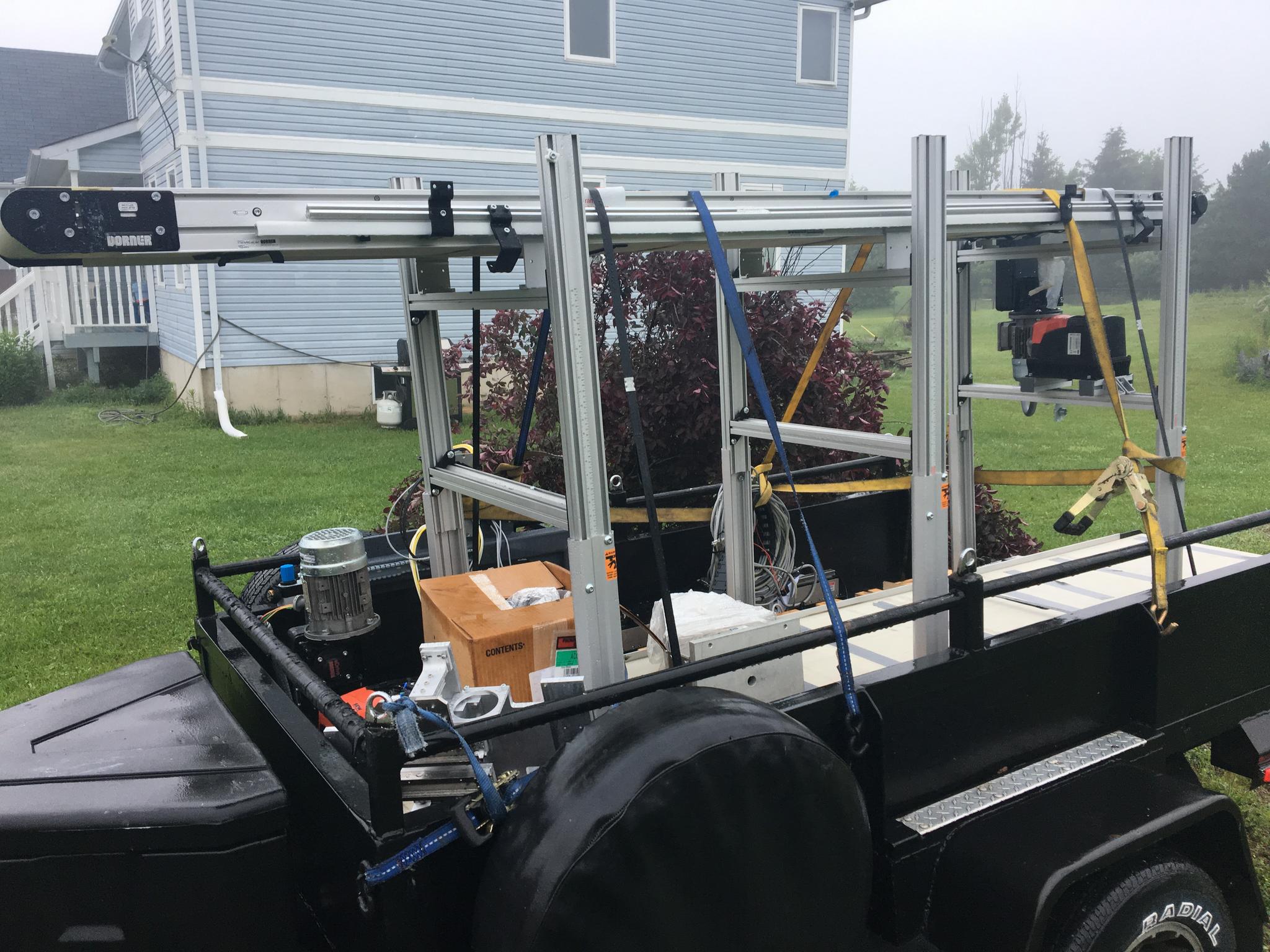

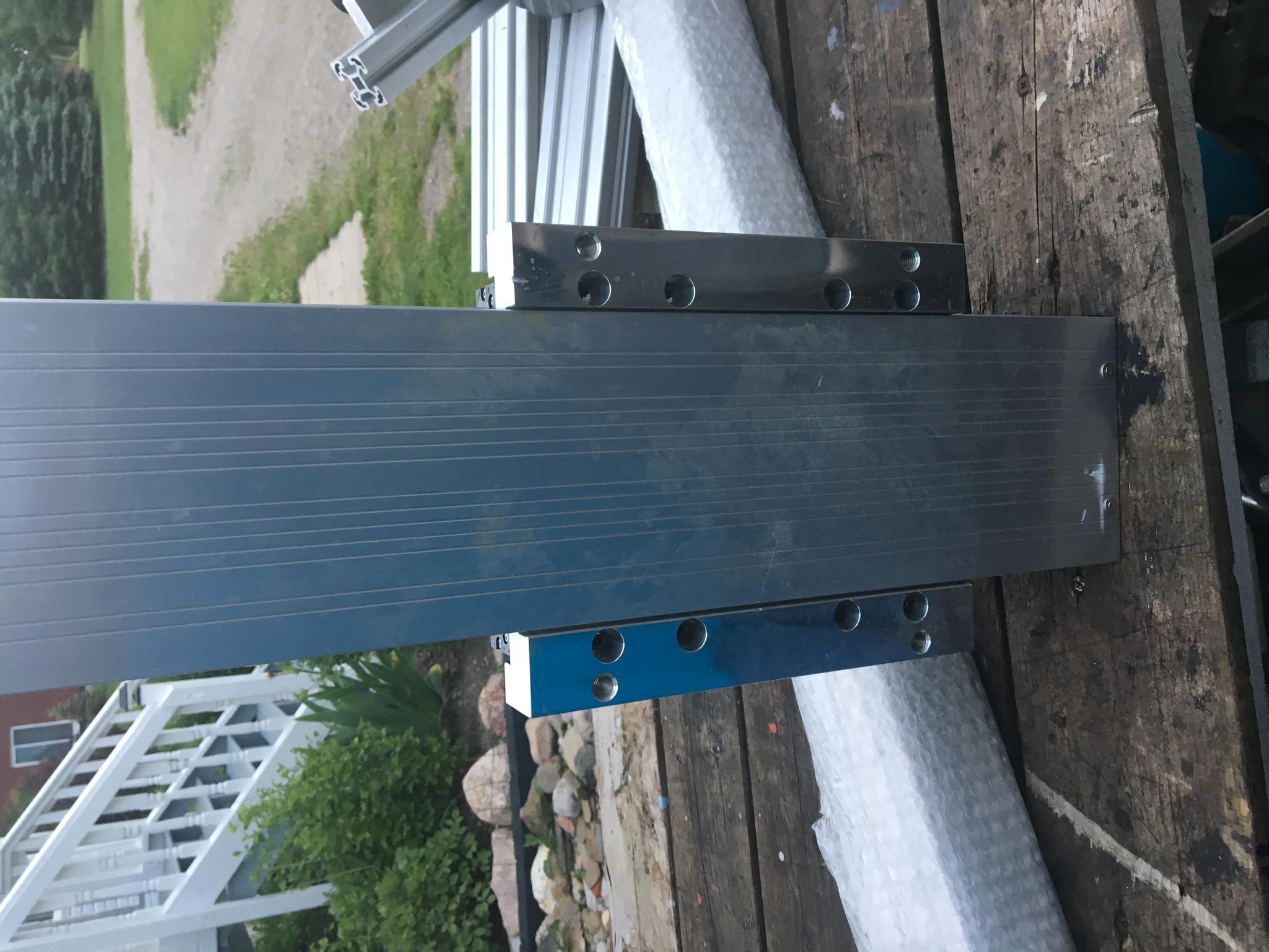

    Thanks for the warm welcome and great read on your build.The idea so far as I am working with a limited budget is to get stuff donated to the school. Than see if I have to purchase the ball screw, spindle and possible linear rail.
    So far I have had some excellent support from local companies.The Z axis head is a complete " THK GL20N" which is way cool!I have posted some PICS of the parts so far.
    Size 1000 x 1000 ( aprox.)
    Cut aluminum, wood, lexan, light plate.
    Linear slider rails ( have a lot donated already)
    Spindle I was looking at was 3 HP water cooled.

    Not sure on good source for the ball screws and what ratio to use??( 1605???)
    Thanks Dale
