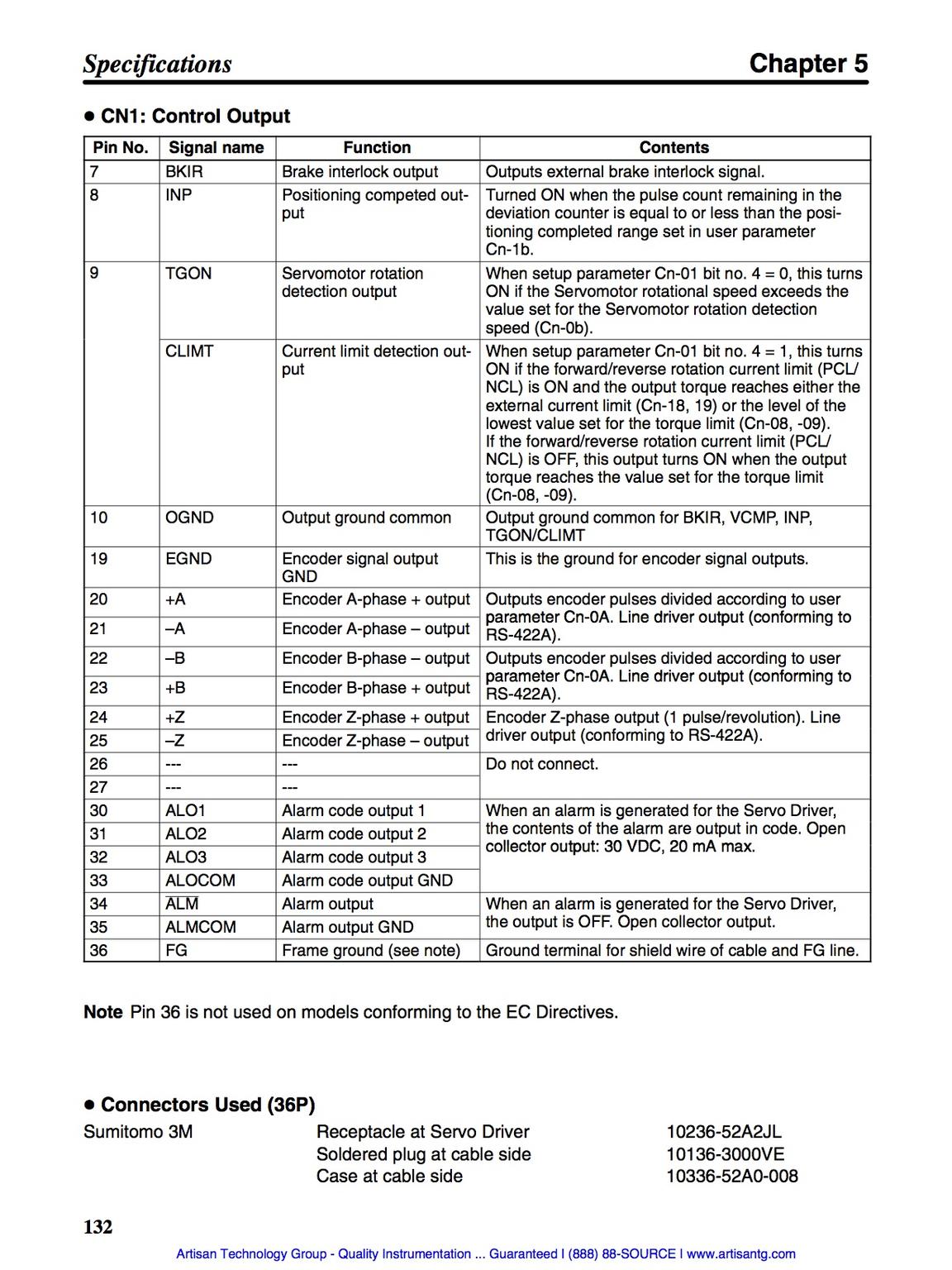

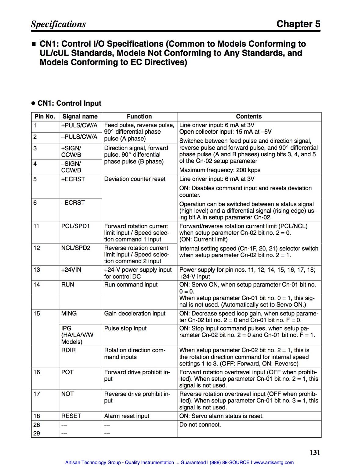

    I have Omron R88D-U servo drivers and a R88D-U motor to test it all with. I've connected the motor and the encoder. However, I can't get into the servo driver software as for some reason the OMNUC interface software and the Yaskawa software doesn't like my USB-RS232 port and won't connect with the servo drive.
    Anyway, I'd like to try running the servo driver from my BOB using the current settings, but I can't get to the bottom of what I need to connect. It would seem logical that I only need four or five wires to give the driver an enable signal and step and direction pulse, but I'm buggered if I can see exactly what I need to do
    Attached are the pin-outs from the driver interface plug.

    Having looked at this a bit more, am I right in thinking that 1 and 3 relate to step and direction on the BOB and that 2 and 4 will be ground? What about enable?
    I realise the second page I attached was not relevant.

    You really need to know how the drives are set before you can test them.
    However a quick look at those pinouts, and if you apply all the required power inputs, activating the RUN pin should at least get the servo to lock, however that depends on the related settings having not been changed from the default where activating the pin enables the servo.
