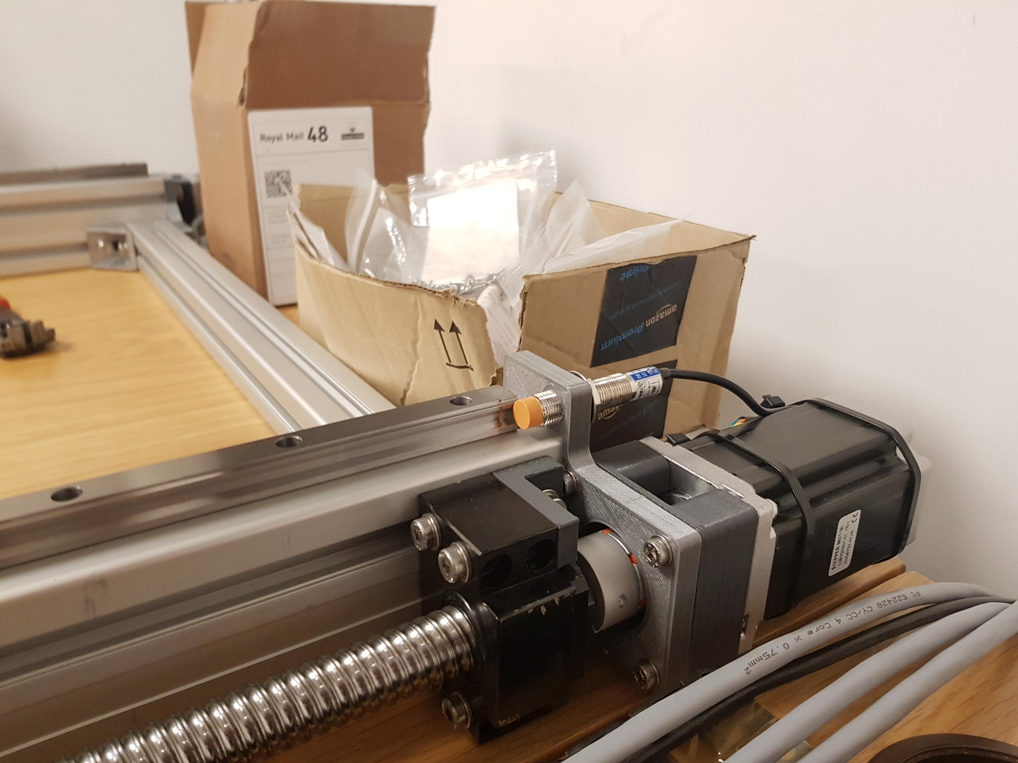

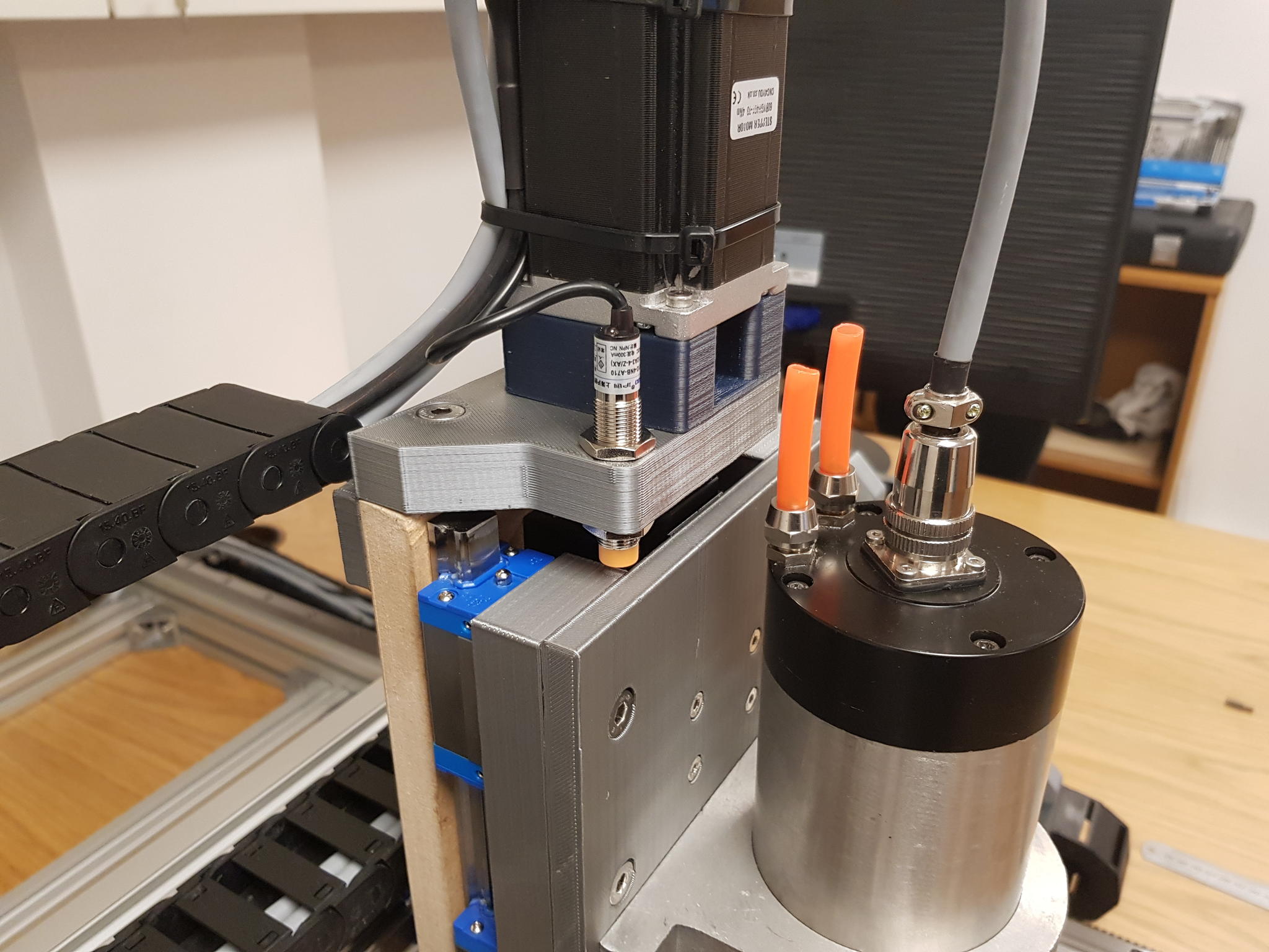

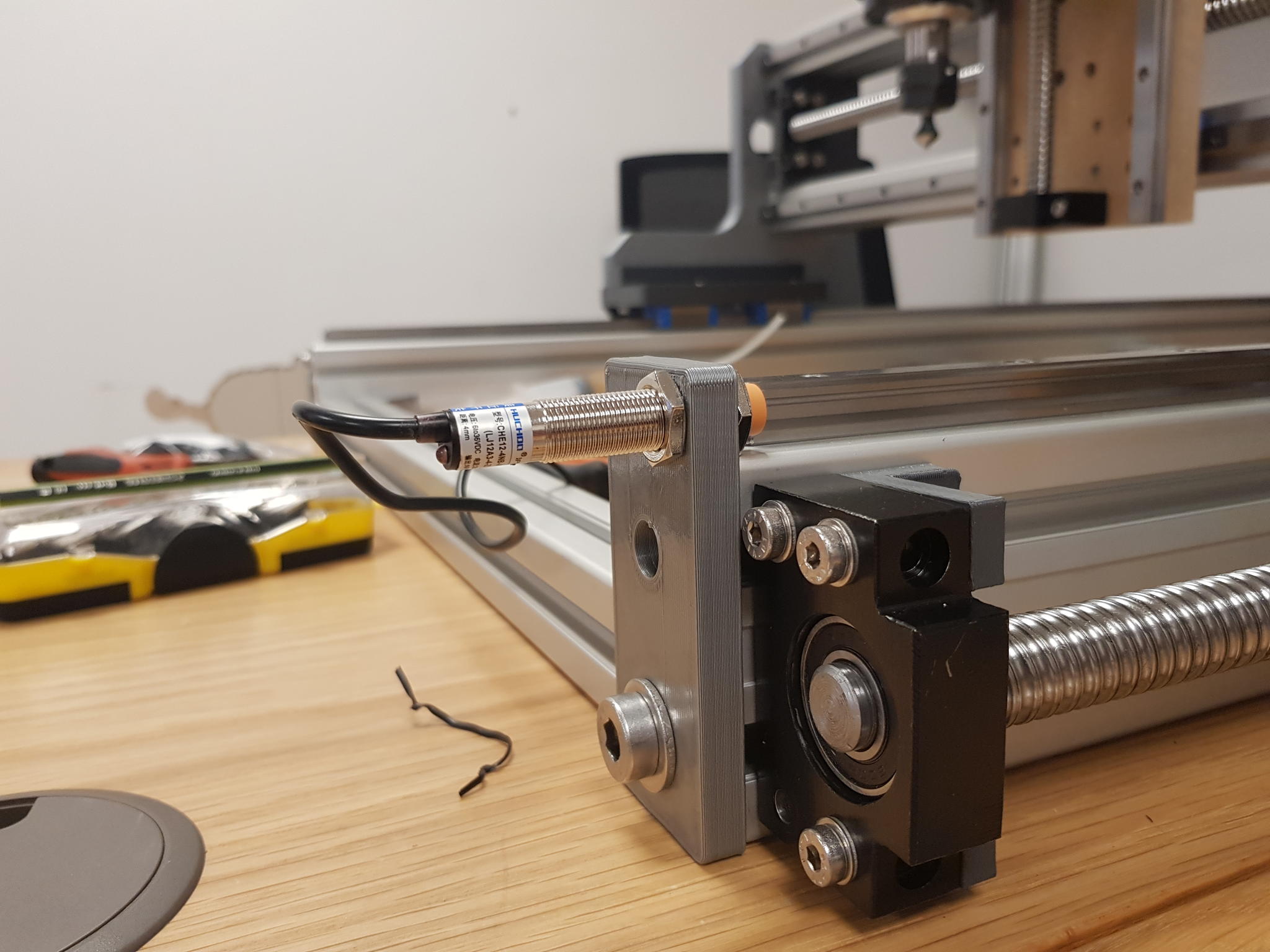

    Havn't had as much time as i'd hoped the last few weeks to get much done, got all of the stepper wiring done, the cable drags turned up which meant i could get the lengths correct for the cables. I now have all Axis moving which is a nice milestone in the build. Ordered some Inductive Proximity sensors to act as limit switches, they seem to activate about 1.5mm from Aluminium, which should be ok for me. I need to do some research on the controller, as it has Terminals for Min, Max & Home for each Axis, what would be the scenario where you would have Home different to Min? Do some machines have Home at the Max or maybe Bed Centre?

    Also need to order some Screw Connectors for them.

  12. #99
    Alex
    Have you thought about the switches, the way you have them is asking for them to get squashed they might be better mounted so that they slide over the target
  13. #100
    Alex
    Haha don't say that and jinx me :D - Do you mean so that they would be similar to how I have done the Y Axis ones?
