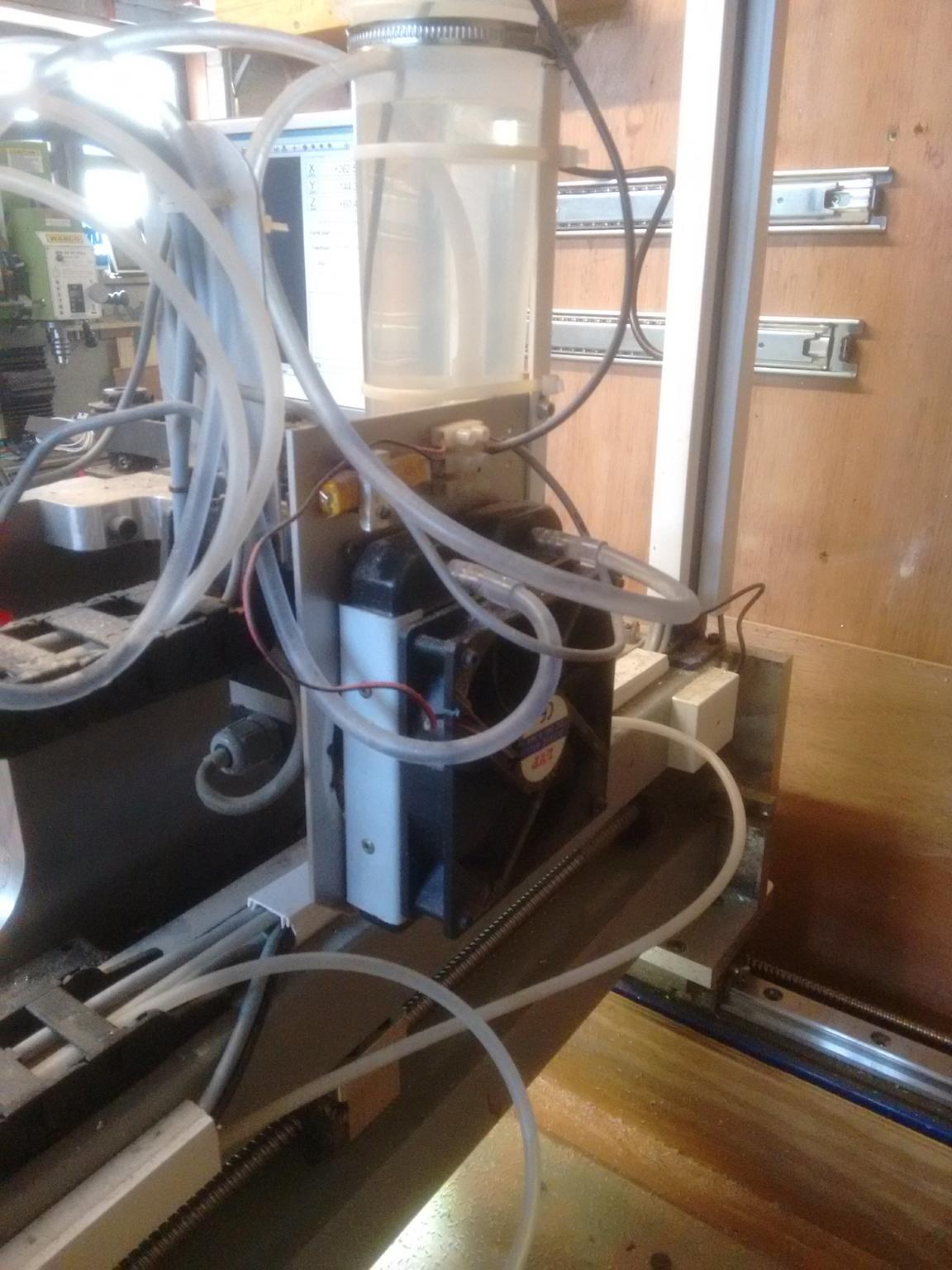

I use something like this on the back of the gantry with less that 1 ltr of water. https://www.aliexpress.com/item/80mm...ceBeautifyAB=0
but you can get one with a little bigger and fit a 120mm fan.

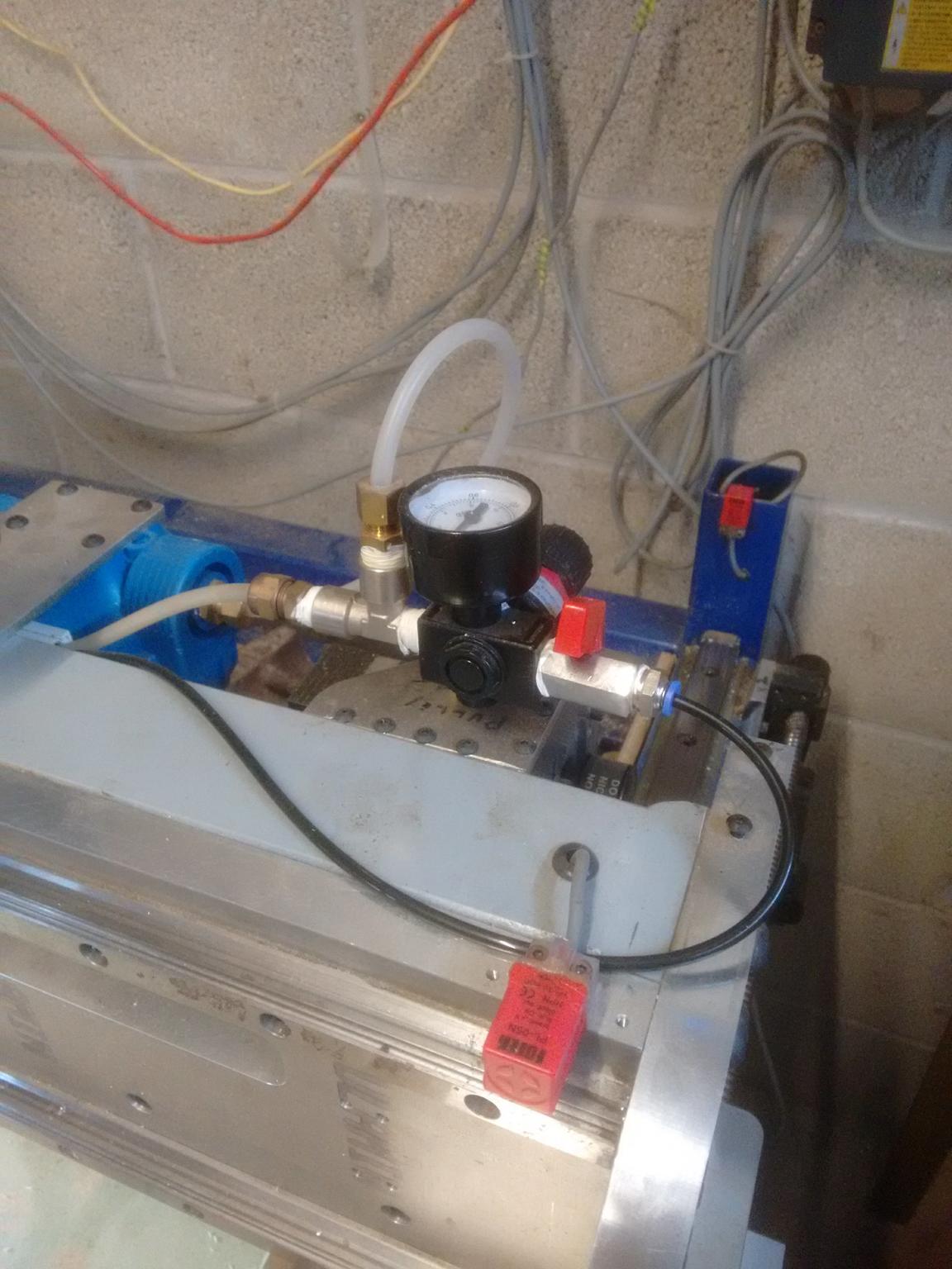

re the 4mm tube I find that more than enough flow. I have it at about 8 bar and regulate it down on the gantry...Clive

11-04-2018 #128Q1
I would like to know about pc pump radiator setup on z assembly for spindle cooling, is it an ok option?
The black tube into the reg. is feeding the air into the blue water filter with WD in it (just behind the gantry) and also to blow the chips away. You can see the cooling water 1Ltr on the gantry.
The fan is 120mmLast edited by Clive S; 11-04-2018 at 03:32 PM.
