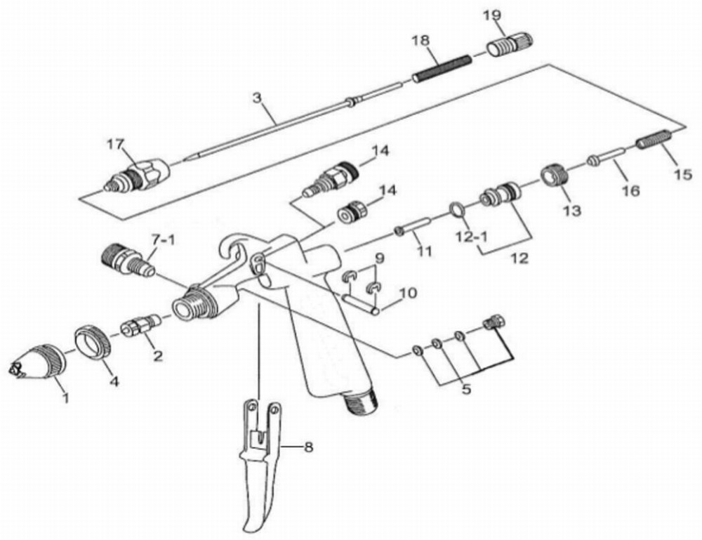

    On all of my 4 spray guns, you do not need to fully disassemble to take out the needle. You just fully unscrew the paint volume screw, remove the return spring and pull out the needle. This K3 looks as though it is the same, so why the problem?
    @ cropwell,
    This K3 Chinese copy is different. To explain in details (have a look into the attached picture):
    • The paint volume is regulated by the screw marked with the RED circle. This screw cannot be fully extracted, but no problem about it, since it does not effect cleaning process.
    • The screw marked with the the GREEN circle, only determines how far the trigger can be pulled. For example, you can preset a trigger pull to the middle, in order to achieve a specific paint cone and remain as is. This screw can be fully extracted, but there is no effect to anything else, since the trigger spring is secured by the screw marked into BLUE circle.
    • The part marked with the the BLUE circle, guides the needle and secures the trigger spring. Normaly (as happens on genuine Iwata model) this part should be possible to unscrew and release the spring AND the needle by gently pulling back. Unfortunatelly, this part, CANNOT be unscrew because it is part of the aluminum frame. The entire "screw" appearance of the part, is just decorative - not functioning! Therefore, the trigger spring and needle are traped there and cannot be extracted!
    I hope the above explanation, can clearly give a picture of the problem.

    Quote Originally Posted by Philipp View Post
    By the way, this is how the spray gun should be disassembled, but I guess that the manufacturers of this Chinese-made piece of crap (previously presented as "the purchase of the Century"), did not bother to think how this tool will be cleaned after use! Typical Chinese-made useless crap for once paint and throw to garbage.

    Looks like I am just going to have to buy one, just for the hell of it. It would make sense for part #17 on the diagram to be left hand thread. Just a thought. These Chinese must be damned clever if they can assemble the needle assembly with part #17 in the body already.
    Well, I do not know if they are "damned clever to assemble the needle assembly with part in the body already", but I know that they are smart enough to fluid the market with cheap copies that do not work.
