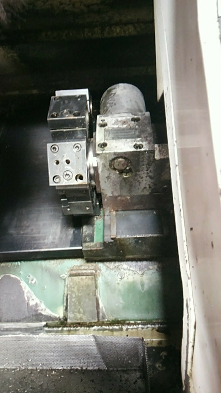

    Thanks MC - i don't know which turret sorry - but attached is a photoClick image for larger version.

    Not sure what that is. I wonder if it's the earlier Barfuldi RH turret.
    Have you tried swapping two phases?
    Not yet, I assume it's a case of four terminals that mount into the smaller side cabinet thing and swapping their order?

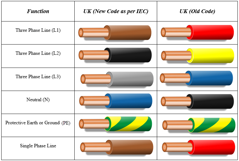

    I would tell you what colours to look for, but the standard colours changed a few years ago, so Neutral can be Blue (new) or Black (old), but blue is used for a phase colour in the old colours, and black in the new colours.
    I've attached a diagram of the colours, so you should be able to identify what you've got. Internally the 3phase wiring will most likely be all blue or black, but any external wiring should meet the relevant colour standard, which should be the old colours, but if it's been replaced, it may be the new colours.

    Thanks, I'll use a trusty multimeter (very carefully) to figure it out
