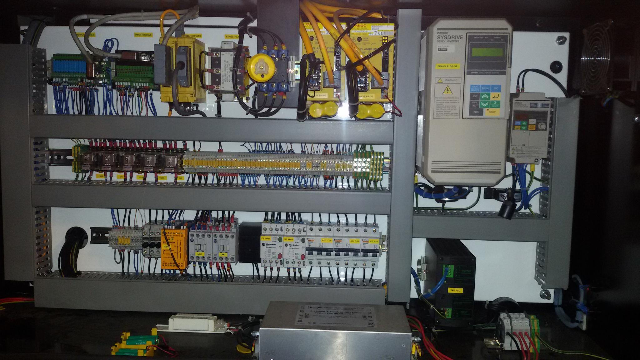

    Couldn't find that breaker in mine, don't suppose you could send me the wiring diagram that you have could you?
    Think it is definitely the fan though, I can feel it vibrating when put my hand on it.

    Lives in East Lothian, United Kingdom. Last Activity: 23 Hours Ago Forum Superstar, has done so much to help others, they deserve a medal. Has been a member for 9-10 years. Has a total post count of 2,908. Received thanks 360 times, giving thanks to others 8 times.
    I wonder if the fan's fed from somewhere else on yours.
    Fanuc OTA diagrams can be found at http://denfordata.com/bb/viewtopic.php?f=15&t=2337
    However, I just looked at this set - http://denfordata.com/bb/viewtopic.php?f=15&t=2508 and the spindle fan is single phase powered via Fuse 4. However those machines appear to have 3 phase + Neutral input, whereas the older ones were only pure 3 phase. Do you know what power input your machine has?
    I have the 3 phases and the neutral on mine, removing F4 fuse didn't stop the fan. But removing the F2 fuse did though. Now just got to find the time to remove those internal sliding cover/panels to see whats going on.

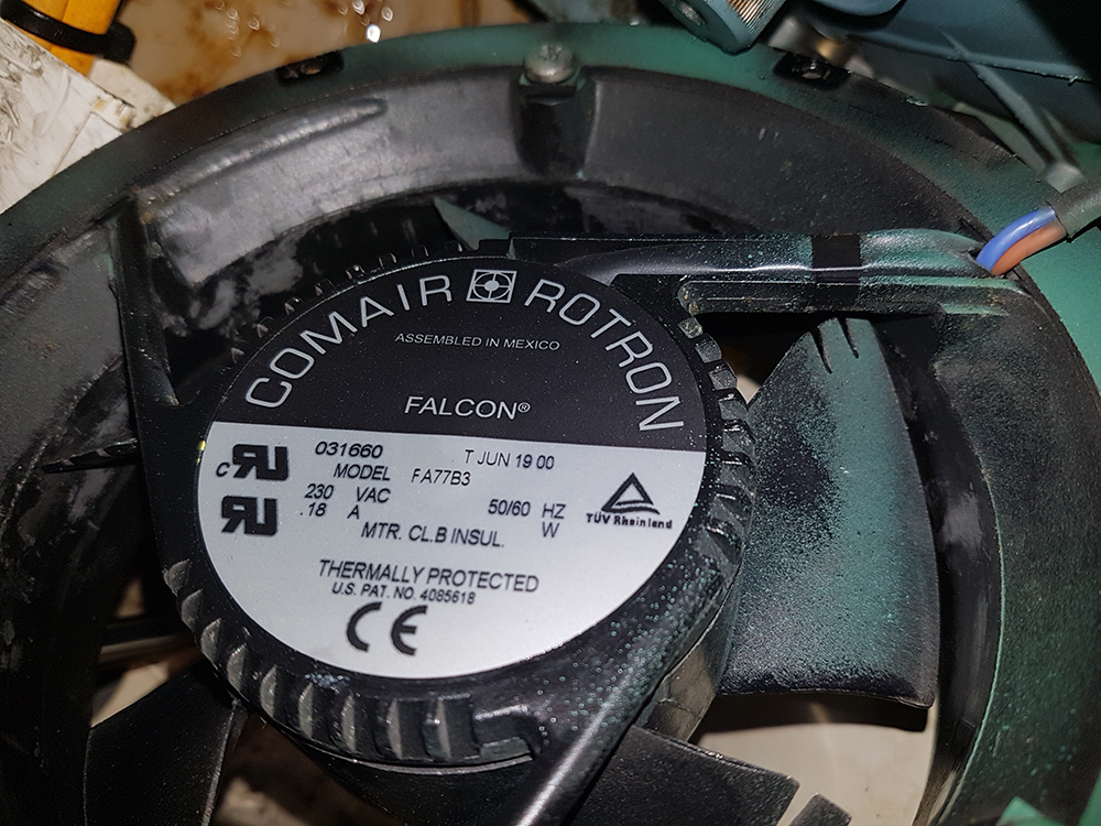

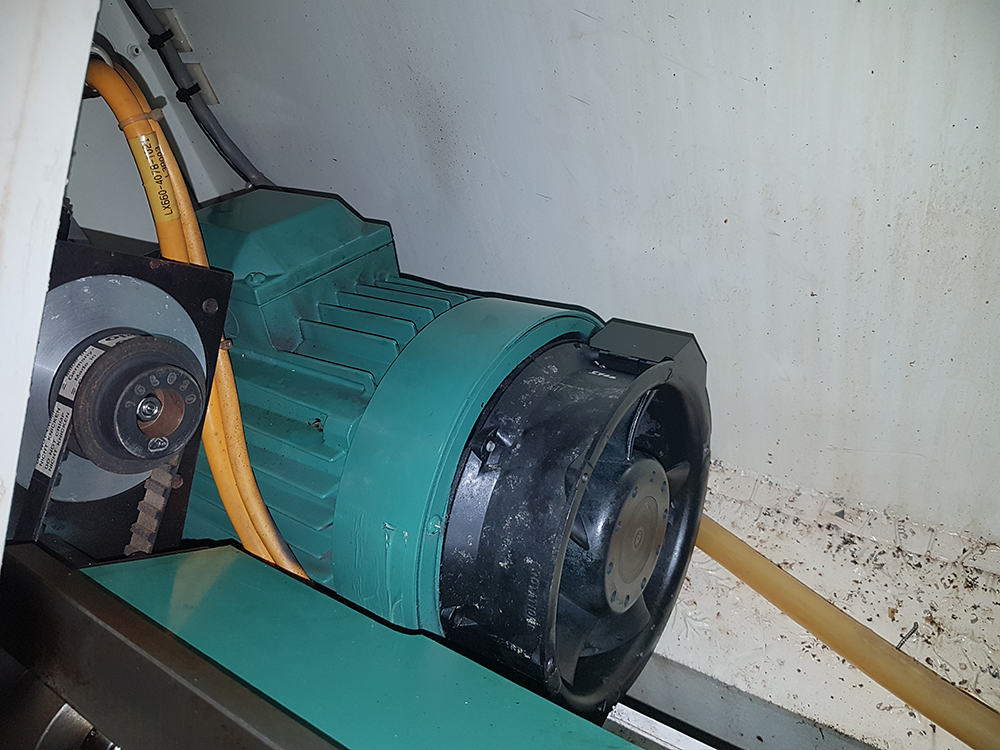

    Found the culprit, it is this spindle cooling fan, no obstruction and it only makes the noise at high rpm. Are these serviceable or do i need to buy a new one?
    Searching the model, turns up the original on RS - http://uk.rs-online.com/web/p/axial-fans/2584718/ but it's discontinued, and they list this - http://uk.rs-online.com/web/p/axial-fans/6196860/ as a replacement.
    Might be best to double check measurements though.
