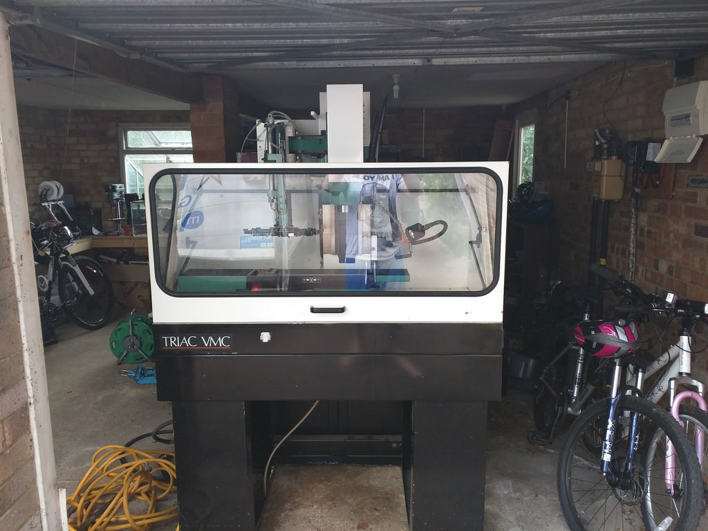

    So very pleased to start this thread. After my previous thread of 'what decent milling' machine, I found a school owned Triac VMC for sale. After a massive struggle to transport the unit and buying it unseen, it was delivered this morning. The mill was sold with a few extra tools but with a fault that the OS does not boot up. On the basis that I will likely retrofit some / all of the electronics, I considered this in the purchase decision and costing.
    Initial thoughts are wow, its massive. Its also fairly heavy, as we had discovered when manually unloading it. The lads had loaded it up the previous day and clearly hadnt learnt about getting an engine hoist or similar to help.
    I will upload pics in a bit, but the mill looks fairly clean, little use. I could not lift the front door to see much more as its interlocked and needs power to unlock.
    Not a lot of unhappyness, apart from when they left, I tried to close the garage door and could not. Fortunately a bit of an effort and the garage door was closed. There is a bit of damage on the bottom as the machine has been man handled to move it but nothing serious.
    The machine has come with more tools than expected and also a semi decent looking vice. I suspect if I add up the tools and few extras, some value already.

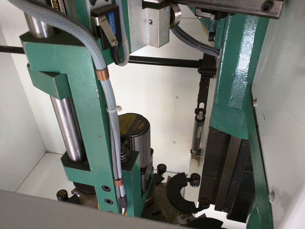

    OK, so first pics. There is something missing in the top left of the cabinet ...... and then on the top right of the ATC. Any idea what this could be? The wiring diagram doesn't seem to show what this is (shows as empty in the commissioning data). Will have to trace the wires to see where it goes. The rest look like pneumatic tubes or similar.

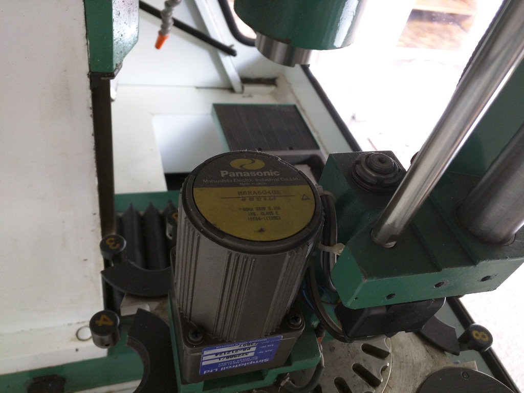

    OK, this is the ATC wiring diagram. I am assuming that its a servo on the basis that there is some encoder wiring. Would this be correct? The panasonic unit seems to be some form of geared motor.
    For the missing bits, the cover of the ATC is off but I dont think anything goes into the cover, not sure, will check when I get home.
