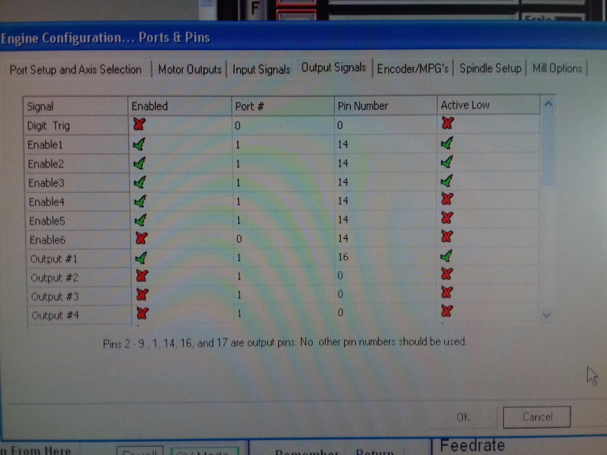

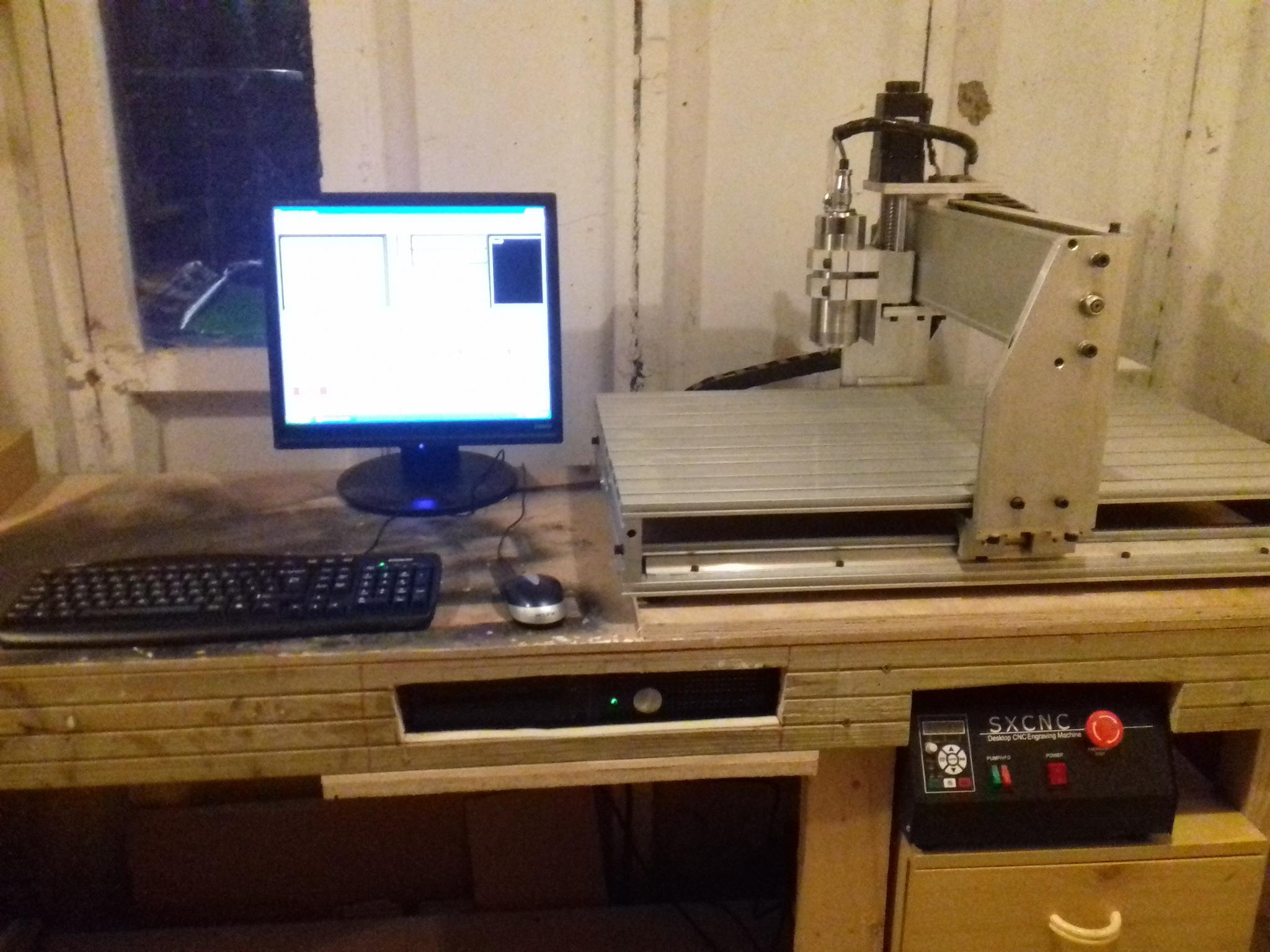

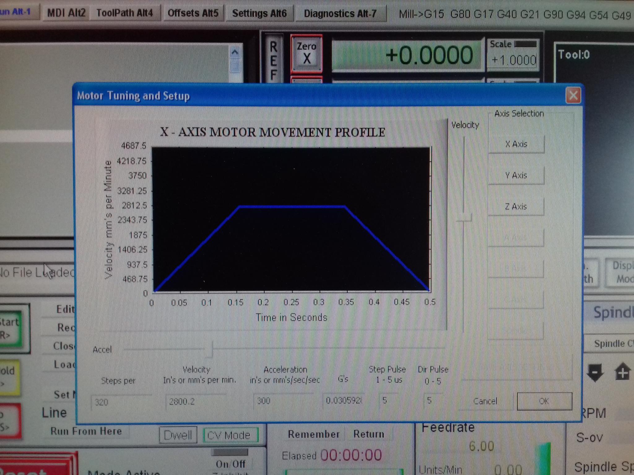

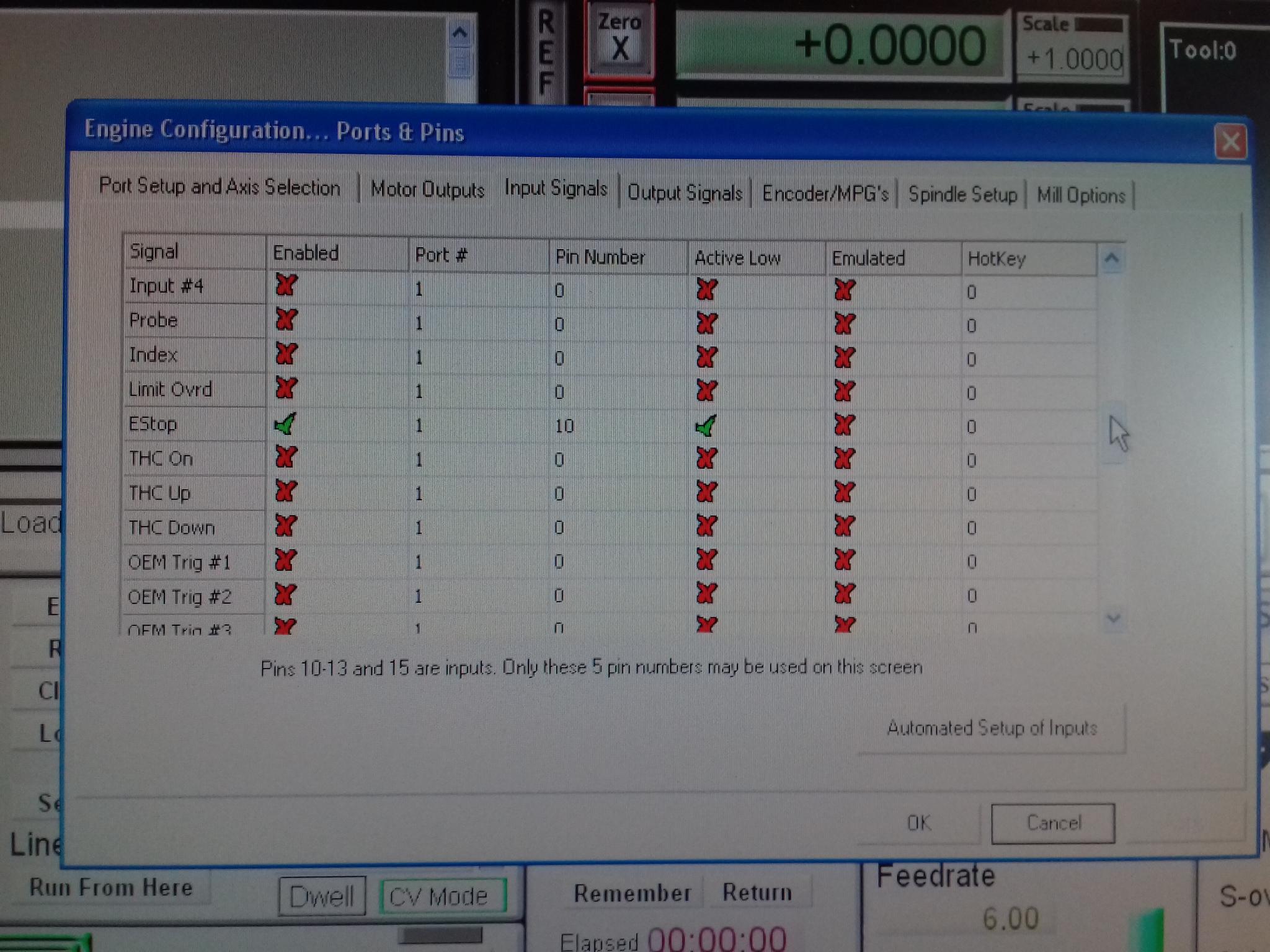

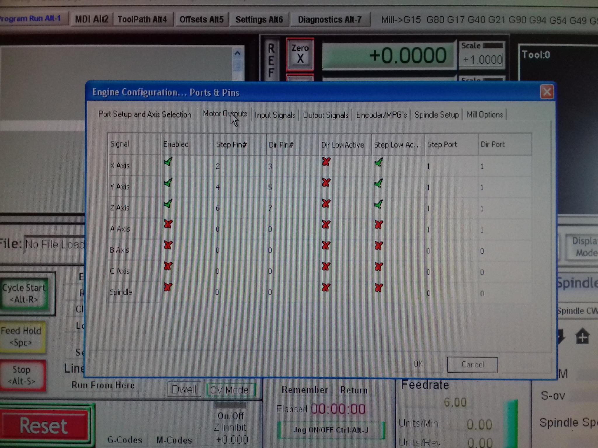

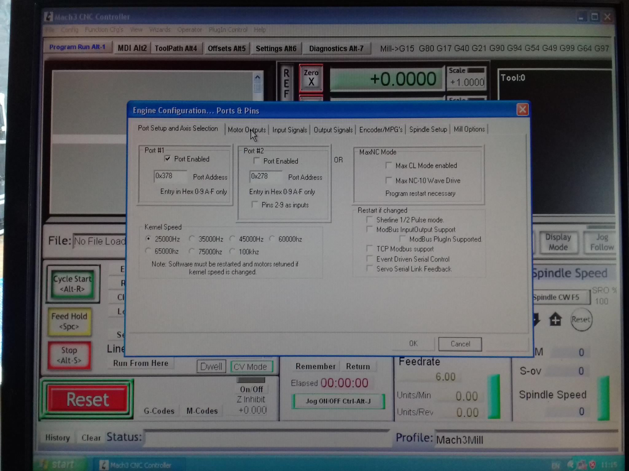

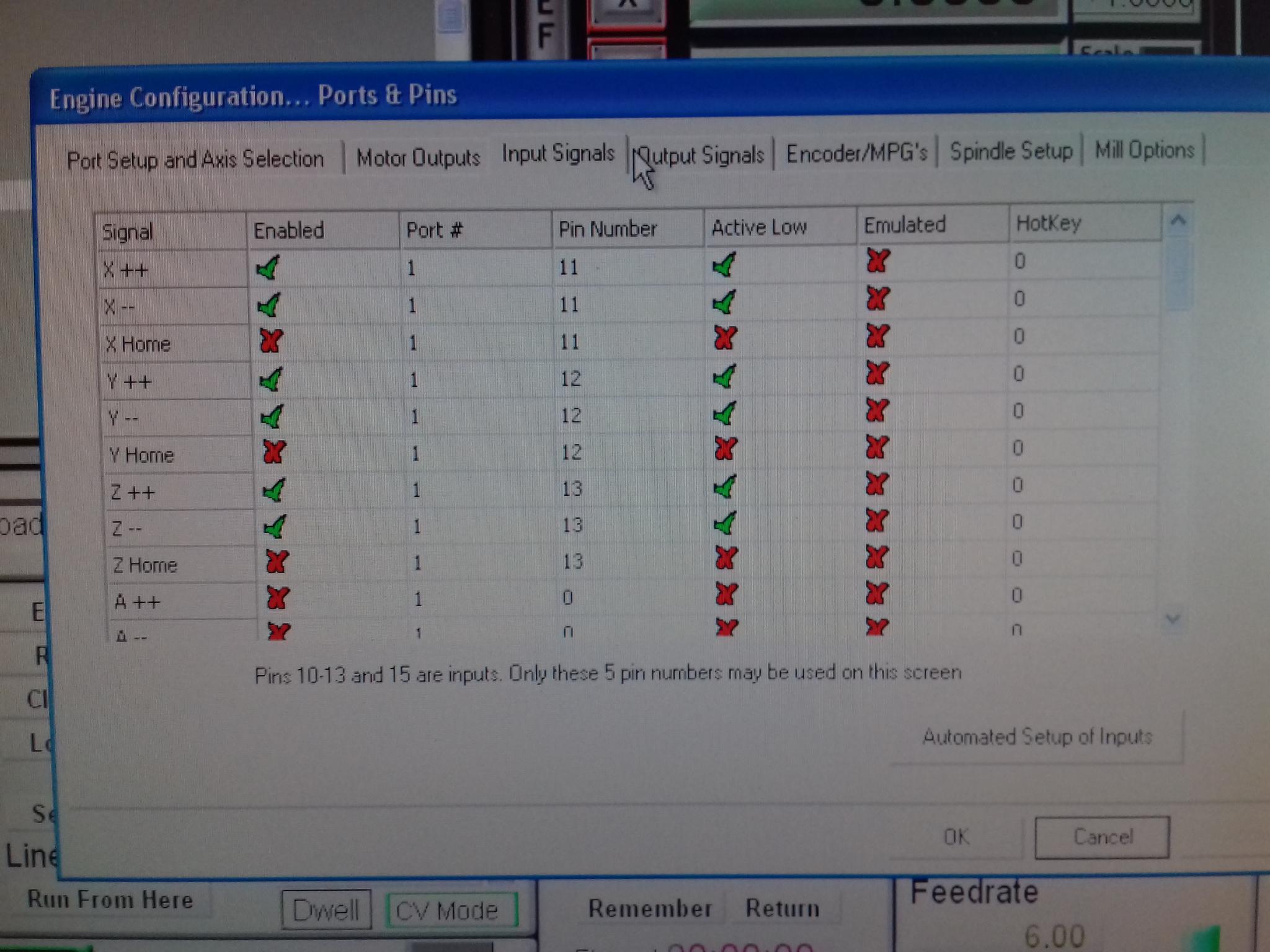

    Hi all I am having a bit of a problem with my new setup, its not doing anything...
    I have done what I think is wright but so far I have a glorified paperweight and nothing more.
    I have:
    Pentium 4 XP terminal with a demo version of Mach3 I rebooted when installed.
    CNC 6040 from Germany
    USB to Parallel Port connecter
    I have not done anything in BIOS as far as I can tell with XP it should already be default settings for the ports.
    I have these screen shots to show my settings I have done which I obtained from internet.
    Am I missing something else? please advise and thank you for your time.

    You can't use a USB to parallel port converter you must use a motion controller like the UC100 or something similar, or use the parallel port of the PC directly.
    Lives in East Lothian, United Kingdom. Last Activity: 22 Hours Ago Forum Superstar, has done so much to help others, they deserve a medal. Has been a member for 9-10 years. Has a total post count of 2,909. Received thanks 360 times, giving thanks to others 8 times.
    From your other thread -
    Quote Originally Posted by Palletlad View Post
    oh on a side note I just seen a thread about the parallel ports and it was mentioned that a parallel port to USB connector will not work... I am confused because the machine came with a Parallel port to USB connector?
    A standard usb to parallel port adapter won't work. The timing for a generic parallel port is not that strict, and is not good enough for motion control. There are however adapters that look very like a standard adapter, but are in fact dedicated motion controllers in a standard case (UC100 & PMDX-411 are two from reputable sources).
    What drivers were supplied, and what does the adapter show up as when connected to the PC?
    Sorry just re read your response and seen the last line, I will get back to you tomorrow with the answers to your questions as its late and the garage is all locked up now.
    I brought an lpt lead thinking I can overcome this problem but realised I have the incorrect male connector on one end and not two female connectors.
    Back to basics : Does your computer have a parallel port? And, if so, does the cable you bought allow you to connect the computer parallel port to the CNC controller?
    (it's probably easy and more confidence inspiring if we can get you working on the default parallel interface before worrying about the motion controller).
    Not forgetting a 32 bit version of Windows as parallel port support has been "retired" by microsoft in the 64 bit versions.
