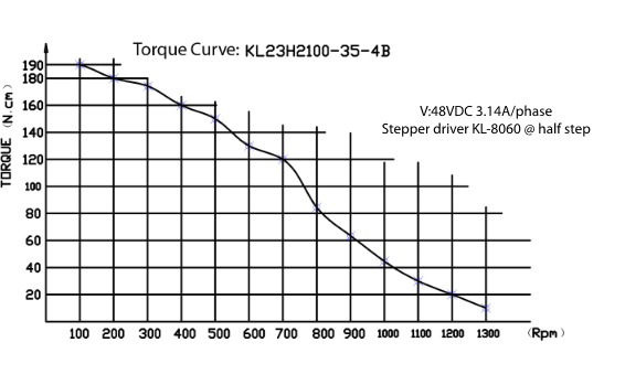

    My goal is to have a resolution of 0.01 and an accuracy of 0.1mm. I tried to calculate the speed with a hiwin 2020 ballscrew, KL23H2100-35-4B NEMA23 and found a max speed of 500 IPM. Is it possible?
    Here is the specs of the motors (4X):
