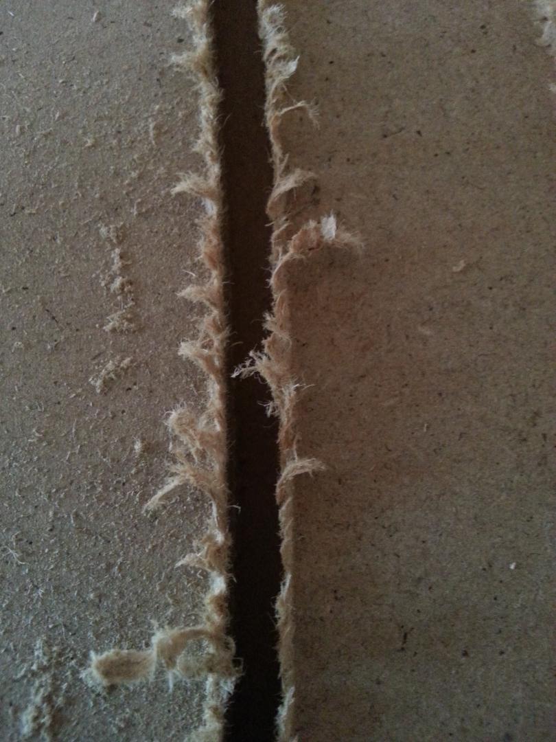

    Noticed when cutting small tables, the edges (even with a new bit) are very furry.
    I know a compression bit is the answer but they are expensive and upper cut spirals have worked in the past.
    Is it the quality of the mdf? It seems, the lighter colour it is, the better it cuts (or is that just a coincidence?)
    Stuff from Builders yards, Wickes, B & Q seems to waver wildly in quality. Where do you get decent stuff at good prices?

    Yes, lighter color generally indicates higher quality, often known as super-refined MDF.
    I generally use downcuts.

    a straight flute generally works ok for me certainly better than that

    Does it plunge well? Know of any good prices on straight flutes?
    here; https://www.toolstation.com/shop/Pow...traight/p67412
    You should use a spiral lead-in because they are not designed to plunge straight down, I use them all the time.

    Thanks, but isn't that a router bit? I'm talking CNC btw.
    Ha, the router bit has no idea nor cares whether you are using a router or a cnc, in fact I'm suprised you thought there was a difference. (where we are talking about wood products)

    Sorry I thought they were different. I just found a straight fluted mill bit that can plunge (specifically for CNC). Will give one of those a try. Thanks for suggestion. :)
    Plunging is fine but there comes a time when you should look at lead-in moves. What CAM software are you using ?

    I would only be plunging 6mm holes and the start of the table edge. I am using V Carve and Mach 3
