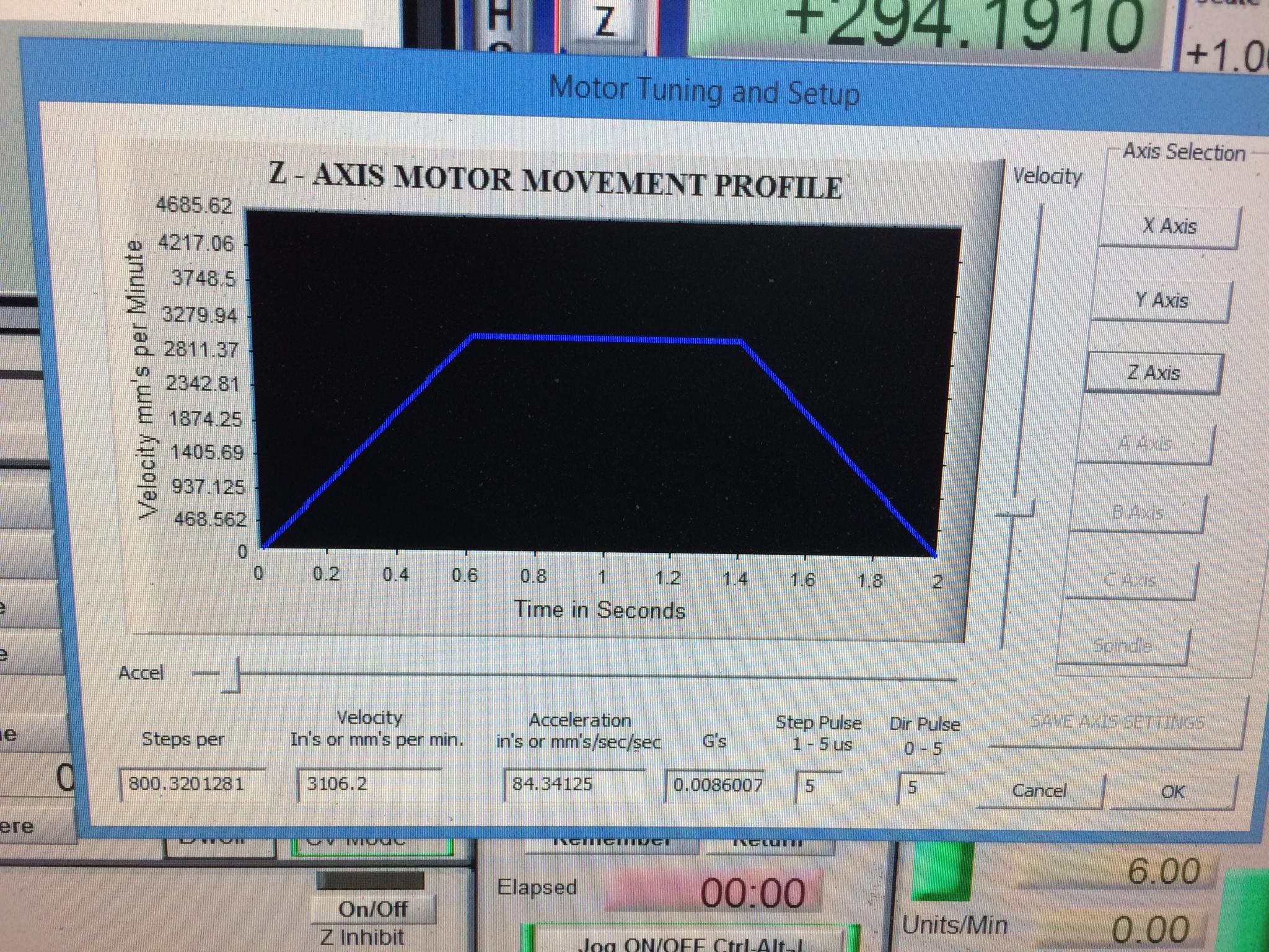

    I think I had this problem a few months back and im sure some one helped sort it however I cant for the life of me find the information any were. I thought I changed something at the time and it fixed it but the problem seam to have come back and now the z axis trips out in the same place every time on various files.
    the problem is on my z axis always tripping out and giving 5 blinks on the led indicating Senssorless Stall Protection
    I seam to remember it was something to do with the motor tuning and they said it was do with the axis not keeping up with each other but as I say cant find were the info I was given is.
    can anyone make any suggestions on what to do?
    many thanks

    Ok so this morning I tried the same file as yesterday which I normal run at 150% and it still faults however run at only 100% it is ok. I have a friend here who knows a little more so we have swapped the two drives over to see if the problem changed drives however now doong a rapid move on the y axis just using the keyboard trips the same driver as before which is now on the z axis.

    The drive is giving the same sensorless stall protection fault on the same file each time if I change the file it faults again but at a different point in the file but is repeatable if you re start the file. The fault causes a external e stop on Mach 3.
    Yes the driver trips doing air cuts
    Many thanks

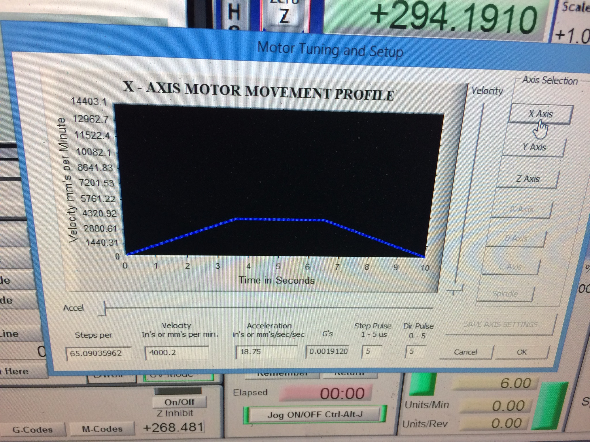

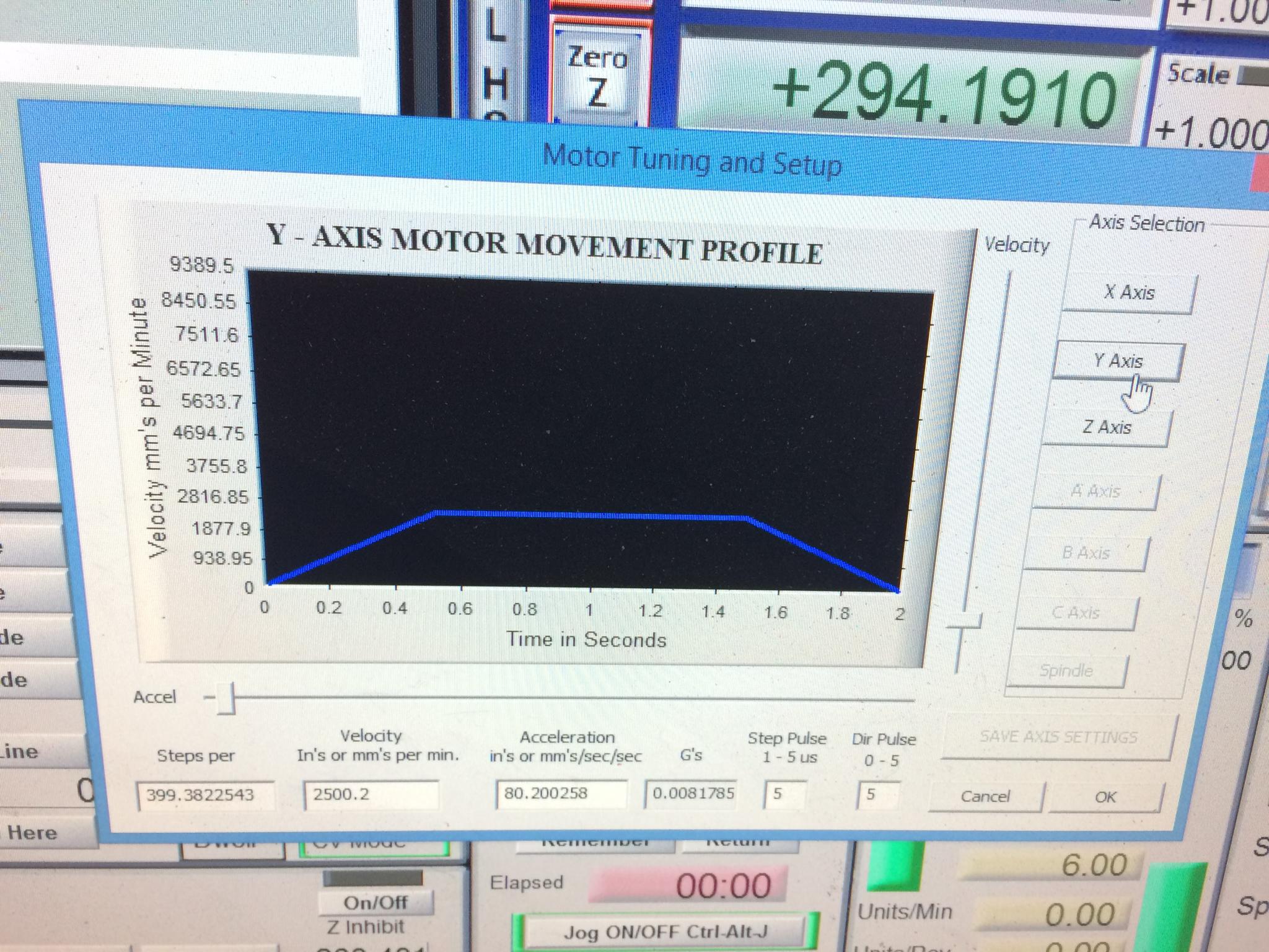

    Here are the two motor tuninging numbers for y and z that use the same driver Then the x on the junco drive
