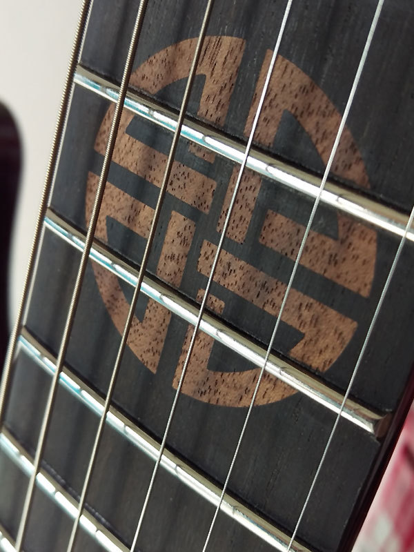

    Thanks for the tip on installing the inlay - I've yet to try one personally, the work I do gets passed back to the client who runs a guitar/bass building course up here in Manchester and he goes through the process with his students. It's usually a nice tight fit - here are a couple I did a while back:
ID:	23374 Click image for larger version.
