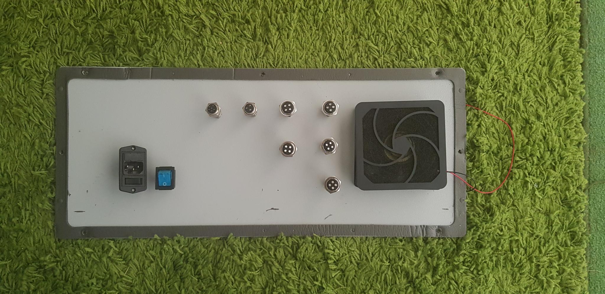

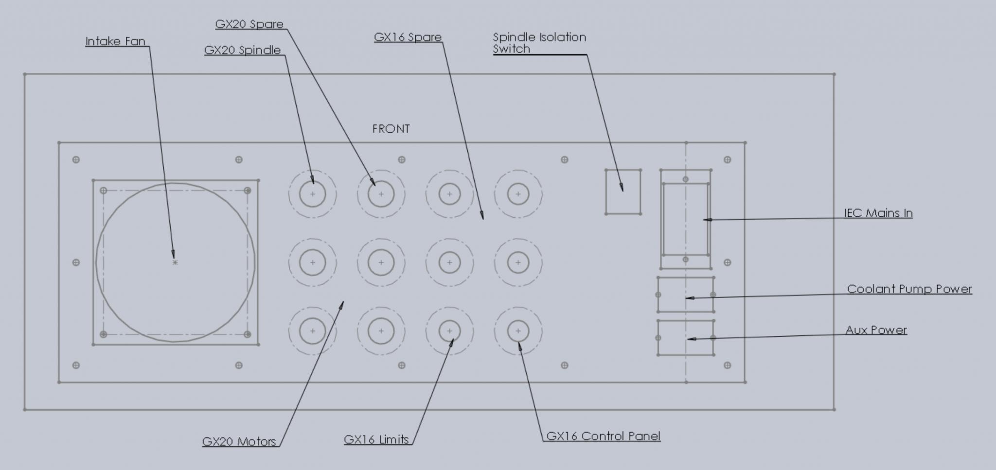

    I've also been designing my gland plate - the plan is to have it detachable from the inside (as well as the outside) so the plate can be taken out with the entire electronics panel for reworking in the future if required. To do that, my plan is to put a stainless steel plate on top of the current gland plate. Apparently I took the layout photo the opposite way around though!
Name:	Gland Plate Layout.jpg
