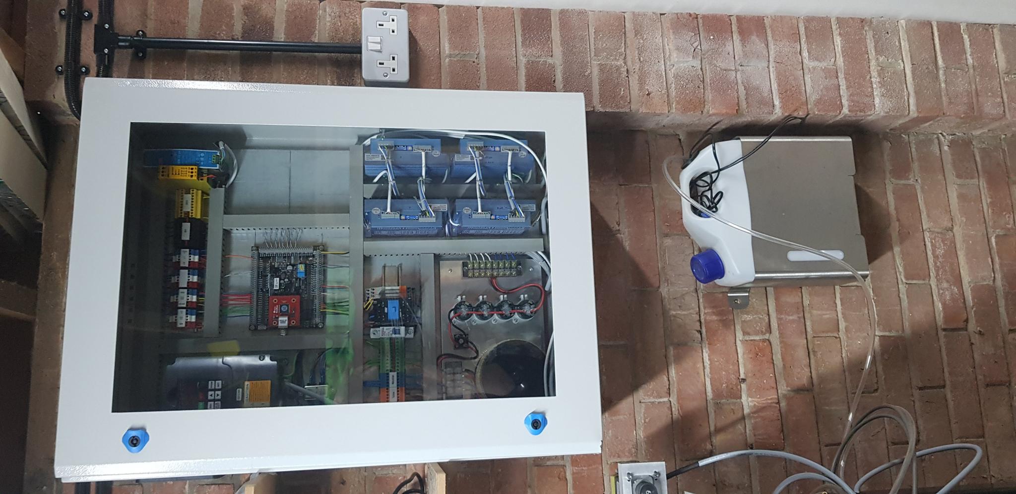

    Time for the Sunday night update!
    Electronics have been relocated to their cabinet - everything in there is wired up and done (... I think...). I'm waiting on a couple more bits for the gland plate which are delaying things somewhat (I can't really solder the connectors on until the gland plate has all the right holes in). Thinking a 300mm deep cabinet may have been slightly overkill, but initially I was very concerned about how far the VFD was sticking out.
    I've also sorted out the water coolant tank - rather a nice skip find! I've put my water pump in that bottle, just needs wiring up and re-sealing.

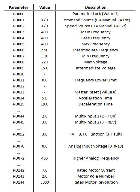

    Planned Spindle Parameters with my setup:
    These are basically as per the sticky thread, but I've customized the multi-input and FA/FB/FC functions, and chosen other parameters for my setup (and added labels for anyone who can't be bothered to look them up in the manual!!).

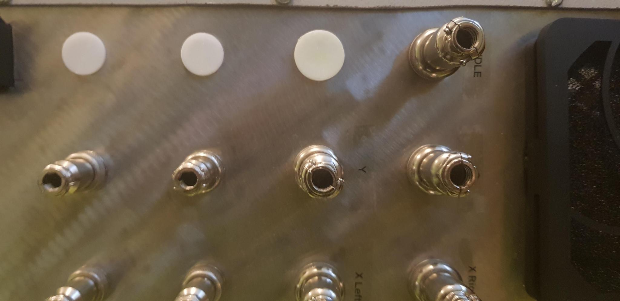

    I've finished the gland plate wiring and soldering, and am now working on the cable chain arrangements before finishing up the GX20 plugs on the motors and spindle. I've rescued some old Igus chain from work, but it didn't have any ends, and they're no longer in production, so I'm 3D printing my own mounts which is taking a few iterations.
    With the gland plate finished, that is essentially everything in the cabinet done, so I powered it up for the first time in place the other night to test communications etc (PC is on the other side of the garage, had some fun with evil CAT5 cables, panel mount CAT5 joiners, and a apparently one of my crimpers is dodgy). The airflow through the cabinet sounds proper industrial... :) That was then followed up by the PC's graphics card dying, and ironically a licencing issue with UCCNC exactly like Voicecoil's that magically fixed itself after about an hour... I genuinely have no idea what I changed. Fun week.

    PD 14 and PD15 are too low you will get overvolt or over current trips at higher rpm because it cannot get to commanded speed in 2 second or stop spindle in 1 second so it dumps in a load of volts/current to try get there but cannot possibly do it.
    Set PD14=5 PD15=10 for safe settings. Then if your not quite at full RPM before G-code starts moving set an M3 delay in the spindle settings.
