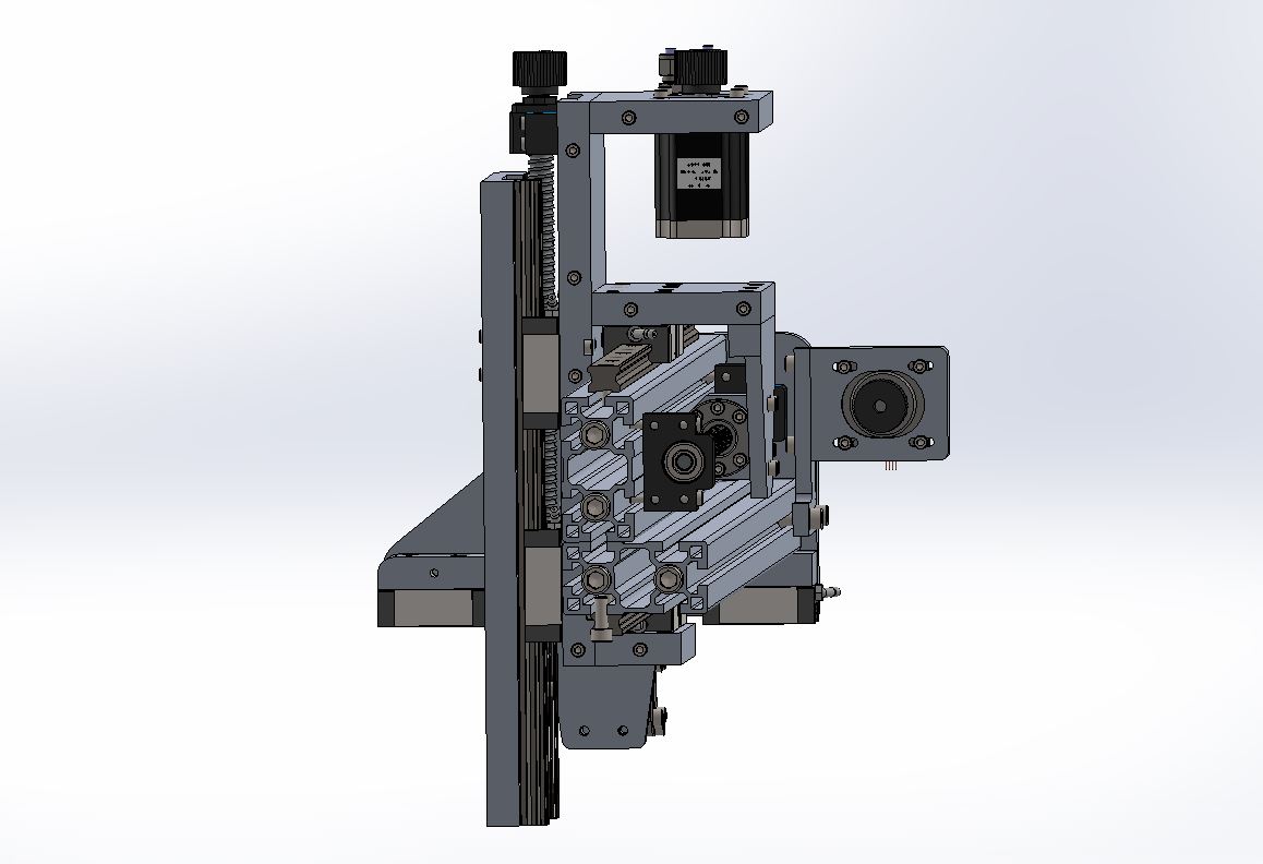

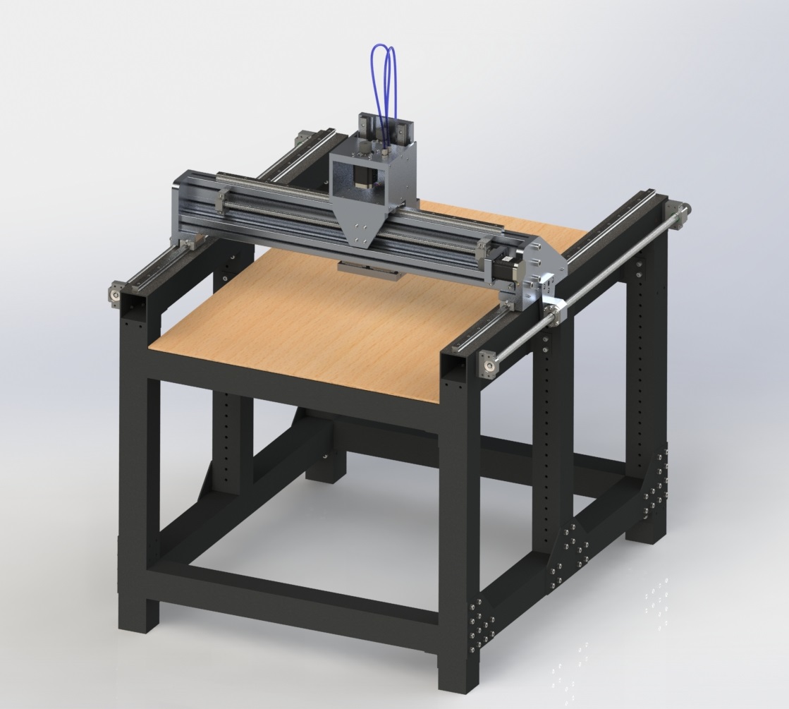

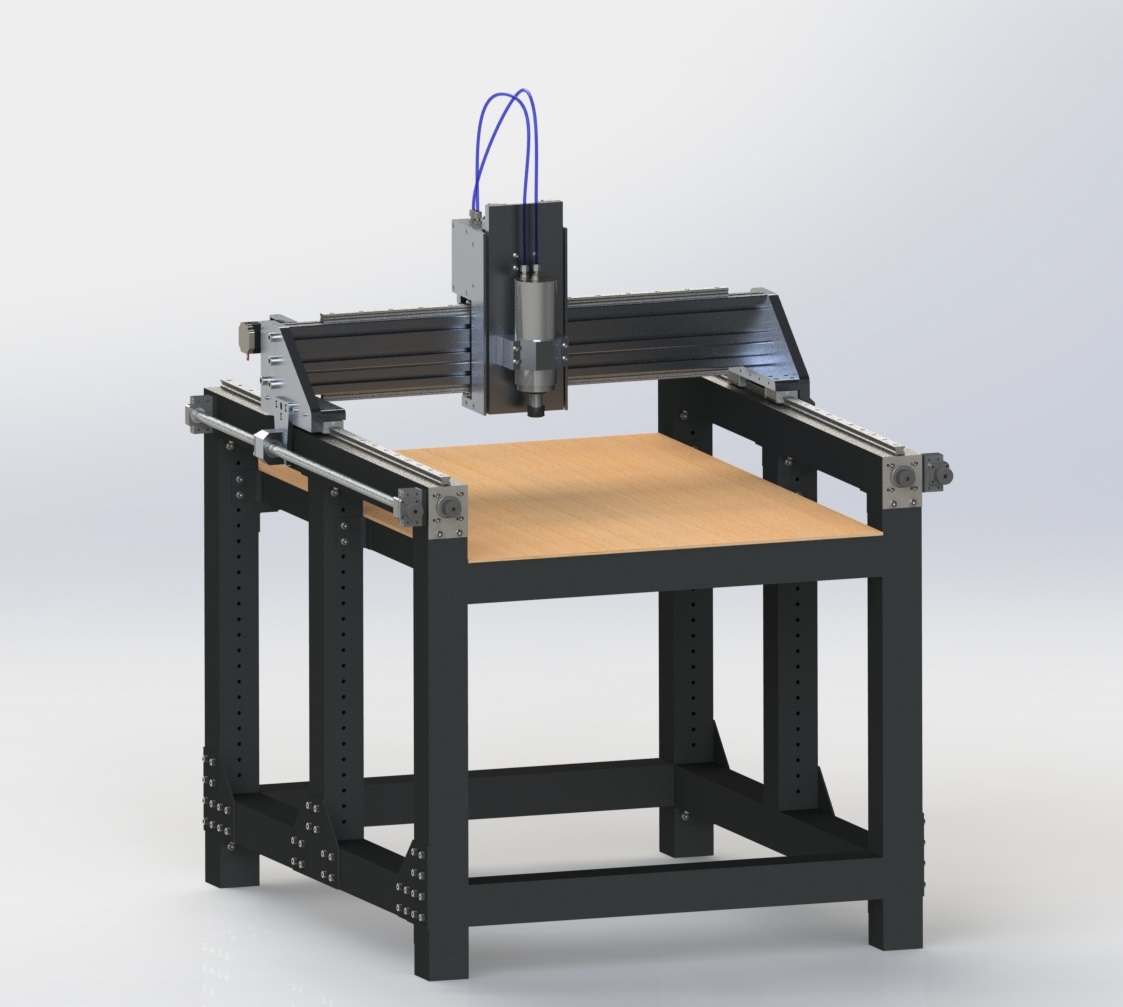

    Okay, so its been approximately a year. I suppose I'd better post an update or two!
    First things first, current drawings:

    I mulled over the advice I got from Clive and routercnc for a long time. far too long. I repeated my deformation calculations with various materials and geometries. Ultimately, Aluminium won :) There's a few solid reasons:
    • Cost - It isn't as bad as I expected. The aluminium profiles are only about £50.
    • Ease of working with. The connection to the side plates is just so much easier.
    • Deformation is tolerable. I think it increases vs my steel design from 3.0um to 4.9um - Lets be honest, its never getting close to those tolerances elsewhere!
    • Proven history of this configuration working for others on this forum.
    That decision also cemented the plan for making the side plates out of 20mm aluminium plate - and I think they look reasonable. The other factor is that the milling machine is currently in storage a couple of hundred miles away, and at least I can work aluminium in my garage :D This means I'm also planning on going down the epoxy route for levelling the x-axis, and my belief is that the y axis on the ali-profile should be reasonable out of the box (?). That also allowed me to further copy Joe (thanks bud!) and start designing my motor mount locations etc.
    Plan for the motors is that they're all going to have a 15mm timing belt connection to the ballscrews. I believe this allows me some flexibility to gear up/down in the future.

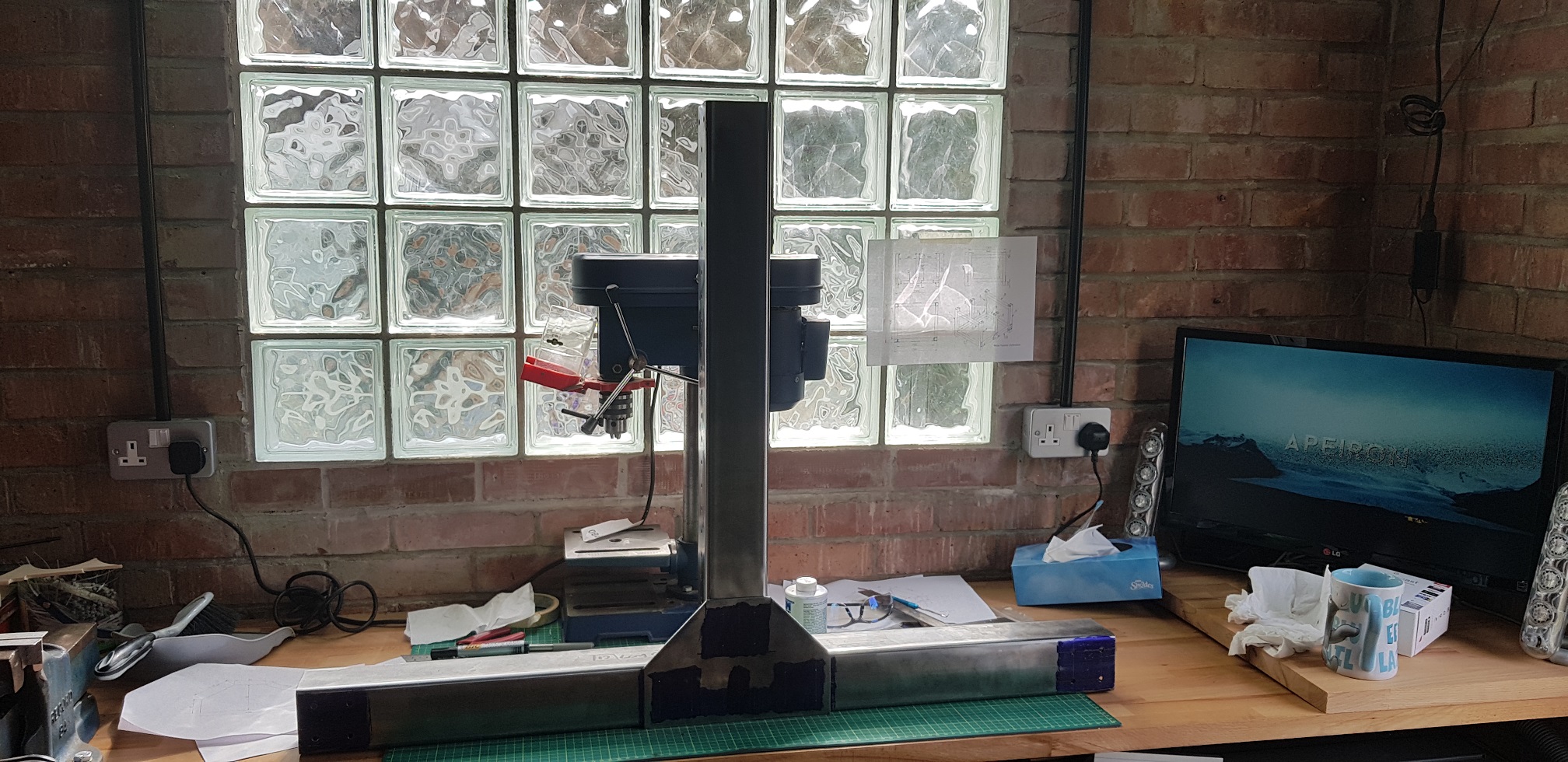

Name:	Cleaning Steel.jpg
ID:	25080 Click image for larger version.
Name:	lots of cleaning.jpg

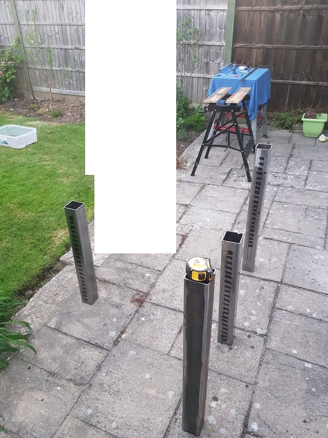

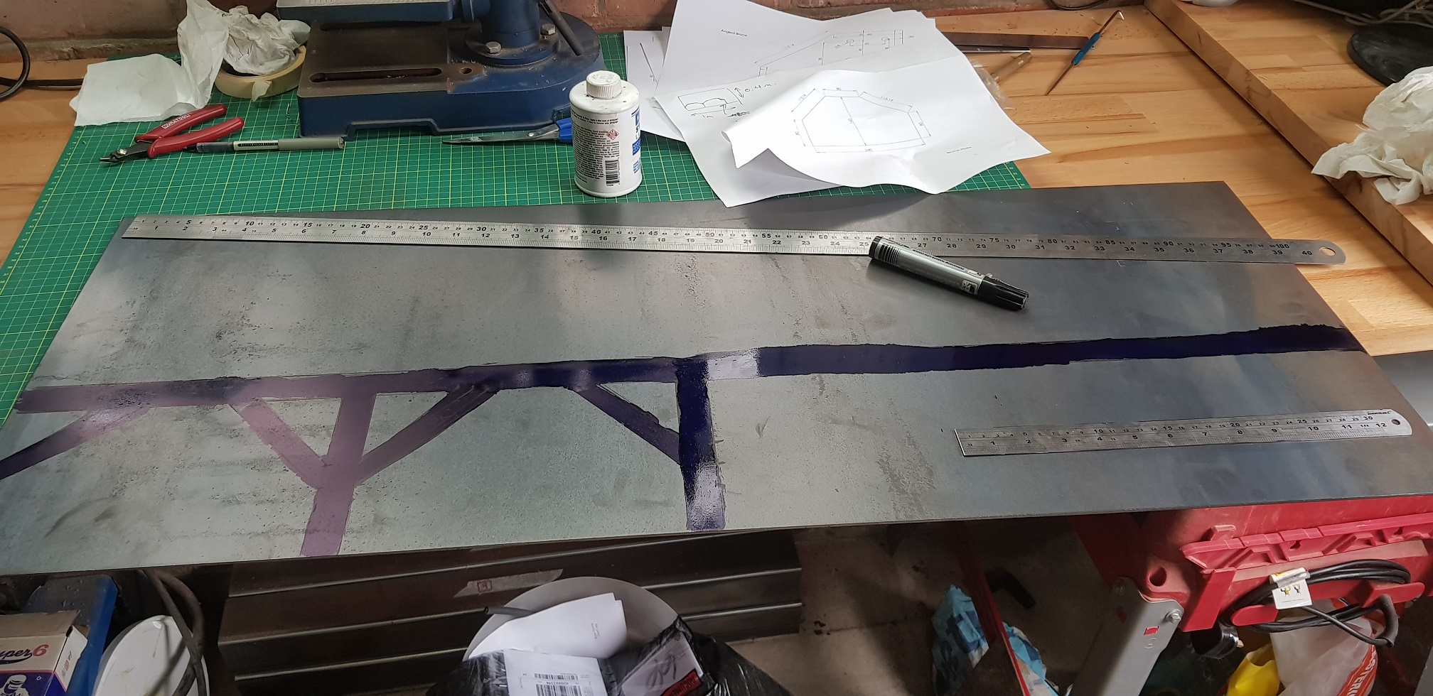

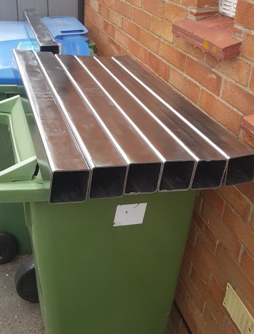

    Large steel delivery (about three hundred quid for the base frame and adjustable bed + some sizable offcuts). Lots of cutting... then lots of cleaning up the pieces to make them nice and shiny and easy to weld. At this point, also, you know, learnt to weld a bit :)

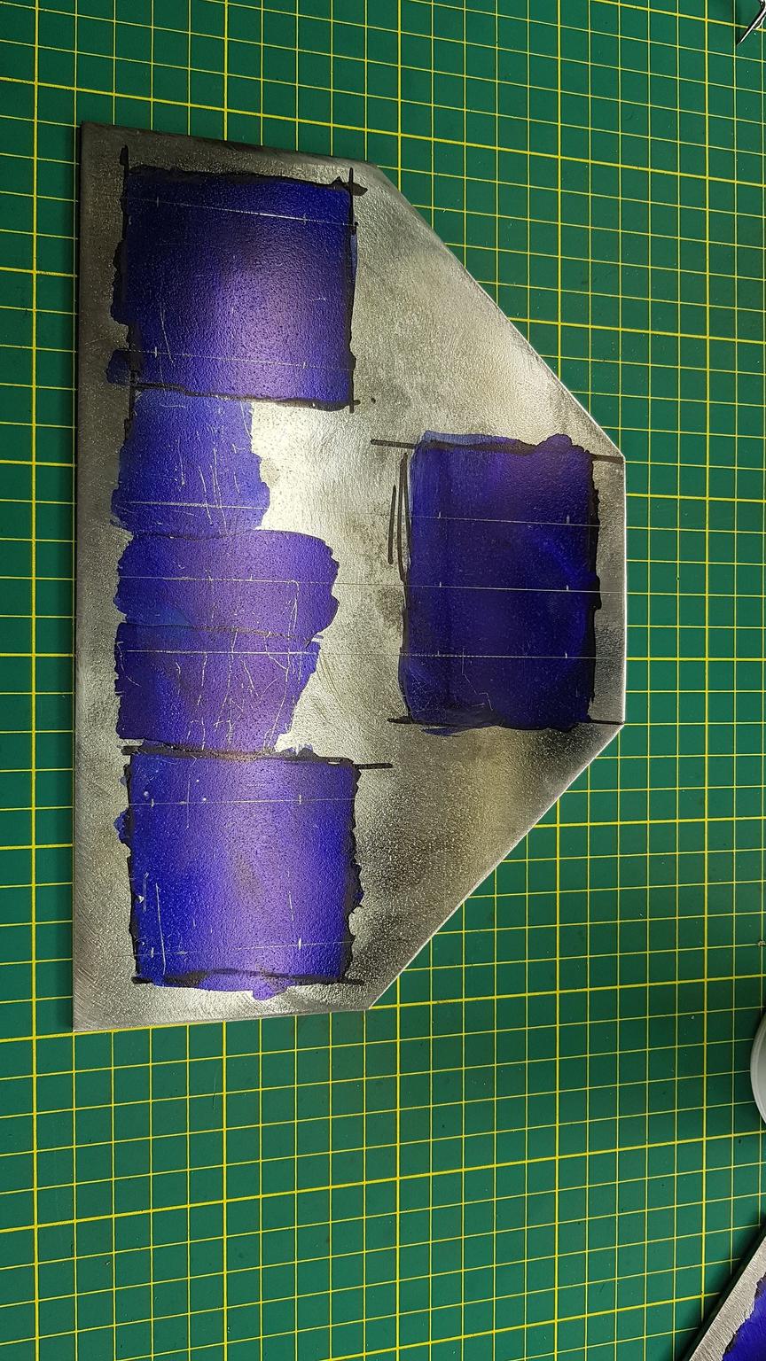

ID:	25082 Click image for larger version.
ID:	25086 Click image for larger version.

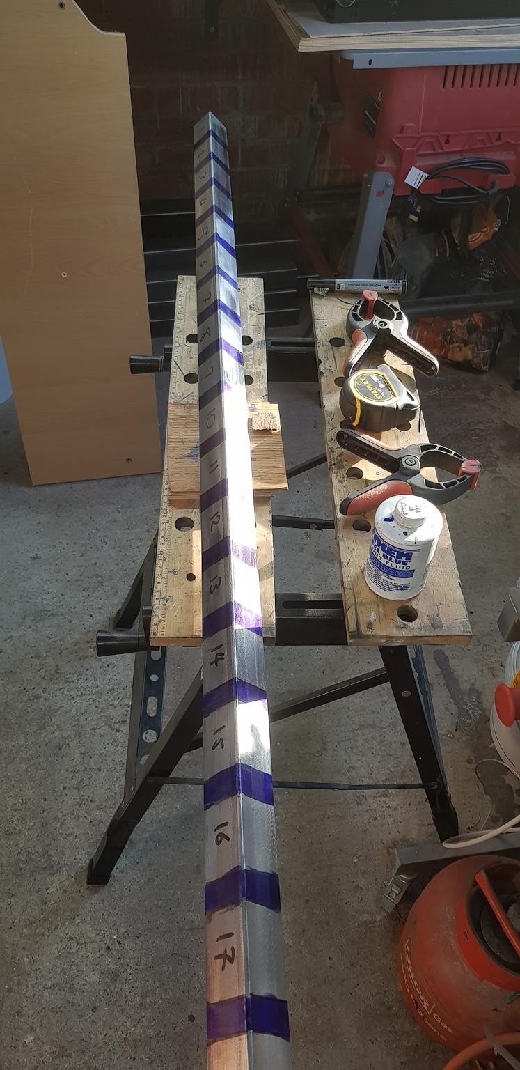

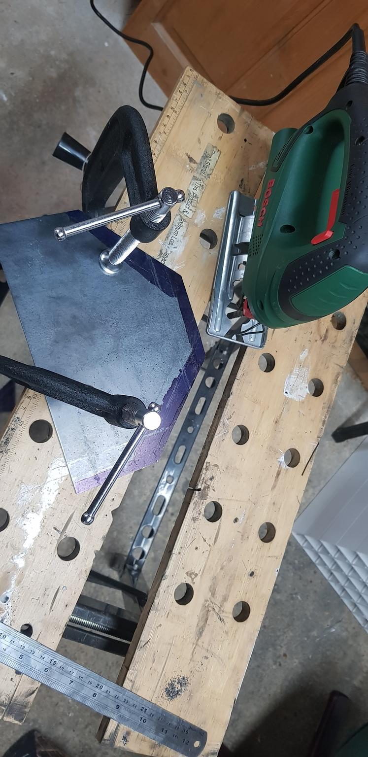

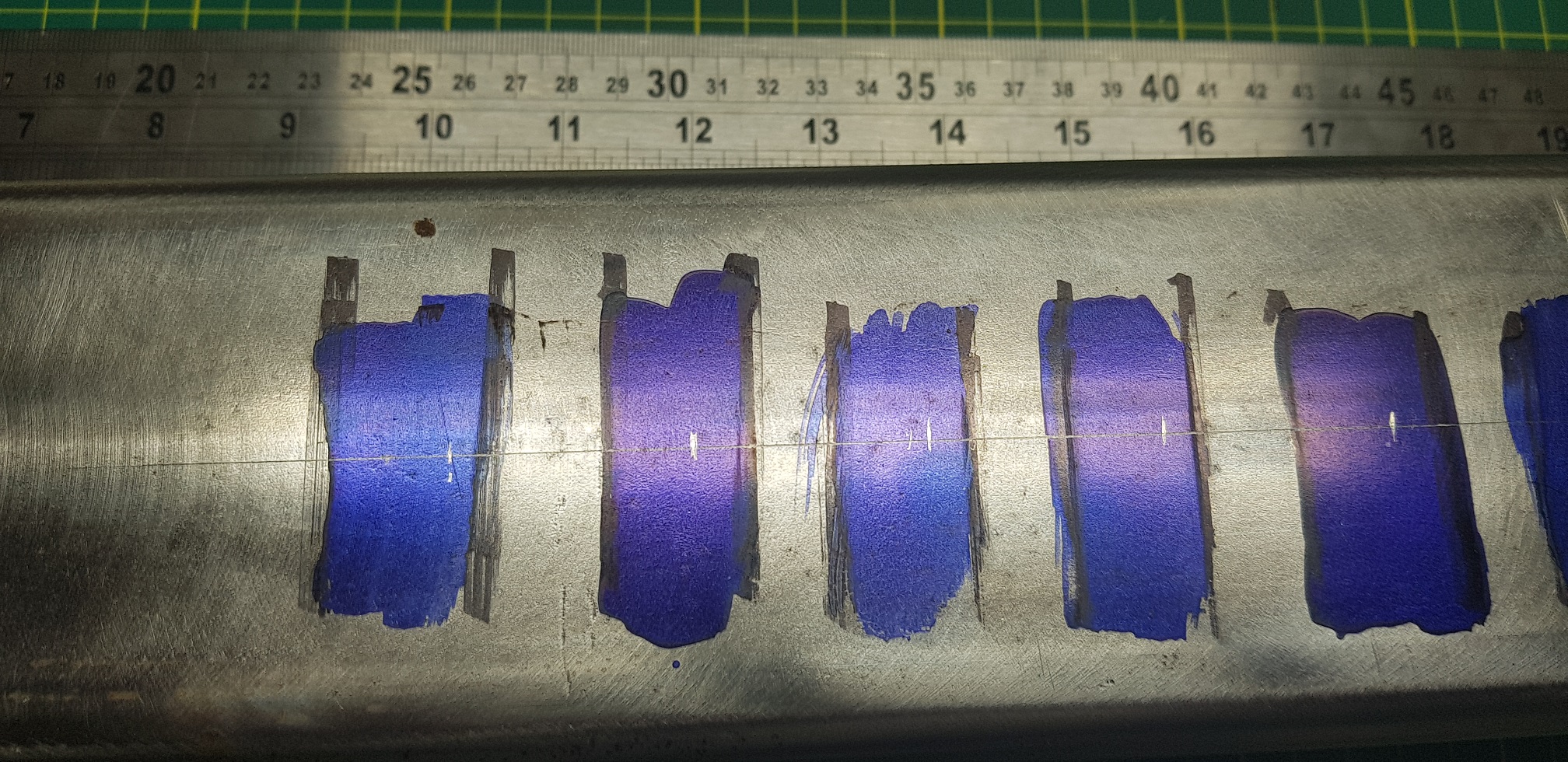

    Marking up - discovering what marking up fluid is, and then having to find my own tub! At this point I couldn't wait to layout the steel in approximate locations to give me a better idea of size (wife redacted!)

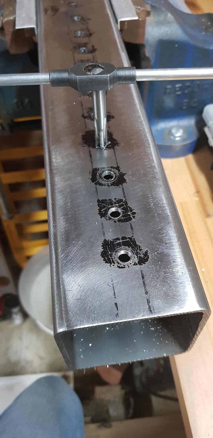

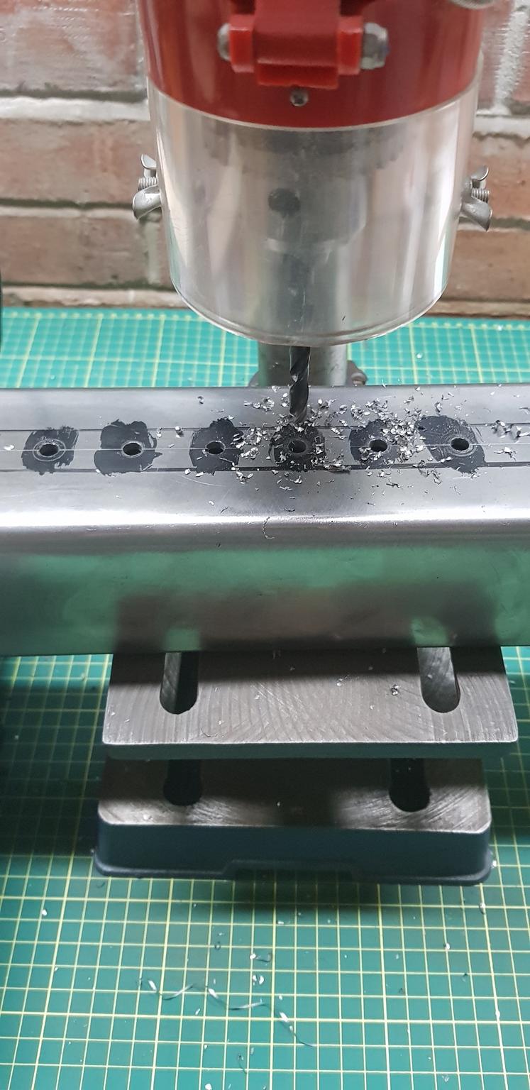

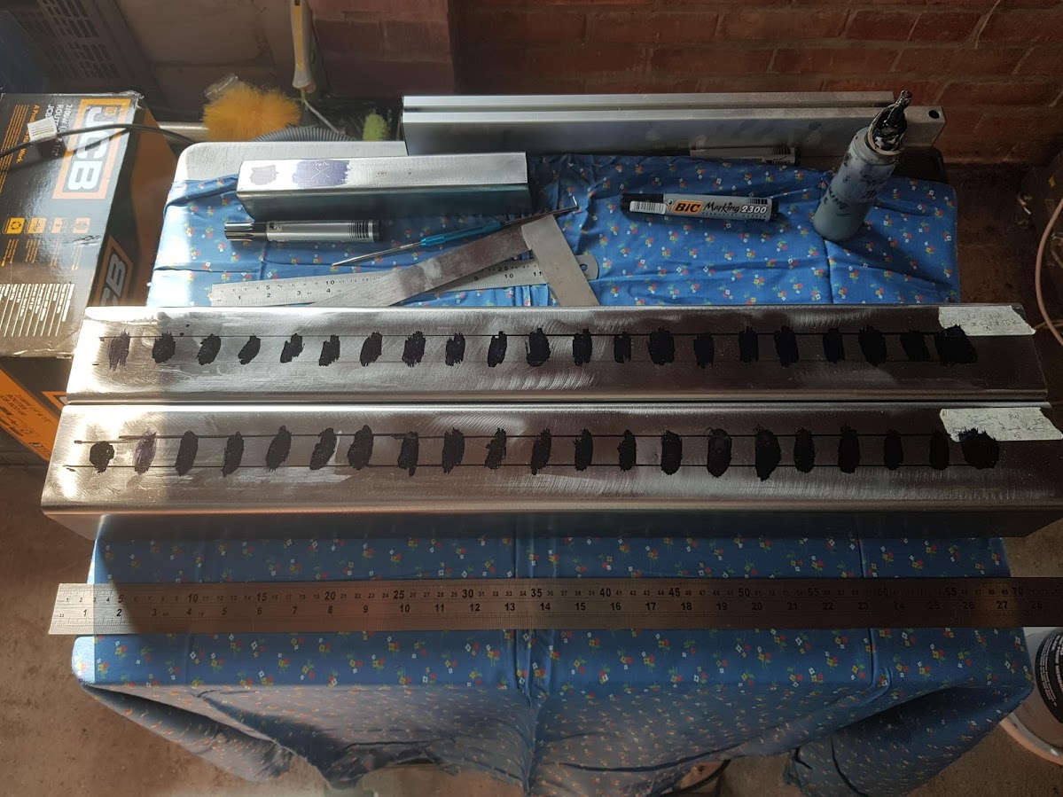

    LOTS of drilling, and LOTS of tapping. I said in my first post I'd never tapped a hole before this. Well, Now... lets just say there were evenings I wore blisters! Should probably have got myself a power-tap, but hey, all good experience.

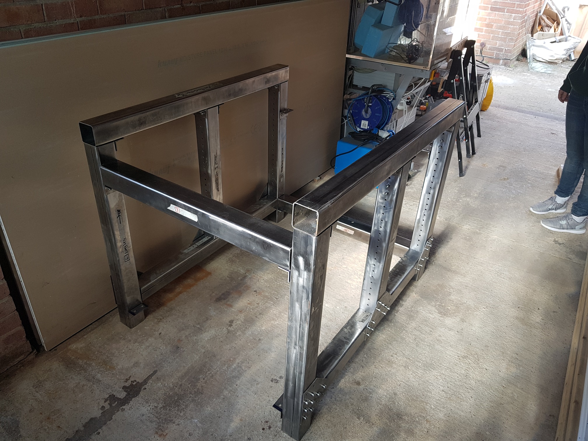

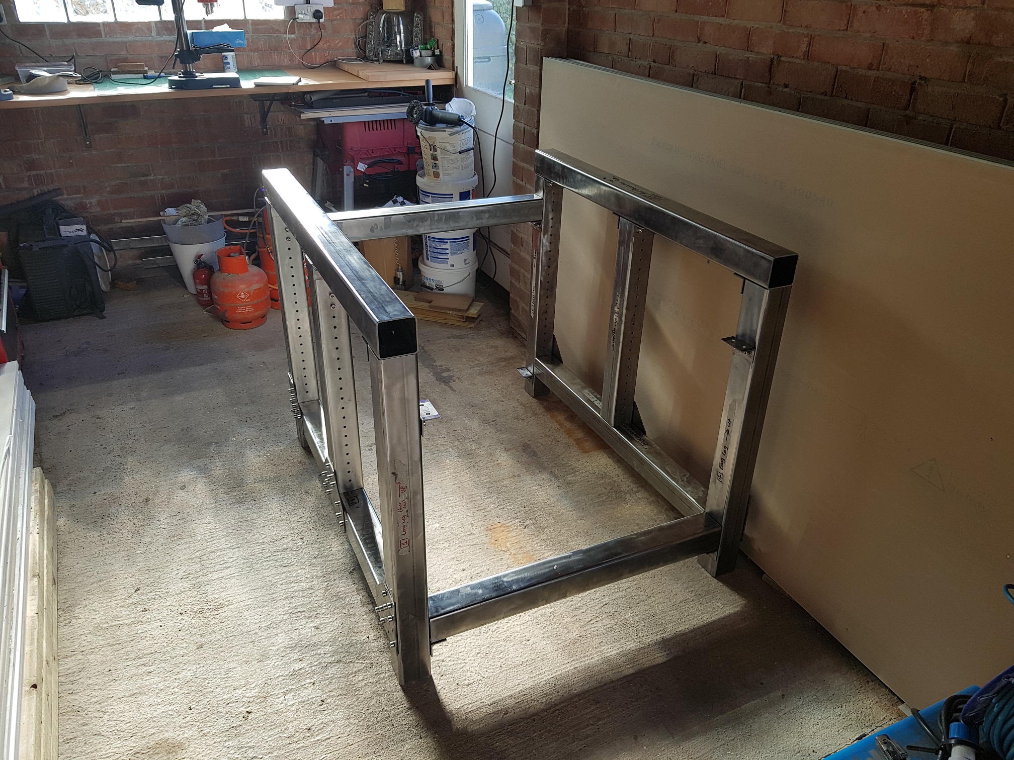

    Time to sort out the angle iron - needed quite a few of these since I started bolting together. Took the opportunity to borrow the bandsaw whilst at the in-laws and get them nicely cut to size. Marking them was a bit of an onerous task, so as my wife had recently taken up 3D printing as a hobby, printed out a jig to prevent me needing to measure! Worked surprisingly well, as our off-the-shelf middle-of-the-range printer is astonishingly accurate on its dimensions.
ID:	25099 Click image for larger version.
    Now that I had the angle pieces, I could start bolting the base together. This is pretty much how it stands today - I've added the other two cross bars, and tightened it all down. I was gobsmacked when I went around measuring the dimensions against the CAD model, to find everything was smack on what I designed it to be - although I don't have a meter long pair of calipers so I'm calling close enough!
    Next stage is to start assembing the adjustable height bed - this time I'll be welding straight out of the gate, then I need to tack weld the base frame together and design some height adjustable feet. I'm considering drilling into the concrete base of the workshop and attaching it down - thoughts? Otherwise, as I mentioned in my last post, I want to get the linear motion components on order, and order the aluminium profiles for the gantry to begin assembling those.
    Thanks for reading this far - its quite fun sharing this now I've eventually gotten around to it! :) I certainly wouldn't be able to get any of this done without the help and guidance I've found on this forum already.

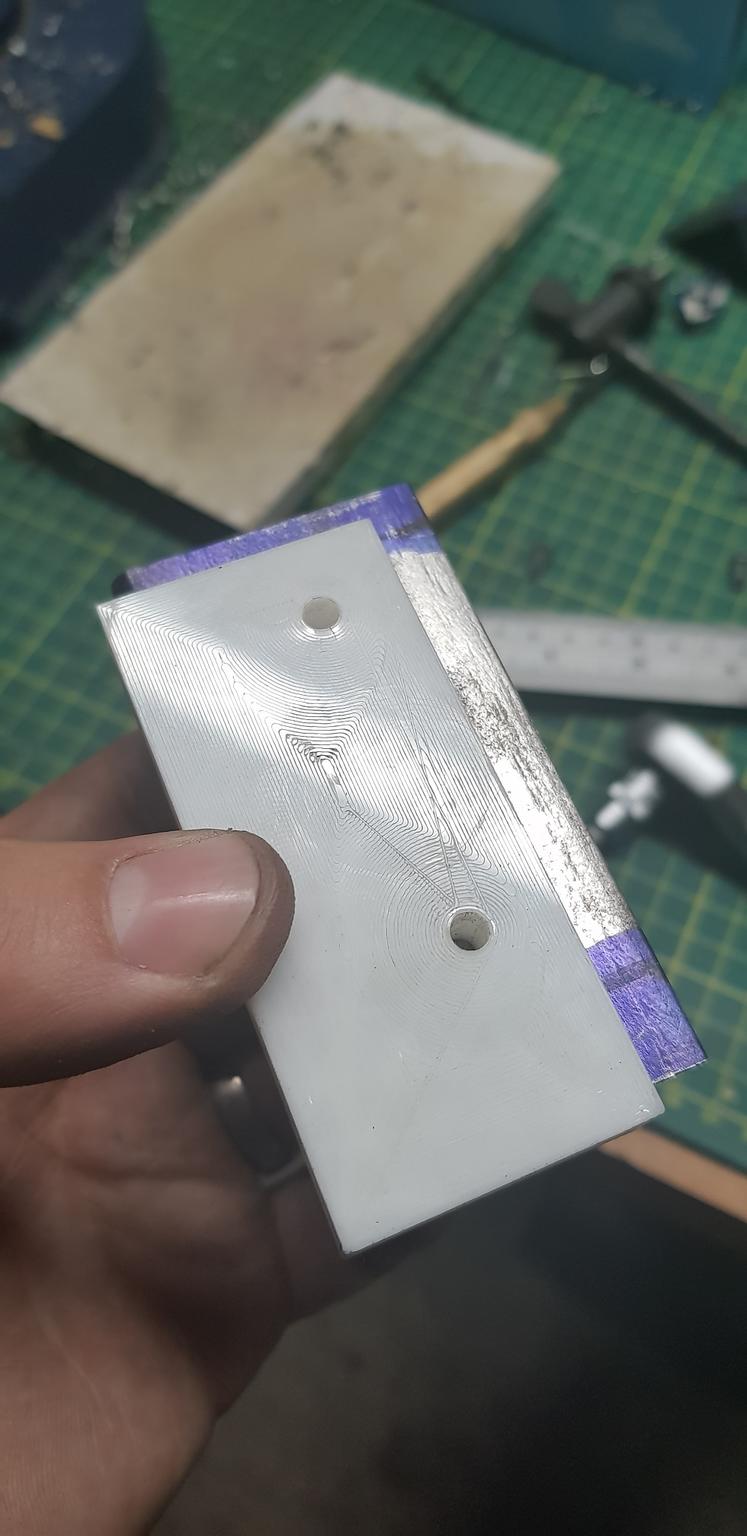

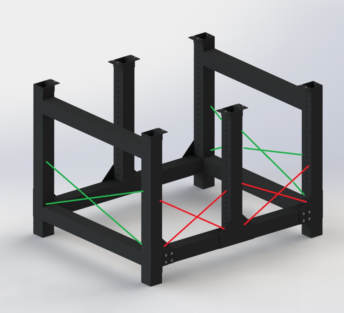

    Marking them was a bit of an onerous task, so as my wife had recently taken up 3D printing as a hobby, printed out a jig to prevent me needing to measure! Worked surprisingly well, as our off-the-shelf middle-of-the-range printer is astonishingly accurate on its dimensions. . . . . . . .
    Like that thinking! What make and model 3D printer are you using?
    The large dimension box section you've used for the base frame is great but I would suggest that, when you get to the welding stage, you stiffen the frame by triangulating with diagonal bracing.
    Personally I would brace roughly the bottom half of the side frames (sorry about negating those bottom drilled holes for the adjustable bed. Eek!)
    Your build thread reminds me of the build by Joe Harris, and is a good one to follow!
    Andy
    Thanks Andy :) We're using a Creality CR10-S. Was printing accurately with PLA within an hour of opening the box - very pleased with it so far.
    So we're on the same page, I guess you're talking about adding the red lines in the diagram below, rather than the green? I suppose if they were removable bracing they wouldn't foul the adjustable bed permanently... I was hoping to use the lower sections of the frame for a second structure, like a coolant trap or something.
