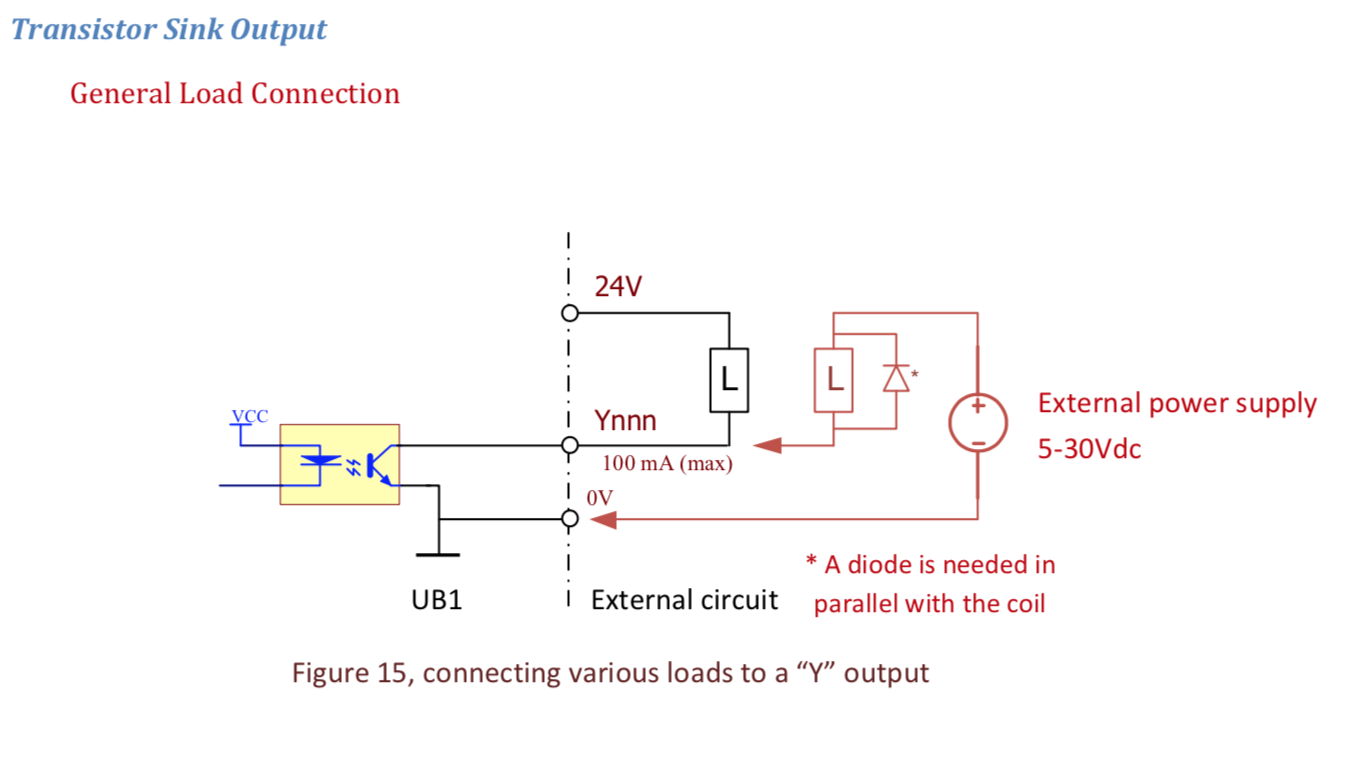

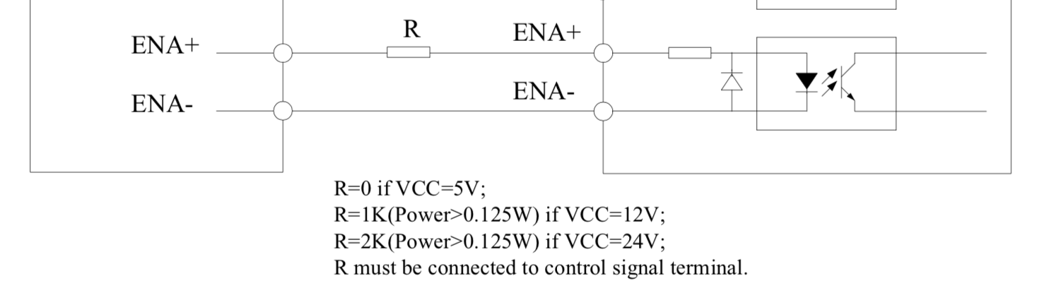

    Hi All,
    So, I thought I had the machine all ready to make its first self-powered movements this evening, however I've stumbled!
    I'm pretty sure the problem is that the drives are not enabling, because they worked before I reprogrammed the enable to be active high rather than active low, so one of the things I'll do to test is reprogram a drive enable to be active low again and retest.
    I thought I'd throw this out to people to see if you can see where I've gone wrong. The drives are wired as per the EM806 manual (below) and my circuit diagram two posts ago.
Name:	Screen Shot 2020-01-31 at 21.39.24.png
    So, each drive has a line from +24V on the UB1 to ENABLE + on the drive via a 2k ohm resistor. The ENABLE - lines are then commoned, and fed into the OSSD output on the UB1. This is the output of the safety circuit, which I can override with a button (so I know the cause isn't limits etc).
    The UB1 manual says this about the outputs:
Name:	Screen Shot 2020-01-31 at 21.44.13.png
    And lists the OSSD as just another output that is controlled by the safety circuit:
Name:	Screen Shot 2020-01-31 at 21.53.26.png
    My thoughts were, that when the output is off (i.e. safety circuit broken), no current can flow through the enable optocoupler, so its a logic low. When the output is on current can flow, logic high, drive enabled.
    The drives target 10mA on those optocouplers, so 40mA approximately should be within the 70mA sink of the output.
    I know the OSSD output is doing its thing because I can see the LED come on when I press the override.
    Have I missed something?
    I haven't ploughed my way through the UB1 manual, but in general terms it looks like the internal "switch" in the UB1 shorts the pin to earth (in which case current can flow) or not, in which case no current flows. What might be causing confusion is that when the switch is on, current flows, and the output voltage on the pin is more-or-less at earth potential. When the switch is off, the output pin is high voltage (as the resistor and enable output path on the driver form a pull-up circuit). So is your logic the wrong way round? :Low and high usually refer to the voltage on the pin, not current flow.

    Yeah that thought did trouble me too...
    I didn't notice the drive working when I wasn't overriding the safety circuit, but it's also possible that in that condition the UB1 won't send the step signals.
    I need to dig up some example circuit diagrams where people are switching the enable lines of the AM882 or EM806.

    Optocouplers work a little like elctromechanical relays: When you apply a voltage across the input terminals the output terminals are connected together. In practice most couplers contain a LED which lights up to turn on an open collector transistor. The most common circuit implementation connects the LED cathode and the emitter of the transistor to ground. Your external circuit will normally include a pull-up resistor between the open collector and the positive supply so the output voltage (the collector of the transistor) is high until pulled low by a positive voltage applied to the anode of the LED. The device therefore acts as an inverter in this configuration.
    There is no reason why the collector of the transistor cannot be connected to the positive supply and a pull-DOWN resistor connected between the emmiter and ground. The output is now the emitter and the circuit is non-inverting. As long as the collector is allways positive with respect to the emitter the device will work.
    Simillarly the anode of the LED can be connected to the positive rail and the cathode pulled low to turn it on if that suits your circuit voltages.
    All clear as mud?
