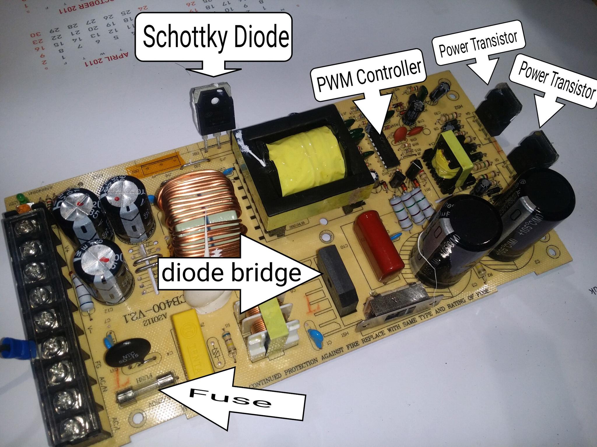

    My Chinese 6040z died during a v bit carving. Gutted.
    Quickly established that the 24v power supply was dead.
    I opened it up and started checking things. Fuse had blown, indicating fault was in high voltage side. Long story short...

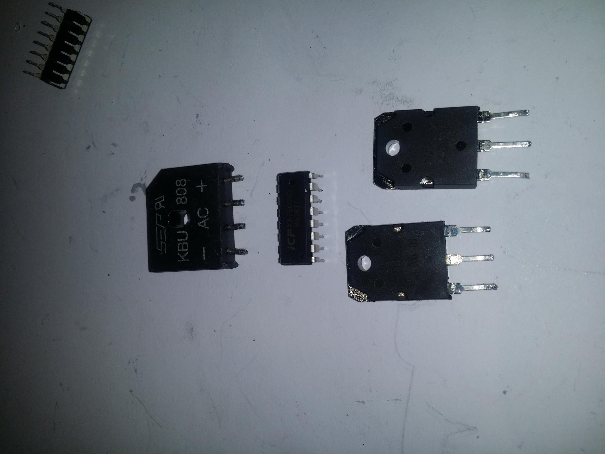

    Bridge rectifier partially shorted out, taking a power transistor and fuse with it. I always replace PWM Controller when power transistors have blown, just to be sure.
    The diode bridge, PWM and Transistors were all Chinese clones of already cheap parts. I replaced them with more trustworthy original parts. The PWM got a slight upgrade as well.

    Diode Bridge: KBU808 (8A/800v), replaced with genuine KBU1010 (10A/1000V)
    Power Transistors: clones replaced with genuine FJA13009TU
    PWM: cloned KA7500B Replaced with genuine KA7500C. The newer C version is more accurate and stable and a direct drop in replacement.
    Schottky Diode: This diode was okay, but I included it as it is a likely failure point. It's running close to the supposed spec and as it's a Chinese brand, it's on probation. I would have replaced it, but didn't have a suitable part handy.
    Total cost of parts £4.(€6)
    Anyway- it's running fine now. Steppers sound more even toned when parked and power supply actually runs a fair bit cooler now.
    Hope it helps someone.
