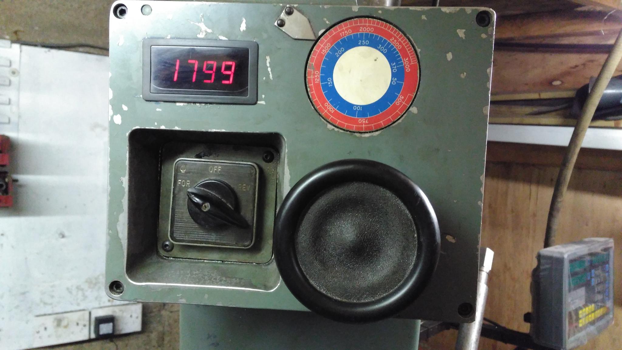

    Just installed a tachometer. And it looks like the speeds were out.Attachment 23738
    You'll probably find somebody has had it apart at some point, and not realigned the gauge correctly.
  3. #23
    I put paint marker on the rack before I started and put it back on where it came off. So it was probably wrong to start with.
    I was so giddy about the tach working I never thought about that.
    Thanks for your help m_c. Looks like I will have to separate it again.
