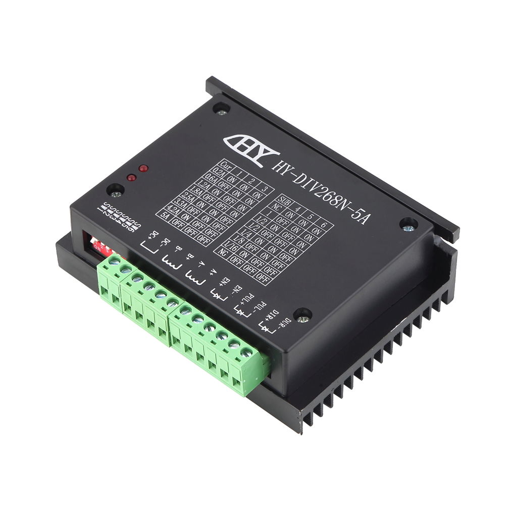

    I am in the process of reworking an older cnc machine which was used in a school environment, the stepper motors are HY200 2226 0470 ACM8 but I am having trouble finding information on the motors.
    I am using TB6600 0.2-5A Two Phase Hybrid Stepper Motor Driver from ebay and need to know the power and step to set the drivers up, any information would be welcomed and appreciated, thanks Paul
    ps should I just replace the motors with standard nema 23 or 34 4wire ones or are the ones above good enough to do the job?
    pps sorry also just looked and I know I should have posted this in the next forum under stepper motors, was rushing.

    http://www.probyte.fi/pdf/HY200-3424-0170.pdf
    (just search for HY200 2226 0470, the ACM8 just depicts shaft sizes/special features, and doesn't normally make any difference to the basic spec)
    That puts them at 4.7A coil, however you need to know how the motor coils are wired (are they 4,6, or 8 wires?) to know how to set the drive current.
    Steps wise, use 1/8th microstep setting, as it's a reasonable compromise.
    The motors won't be that great performance, but with those basic drivers, you probably won't get much of a performance improvement by changing them.
