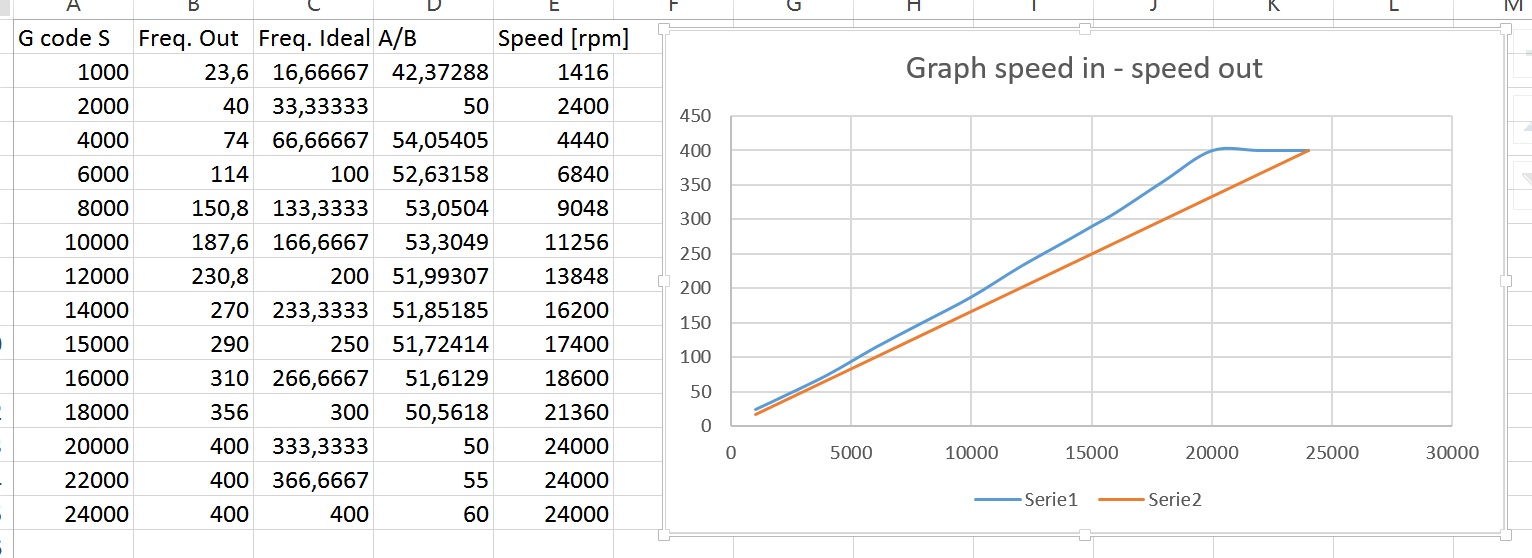

    The spindle speed is about 20% greater than the one set as shown in the following graph:
    s1000 -> 23.60
    s2000 -> 40
    s4000 -> 74
    s6000 -> 114
    s8000 -> 150.80
    S10000 -> 187.60
    S12000 -> 230.80
    S14000 -> 270
    S15000 -> 290
    S16000 -> 309.6-310
    S18000 -> 356
    S20000 -> 400
Name:	Graph speed in-out.jpg
    It should go to 400Hz when I set s24000 and not with s20000.

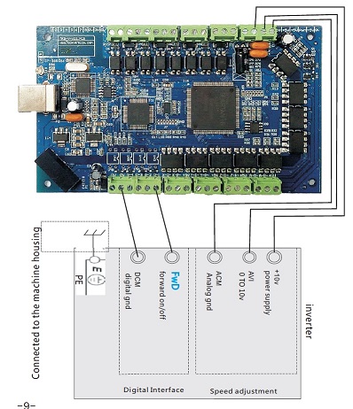

    I opened the controller and found that they connected the output of the inverter (Nowforever D100S2R2B) that is 12v to a board input (MKS-V-V02 www.cdxhctech.com) that instead expects10v, as shown in the following scheme.
    How can I solve the problem? Where to get 10v?

    You could build an amplifier circuit which gives a % of input voltage as output, and set it to give 10v Out for 12v In
    It's a fairly basic Op Amp project, the plans for which are easily found with a Google search,

    Maybe you could adjust these parameters, specifically "P0-024 max input corresponding frequency"
    But before changing anything, what are they set to now ?
    P0-021 AIN min input Setting range 0.00~10.00V
    Factory value:0.00V
    P0-022 AIN min input corresponding frequency Setting range 0.00~600.00Hz
    Factory value:0.00Hz
    P0-023 AIN max input Setting range 0.00~10.00V
    Factory value:10.00V
    P0-024 AIN max input corresponding frequency Setting range:0.00~600.00Hz
    Factory value:50.00Hz

    Okay, had a quick look at the data sheets for both the inverter and the controller. OP is quite correct - the controller expects to be supplied a 10V supply from (e.g.) inverter, and will presumably generate a 0-Vref for the spindle speed. What is needed is to reduce the 12V reference voltage to 10V. A simple way to do this would be to place 3 silicon diodes in series with the 12V output from the spindle.
    +12 -------->|------>|------>|------------- +10V In
    Diodes 1N4001, or similar would be good enough and cost pennies each.
    You could put a LM317 regulator inline - with 2V difference between Vin and Vout, it should manage well enough, but it's probably a sledgehammer to crack a nut.
    There is also a AO1 analogue output on the inverter, range 0-10V, but I can't figure out a way to use this to generate a constant 10V output.

    I would go for the diode solution as well. Even if you buy from Maplin, they're still cheap enough and it's a better solution than resistors. Tweak the calibration as also suggested here (if needed - give or take a few per cent, spindle speed isn't that important) and job's done.
    A fixed 2 Volt drop may be acceptable for the OP's requirements and that's an elegant solution if such is the case, I had Tunnel Vision on an output proportional to the input,
