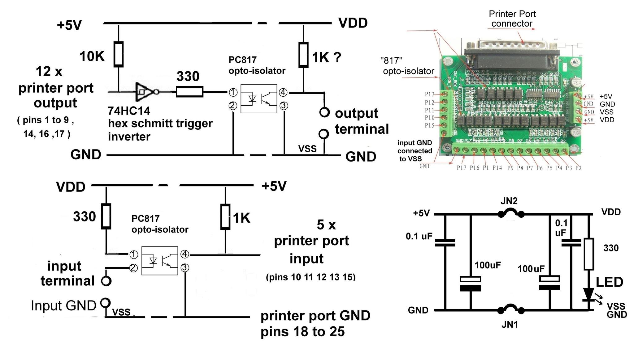

    I think I may have fried the bank of input pins on my BOB - it's one of the cheap Wantai boards that you get free when buying a set of drivers. I've found it to be a decent card and as such would like to replace it like for like.
    Having said that, it's a long shot that there's one available, so hit me up with what you've got in the way of simple parallel port, 3-axis, 12v boards...
    Are you sure it is 12V !! and not 5V
    Hehe. Yep, you're right, Clive..!
    (It's my switches that are running off 12v.)
    Sent from my HTC One M9 using Tapatalk
    the BOB requires a 5V supply if you fit jumpers JN1 & JN2
    or two 5V DC supplies if jumpers JN1 & JN2 are not fitted

    the circuit diagram is based on photos taken from the net !!

    I assume the limit switches have NPN open collector outputs
    with just the 5V power connected to the BOB you should have close to 5V
    between the opto-isolator IC pins 3 & 4
    when you connect the opto-isolator pin2 to the input ground with a wire link the voltage across pins 3 & 4 should drop to close to zero volts (0 to 0.7v)
    it should be easy to change and damaged "817" opto-isolators

    Cheers guys.
    Panic over for now - turns out it was my brain cells that were fried and not the input pins. The switch was behaving differently to how I expected it to - rather than take a closer look at what the switch was doing, I began a campaign of button mashing which lasted well into the night - not a great idea after a full day of assembling the bugger..!
    A clearer head this morning, a quick chat with Clive and a better look at what my switches were up to yielded better results..! (Oh, and restoring my back up .ini)
