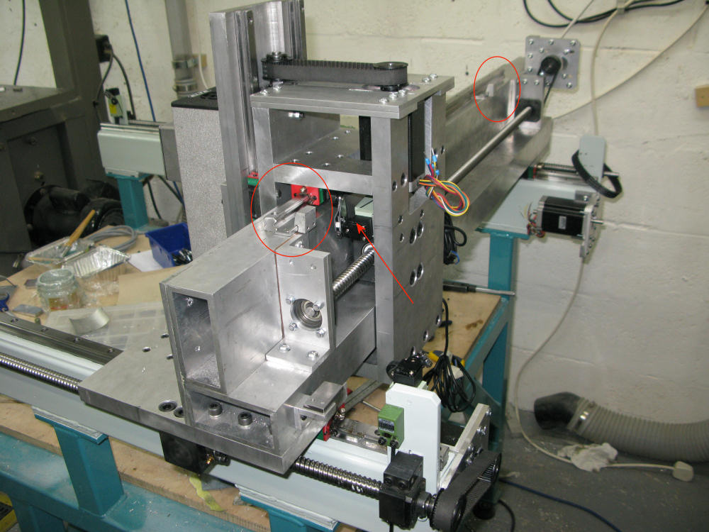

    You can mount a limit switch in the centre of travel then use an adjustable striker at each end.
    Picture shows central limit switch and adjustable striker at each end.

    Thank you for all your responses.
    Ill use three limti switches for homing and maybe a the extra 2 if i need them but ill try using soft limits and see how it goes.
